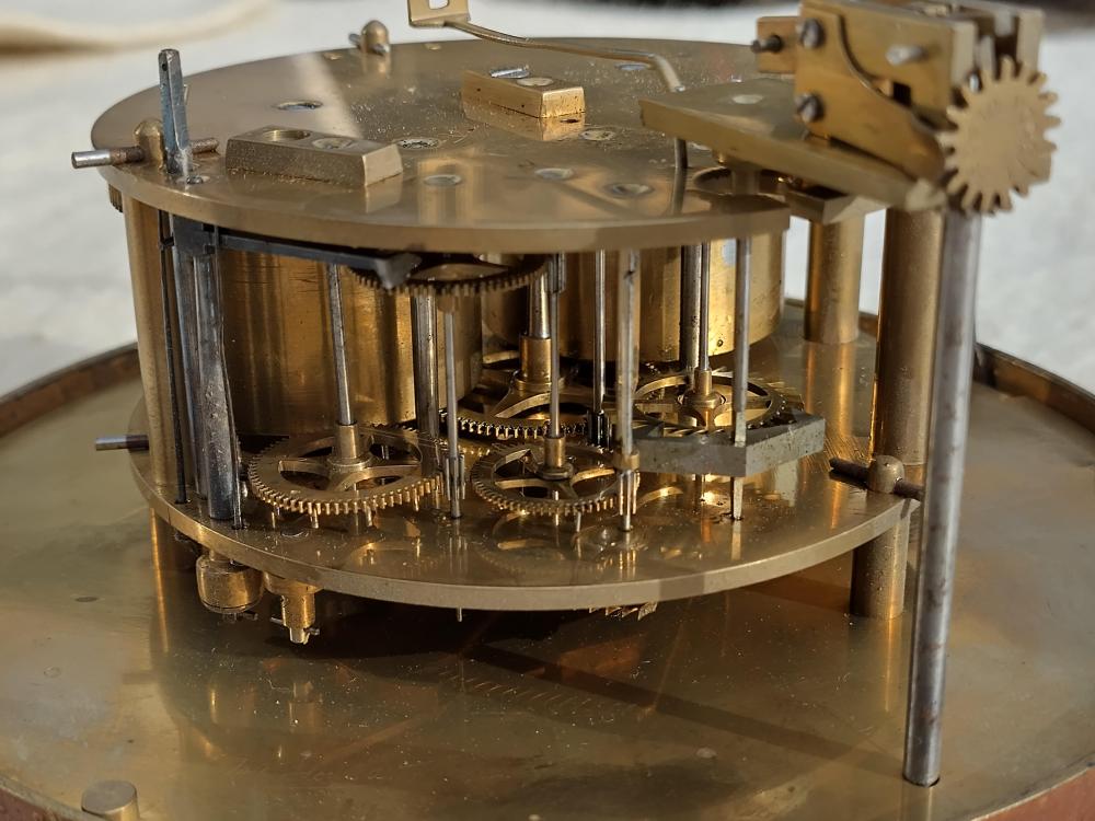

Hi *,
The mainspring of this clock was broken for the chime train, I agreed to replace it even though I stopped working on clocks before I actually could develop a knowledge regarding them and moved to watches as they are smaller the tools are smaller and cleaning them is not such a dirty job. (even though I like clocks better) I immediately noticed that there is a problem with one of the wheel, unfortunately its pivot is broken. How do I go about this? I understand I would need to drill a hole at least as deep as 3x the diameter of the pivot but as I never done this before and this is not my clock I would not really try it unless there is a good chance to succeed which I actually doubt. Could someone tell me what to do here, what video to watch, what book to read what are the major NONOs or anything you think is worth to say here? What is the hardness here? Is any kind of heat treatment involved? I have an unimat 3.

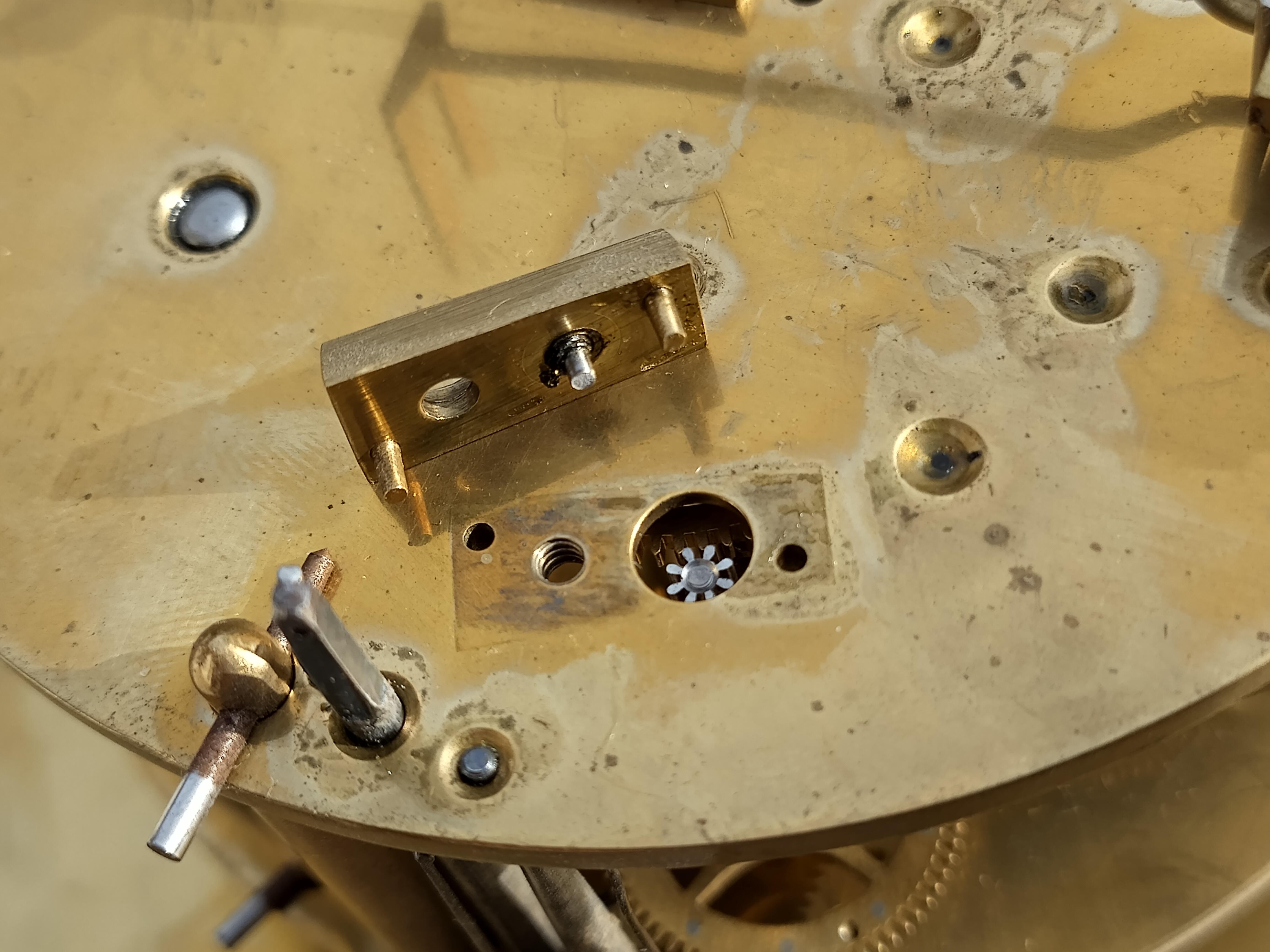

Are you sure it’s the pivot that’s broken off?  From the picture it looks like the end of the wheel arbour has sheared off.  If you gently remove the broken piece from the wheel bridge and show a picture, I’m expecting to see a broken piece of the arbour with the pivot itself still on the end of it.
If so then it’s not as simple as repivoting as there will be too much end shake on the resulting wheel arbour.  It would need the arbour repairing and a pivot turned to the end of it, or adding with some blue steel.
Edited by MikeEll

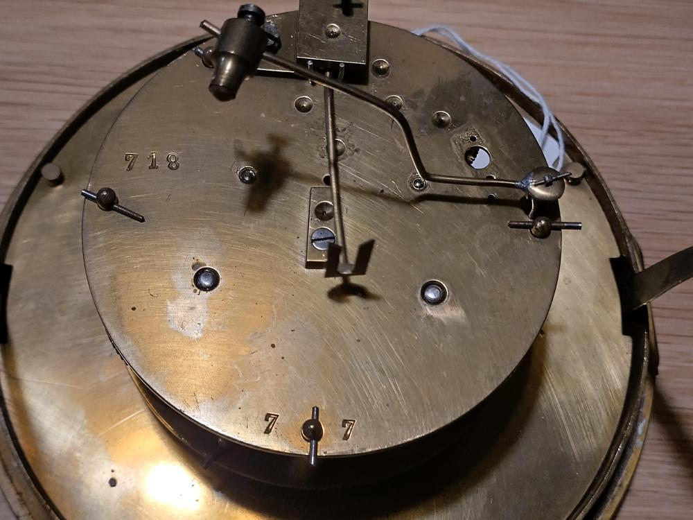

There are two ways to repair the clock. First depending on the maker obtain another hammer drive wheel complete.  Or. Re pivot the original, bearing in mind these pivots and pinions are as hard as glass. You would need to anneal the broken end then fir up in the lathe and drill the pinion fitting a new pivot ( friction) tight with either loctite or superglue. The new pivot will need hardening , burnishing and polishing. But it looks suspiciously as @MikeEll said that the top of the arbour has broken off leaving thr pivot and arbour stub in the cock.  How it manage£ this is anyone’s guess but it’s rather odd the arbour gave out before the pivot which is considerably weaker.  Is there a logo or stamp on the back plate.
I wasnt sure I left it in the green jelly in the cock. Clever you!

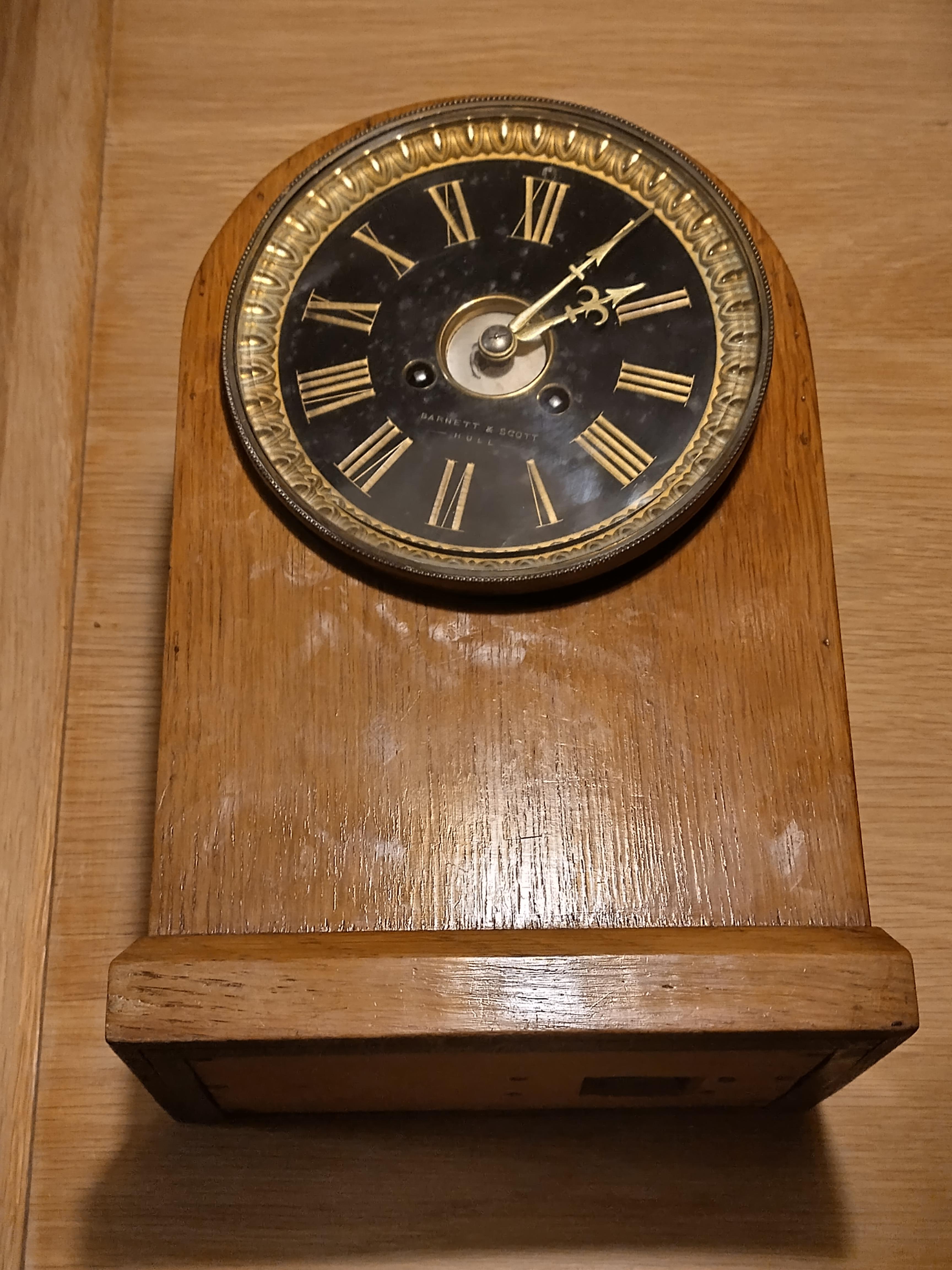

There us not much light for a good photo but I quickly placed the movement back temporarily in its case for a portrait.
Barnett & Scott - Hull
It is my bedtime so I'll add my view tomorrow. I will just say the movement is certainly French. Us old buggers need our sleep.

That is a bush so it has already been re-bushed and not very well. Yes the wheel is soldered. The green would be old oil or grease. The spring certainly can cause damage like that, it is more popular when springs break to cause damage teeth or even bend wheels out of shape.  The repair really is for someone who has plenty of experience and not for the faint hearted . You have been unlucky with this one my friend.

It seems like the shaft was weakened by a cut, probably this was the reason why it broke here.
Considering that the missing bit has the following parameters what would you suggest for the drill/hole size for the new bit?
I would suggest for the drill  use a size 58=1.07mm then turn the pivot to the size you need after fitting the part that way you can be certain that the pivot is concentric with the rest of the arbor.
Dell
Thanks, with this you answered my next question as when to turn the pivot, I assume it also helps to do the length/adjust the end shake with this as you cannot be 100% certain how deep exactly you can push the new bit down.
