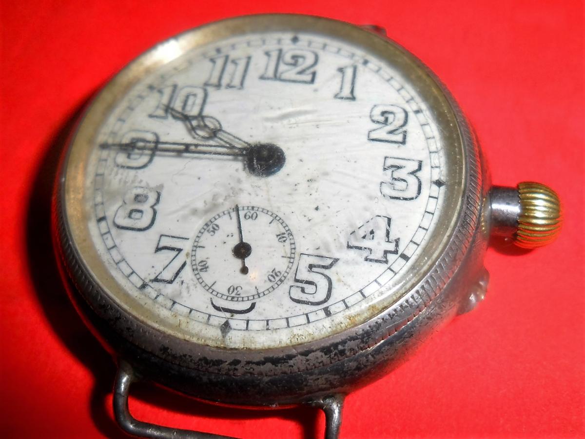

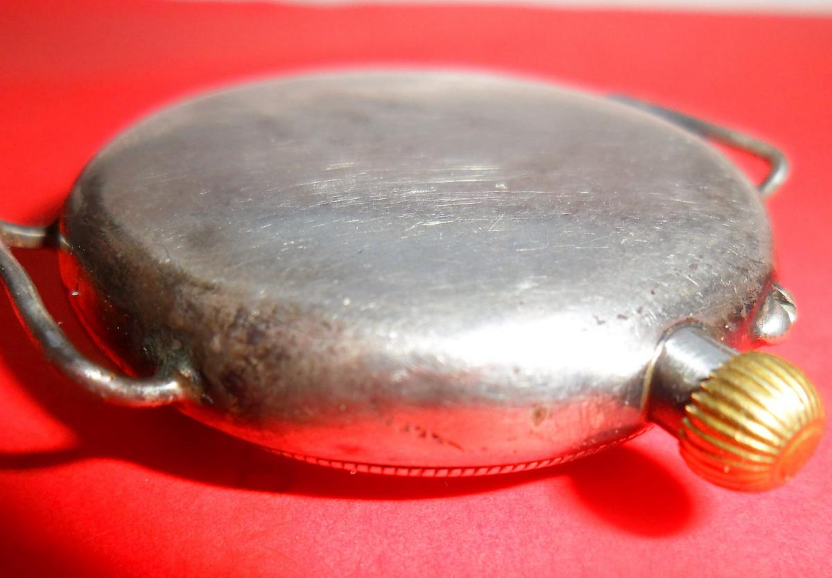

This item is in my "photograph and list" eBay pile as it runs (duration of wind and accuracy not tested) but I cannot access the mechanism in order to photograph it.
The more I look at this beggar, the more I want to know about it.
The case seems built around the mechanism but I know this can't be the case.  I cannot access anything like a winder-release but it is patently obvious the winder must be removed in order to remove the workings.  Can anyone help?
Also, the case has tarnished just as silver would but (obv.) any hallmark would be on the inside.  In case of never being able to see the inside, how do I confirm it is silver?
In case opening the item is beyond me, does anyone recognise this watch, or have any related info they might share?  This watch is SO frustrating that I may just clean it (if I can get at it), polish it (once I've learned how) and use it as my collection-start-piece!  If so, an old-style, leather strap, yes?
Thanking all in advance!
Peter

Pics of the caseback and the caseback edges in high clarity will be the only way for us to assist you.
It's a converted pocket watch, so highly likely that there is a snap back cover on the back of the case, and also another dust cover below that.
These can usually be opened with a finger nail, but older watches may need a case knife or heavy razor blade to tempt them.

Thanks Jim, I'll post a back-pick when at home after work.
However, I can't see anything even like a seam around the reverse.  A closer look and picks later ;-)
I think you may find if you gently ease out of the case by gently prying upwards at the 9 o'clock position, but not on the enamel dial or it will chip. The movement should come away leaving the winding stem (square drive) and the setting pin still in the case.
DONT FORCE ANYTHING!

You don't see a hinge anywhere inside the case, correct ?
Glad to brighten your lunch-hour!
Nope, no hinge:  Just the glass that pops-off and allows acces to the face.  I'm thinking the only way into the mechanism is through removing hands and face...  This is not happening as it runs, keeps good time and currently has an owner with sausage fingers and little experience!
Removing hands is possible, but I'm not so sure about the face... it's often attached to the movement by some contraption (screws) that are accessible through the back of the movement... back to your catch 22 :)
You have a Borgel cased watch - could be quite valuable, see :
http://www.vintagewatchstraps.com/borgel.php
Normally the bezel and crystal are fixed to the movement ring and the whole assembly : bezel plus movement ring plus movement is removed by pulling out the crown and unscrewing this assembly. The link above will make this clearer.
In your watch the bezel has come away from the movement ring and so you must try to gently turn the movement plus its ring by using a soft pad after removing the hands. Remember to pull out the crown otherwise the movement is locked. by the half stem.
If the little pin that locates the bezel is still in place you can replace the bezel and use that for turning the assembly.
