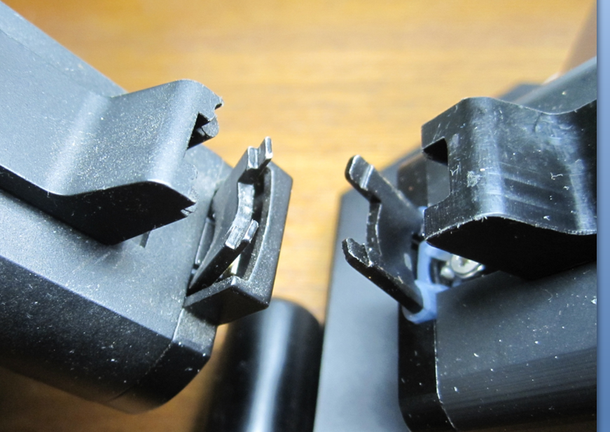

one of the problems the Chinese have when cloning items is failure to grasp exactly what they're trying to achieve. So for instance on the left-hand side is a witschi microphone and on the right-hand side is the Chinese. They look very similar but the witschi has a much more defined edge for holding the watch movement.
then there is some other interesting problems like what's the largest size watch you can hold. The witschi microphone in the example below is holding a 36 size Hamilton deck watch just fine. Then on the right-hand side Chinese microphone holding a 16 size pocket watch in its case. Other minor little issues like the witschi has a constant force holding so whether you barely open under all the way to end the amount of force is not the same as the Chinese which is just a simple spring. On the other hand the witschi microphone is to be purchased separately like the last time I looked the microphone alone is about $1000.
Oh and because I was curious I grabbed in 18 size plate and yes the Chinese microphone will hold it. Although I was very cautious because yes the spring is practically at the end of its stretching but still I was able to put it in and it was holding.
