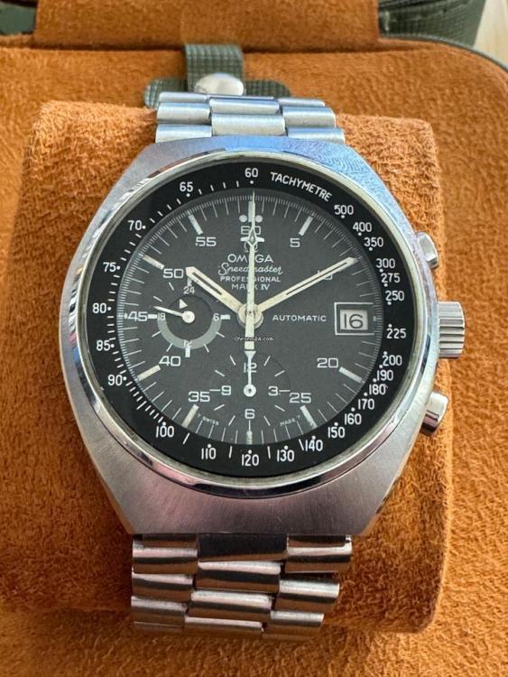

I’m now at a loss for how to properly recreate the painted crystal. I’d love to know how original painted crystals like those on the Seiko 7009-316A are manufactured. For example, similar designs can be seen on the Omega Speedmaster Mark IV, which has a tachymeter painted on the crystal.

1 minute ago, tomh207 said:
I would think that pad printing would be used for this
Tom
And do you know someone or a company that could do it for me ? I already have the design and the crystal without any paint on it.
I don’t know where in the world you are and pretty much any dial restoration company would be able to do it. Something that may be worth checking is if you have a local company which personalises pens etc. for promotions, same process. I would expect the cliche engraving/etching to be somewhere around $100 then the printing cost.
