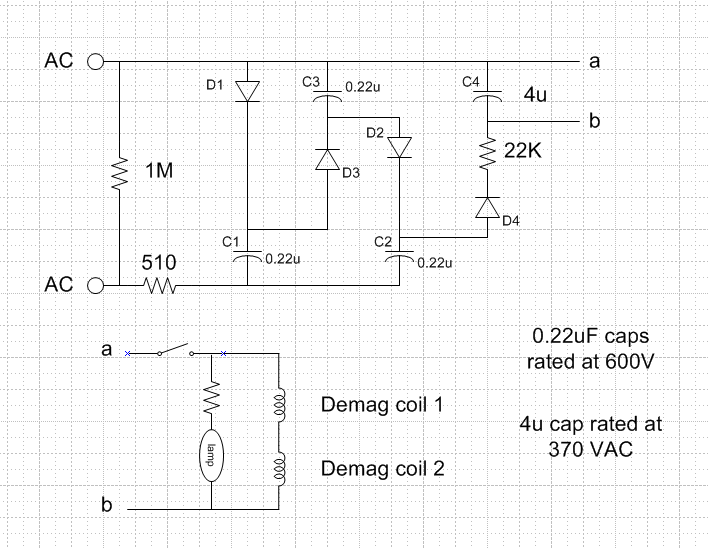

Most demagnetizer circuits I've seen convert mains AC to DC and charge up a large value capacitor. It may or may not have a voltage doubler.
The switch disconnects the capacitor from the mains and connects the capacitor to the coil. The inductor/capacitor circuit ossilates and decays naturally.
So, the switch is definitely connected to high voltage.
I don't think there is any low voltage circuitry in this contraption.

I read the whole thread. Here are some thoughts.
Most (if not all) of the good demagnetizers operate on the same principle using the Villard cascade voltage multiplier.  I have serviced three or four--all branded "Vigor."  In every case the 4uF capacitor had died.  Will explain later. Comments below are all based on the Vigor.
- there is no low voltage anywhere in the circuit
- the push button is plastic mounted in a metal housing but I believe the metal is isolated (I will check later).
- the push button is connected to the highest voltage in the circuit.
- the transformer is not wired as a transformer and is simply used as a BFI (big freaking inductor).
- the Vigor is not powered using a three-wire cord with the third wire being earth ground.  I have no expertise in the regulatory stuff associated with "double insulated" etc. (I am a semiconductor guy...most of my life has been spent at 10V and below!!).  But, I don't think the Vigor meets the double-insulated requirements--my guess.
The units I have serviced, were completely rebuilt except for the inductor, switch, and neon bulb.  In all cases the 4uF cap had gone bad.  The reason is that the unit is continuously plugged and and you have the full rated voltage across the cap for the entire time.  Stress eventually wins the day.  Therefore, for all my rebuilds, I put an inline switch on the power cord.
