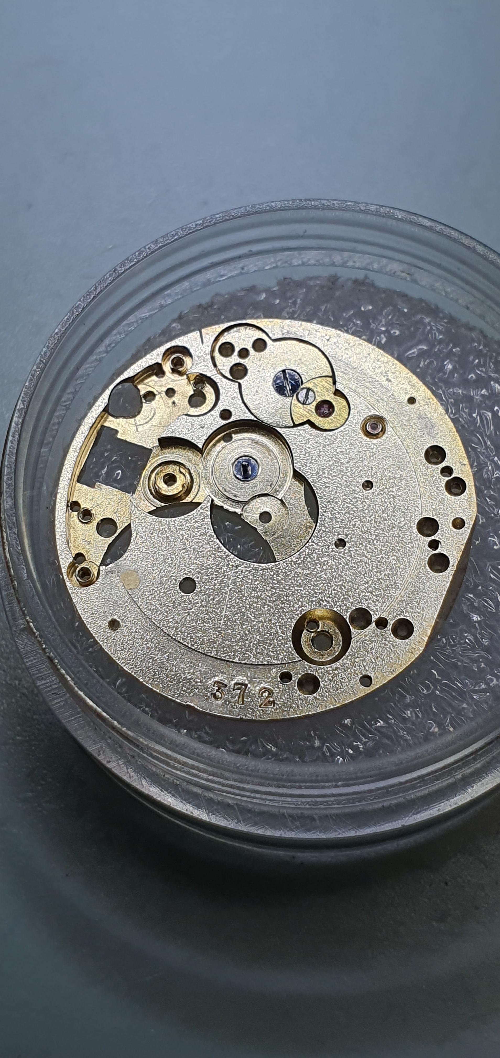

Small 25mm cylinder movement without any identification info on the mainplate or bridges. Balance is original to the movement. The strange thing is that altering the length of the hairspring by changing the position of the timing pins does hardly improve the rate (from full retard to full advance), it still looses time about 120s/d.

I meant the new balance has the same specifications and dimensions in comparison with the old one from whom the pivots were broken. The only number on the mainplate 372, no other numbers or characters visible.

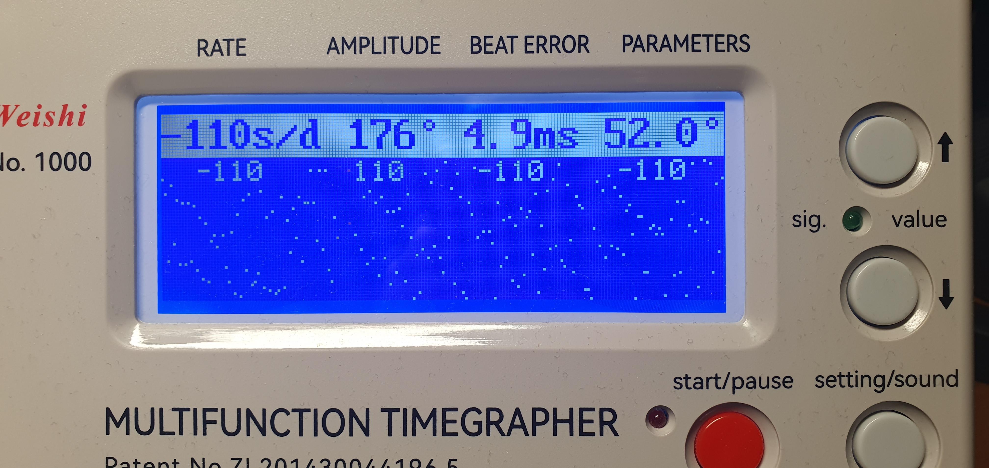

Timegrapher only shows the rate, amplitude and beat error are not shown (remain at 0.0).
If you're not getting an amplitude then I suggest you have a look at your timegrapher as it should be showing something unless the amplitude is so low it can register it.

The timegrapher showed the amplitude after a long time measuring, see picture below: 176. It seems too low, so I will fit a new stronger mainspring. I also noticed that the pocket watch (ligne 11 1/16) keeps time only is the mainspring is fully wound, which could imply that a partly unwound mainspring becomes too weak to empower the wheel train and scape wheel for the correct impulses.
I hadn't realised it was a cylinder movement and as others have mentioned you may not get a good reading on the timegrapher.
Looking at the snowstorm you've got on the display I think you need to have another look through the movement before doing anything with the mainspring.
The wheel train moves freely after a small turn of the winding stem, so no friction there. The barrel sits well in its bearings without any side play.
As it is a cylinder escapement, the readings on the timegrapher will not show straight lines because of the noice of the movement produced during the friction time of the escape teeth on the cylinder outer and inner wall. The only two straightforward sounds are the moments that a escaspe tooth touches the outer and innner cylinder wall.

It was a non runner. The original balance had broken pivots and a badly damaged hairspring. After a long time measuring the timegrapher showed also the amplitude (176 degrees) and scattered pattern which, I assume, is to be expected for a cylinder escapement movement.
Hi. That movement was built before timegrapher came into use. As you say there are only two sources of noise the action on the outer ans inner walls of the cylinder. Put the dial and hands on and check its time keeping ability.
typically on a timing machine when the graphical display looks like snow globe affect in other words you cannot see anything resembling lines the numbers typically are not correct. In the case of a cylinder versus a lever escapement with the sounds are totally different it is impossible for the timing machine to do the amplitude.

OP, forget about the timegrapher. It is useless here. Put the hands on and check the watch after some time. Rate error in cylinders is several minutes/day and rate has fluctuations of several minutes/day. Did You lubricate the cylinder/cylinder wheel teeth? Lubrication is important and it can change significantly the rate. The hairspring usually is very thin and long ( has many coils) and that's why the regulator doesn't change the rate much. The amplitude can not be more than 180 (there is limiting pin on the balance rim) and 120 is very good amplitude, about 90 is the minimum acceptable. Observre the limiting pin, thus You will see what amplitude is.

Observing the amplitude of the limiting pin on the balance wheel: it is about 90 max and only at a full wind of the mainspring.
