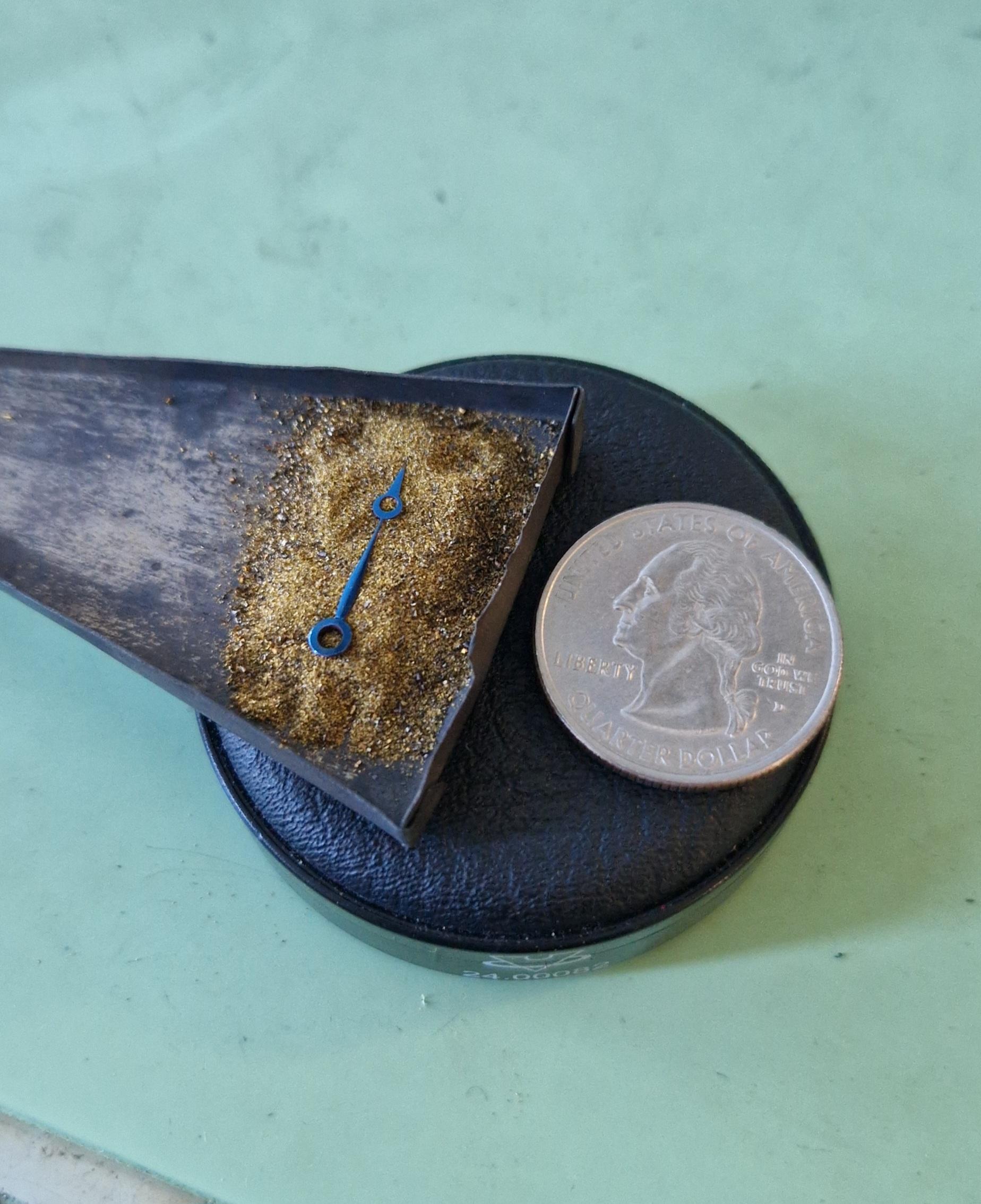

I have been up to more mischief refinishing and bluing pocket watch hands again. This time though, a Breguet moon minutes hand with a slender shaft is causing me a fair bit of difficulty. I keep overshooting the color I want in an instant because it heats up so quickly over a gas burner. It goes from barely a pale straw yellow to gunmetal with almost no period of blue in between and I'm getting frustrated polishing it 4 times over to reattempt the heat treatment. It is quite different from broader hands I've done successfully, where each color stage arrives gradually.
I decided to try it over a spirit lamp as some of the old books describe, so that I could control it over a longer heating period. I am using denatured alcohol as fuel and bluing over fine brass shavings in a thin aluminum mini pie pan. I am unable to get to any color change over the alcohol burner, it does not seem to get hot enough at all in a bed of brass or placing hands directly on the aluminum pan.
Does anyone have experience bluing hands over a spirit lamp? What fuel worked for you?
I am sure I can find other heating sources around my home that work more suitably than natural gas, but I am mostly just curious if it can be done using the spirit lamp, and how old timers did it.

A thermostatic hot plate?  Very non traditional. How big is the pan ? The heat might be dissipating too quickly from the focused area, I used a small  brass clock mainspring barrel.

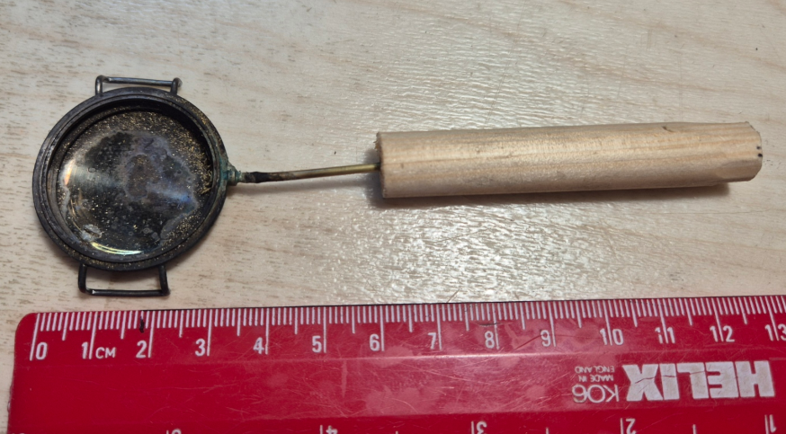

In the UK we have a fuel for spirit lamps, camping stoves etc called methylated spirits, which is denatured alcohol. I use the same set up as you - fine brass shavings in an old watch case I attached a handle to. I have had no problems in bluing hands. The temperature of a spirit lamp flame is about 1000°C.
It's about 12cm, and thin aluminum so yes fast dissipation is strong possibility. I've been trying to find something brass but have nothing around the house.
Now there's an idea I had not though of. I have a pile of poor quality brass pocket watch cases I will never use for anything else. The size would be right and thick brass rather than thin aluminum.

This is what I use, an old watch back about 3cm.
The flame feels much hotter than a candle.

For a watch hand, to get the most even color, you want to heat it very slowly. Like take a good 5-7 minutes or more to come up to color. A pan with a handle makes it easy to distance it from the flame to allow the color to develop gradually. Taking time like this will let the color equalize nicely; a typical problem with a hand is getting too much color quickly on thin areas, while thicker ones lag behind, and when they've caught up, the thin areas are too light. Playing the pan over the flame even once certain areas are a deep blue lets the others catch up while not overheating the already-done areas. Letting the blue develop over time also seems to make a more robust (thicker?) oxide layer.
You'll have to do a few to get the knack with your pan and lamp. The next most important thing is cleanliness. I take already clean hands, lay them on a clean piece of paper, and rub over them with freshly cut pithwood wetted with benzine (lighter fluid is fine). 99% iso alcohol is good too. Blow off any stray bits of pith with a blower (not your breath!!).
If you have fresh brass filings, heat them in the pan for some time before use. This will burn off any contaminants, you will almost certainly see some smoke, and you don't want that happening when going for an aesthetic blue.

So I narrowed to two issues.
First: My lamp's wick was generally too low, which I had done to keep it from burning up too quickly. Exposing more wick and fraying it more gave me a larger, bluer flame. Though the larger flame is short lived because the cotton wick does burn away quickly.
That flame is far above the temperature needed for bluing. I could blue directly on the open flame in seconds, and also reach red hot almost instantly on smaller pieces.
Second: My 12cm aluminum pie pan was acting as a heat sink. On only the thinnest test hands I could achieve an uneven bluing if I omitted the brass shavings and left them in direct contact with the aluminum. Even still that would not work for larger, thicker hands. So I sacrificed my little pie pan with some tin snips to produce this jagged little cup about 5cm across.
In here I could blue small thin hands over the brass bits, very slowly and only after I reduced the brass by 3/4. But large ones still can't get past a brown color to the purples. This is a big one, about 18 size. To get this color I had to heat it on a small square of aluminum. Even against the bare metal cup right on top of the flame it could not go past brown. My test hands come from a big ol' assortment I have of old stamped steel unfinished, unblued hands. I cleaned them in 99% IPA but did no polishing. This isn't meant to look nice, just experimentation. I can do a lot better.
Lesson I think I have learned: Aluminum is pretty unsuitable as a bluing pan over a spirit lamp. It works fine over a more aggressive heat source like a natural gas burner, but it loses heat much too fast to be very effective. My brass shavings (from ebay, I have no lathe to be producing my own) - are clearly much coarser than @nickelsilver's

I made a small bluing pan out of some brass stock that I turned into what looks like a mainspring barrel, and filled it with brass shavings.
I pulled the hinged caseback off a cheap 1970s pocket watch and blued some hands in it this evening. It worked fine, but still took way to long to reach temperature over the alcohol lamp, >10min. Once heated, it was at least able to consistently keep on bluing without needing to reheat a lot. I thought it was brass, but whatever the base metal actually was began to get a little bubbly and melty. Surprising. Not a good choice for repeated use. I still need to go with a smaller pan or use natural gas instead of the old-school lamp.

I have my working solution. This started out as a 2 way liquor shot pour with 0.75oz and 1.5oz stainless cups pointing different ways. It hasn't been used for its intended purpose in decades. I was able to snap the larger cup off at its weld and then cut down the smaller cup with a Dremel cut off wheel. I did a haphazard effort at filing the sharp edges away and tested it out. That plastic rim at the top of the handle might melt if I left it in the flame, but the pan heats so quickly I don't think that will be an issue.
It turns out that cheap modern pocket watch caseback I was using yesterday is made of something like zinc, brittle and powdery. Also explains why it was bubbling after 10min over the flame.
This one took only about a minute to heat up to a working temperature over the alcohol burner, the handle does not get hot. And some random parts from a watchmaker junk drawer lot blued in under a minute. That wheel, looks like maybe it was from a verge escapement? It looks beautiful.
