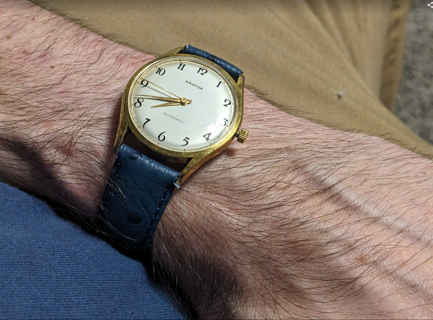

The watch that at the same got me back into watches that i never have worn. Belonged to my late grandfather who was a **BLEEP** so it had no sentimental value to me. When i got it my mom got it "professionally serviced" (Stay tuned for more on that lol.) and gave it to me. It's gold, very grandpa looking and sat in a drawer for 20 years while i bought a bunch of seikos i actually wanted to wear. Then I saw a pic of a similar gold watch on a blue strap and it looked quite attractive. I got one.
Yup. I can wear this! Ariston was the department store brand of an old Chicago department store. Was probably a nice watch at the time but not TOO nice. Let's get it serviced!

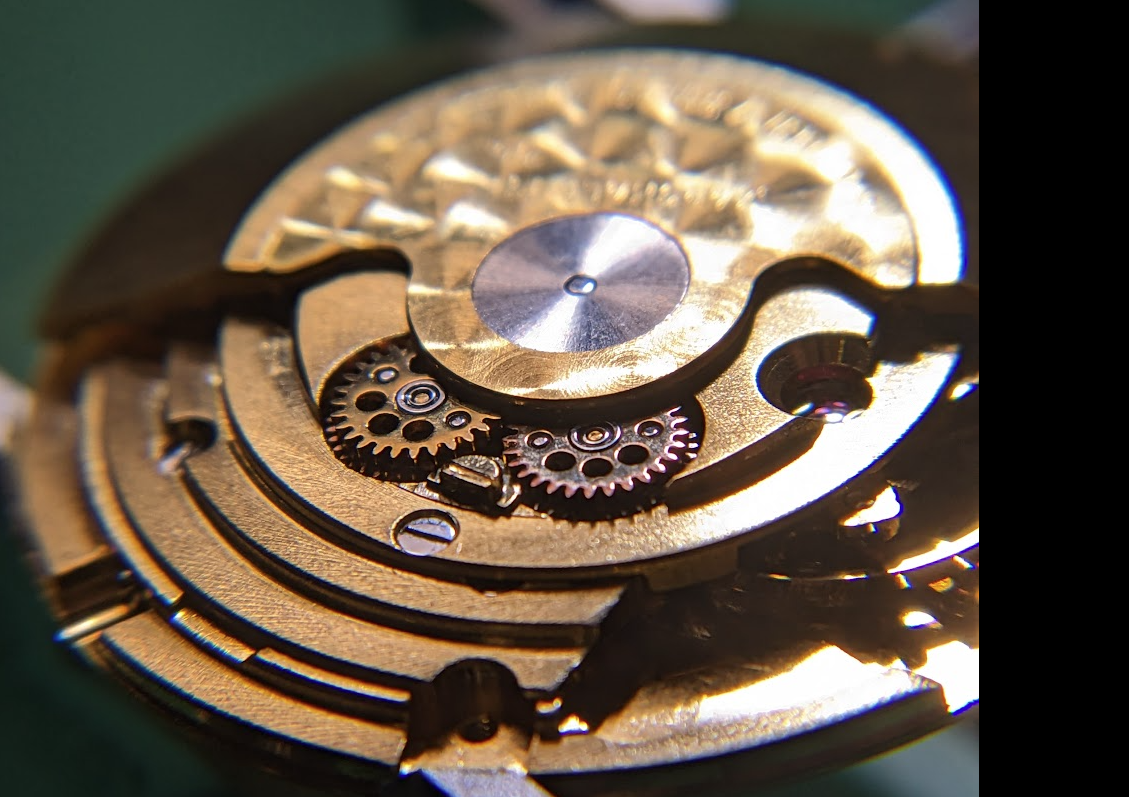

Open it up and it's far prettier than any example of this old movement i can find on the web. Looks to be in great shape too! But is it? (Yes.)

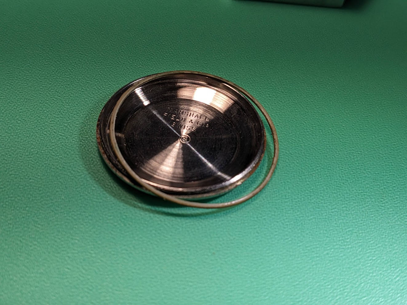

Oof. Professionally serviced and there's no crown or caseback gasket in it?! Thank god i didn't wear it. I'd probably have gotten it wet and had no idea it wasn't water resistant anymore like the caseback says. Also bent crown post. Probably have to source a crown but i'm hoping i can take the stem out and just bend/nudge it back straight. Does't look like it would be too hard. Worth a shot if i have to replace it anyways.
Turned the thing over to drop it out of the case and a bunch of dark powder and some shards of metal fell out...not good. Took automatic works off...so far so good.

Why is there a swimming pool of grease under the pallet fork cock all around the keyless works?! SO much grease! The jewel and escapement oiling appears to be impeccable. Did he drop a pizza on this thing halfway through assembly?!

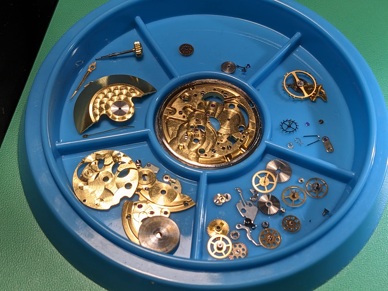

Disassembly is done other than the barrel. Real happy to say there's not a speck of rust, not a single slipmark from tweezers or screwdrivers, mine or otherwise. THis movement appears to be in mint condition. I'm not sure what that debris was that fell out of it, all the oil is still wet, there's no rust. I suspect it was gilding or some corrosion from the brass that wears through the thick gold filling of the case. I have no idea what that was. Beautifully taken care of. What a relief. I dont' want to cock this up or have any surprises as i know it was running just fine a couple years ago despite being serviced 18 years prior.

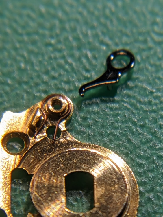

In fact i didn't even get a chance to see how the click spring assembly even sits as the moment i removed that screw the hidden spring popped the whole thing up. Thank god i didn't lose it.
Okay as somebody totally unfamiliar with old swiss stuff does this look normal to you guys? So theoretically this thing was serviced by a professional of dubious qualifications 20 years ago, sat in a drawer ever since and so I figured the barrel should be serviced and the new mainspring i would hope he'd have put in there would probably be usable (I have a new one anyways ready to go.) but i'm not really sure what i'm looking at here.
There's no bridle to speak of on the mainspring, it's just folded over at the end.
Inside the barrel is a second part. I've never seen anything like this but that folded over part clearly hooks onto it.  I have a brand new GR mainspring for this movement ready to go if i have to replace the mainspring. Is this an integral part or is this something strange the previous watchmaker did?
 It looks like the bridle is just a separate part of the spring itself. If the new one i have has it's own bridle i'm wondering if i even need this part.
Edited by Birbdad
 Attached slipping bridles can break as you remove or install the spring manually, a pain one doesn't have with detached slipping bridle.
I always go with detached bridles, is there any technical down fall to using detached slipping bridle?

Got everything nice and clean.
Serviced the barrel wall with a ring of 2813 and got the new mainspring installed. According to GR and every database the correct mainspring is the GR 3271X
By sheer luck I had the correct winder and arbor for this which is a right hand #6 despite the fact i've never worked on a right hand mainspring'd watch. Yet another thing that has been so nice working on swiss is that since their mainsprings aren't so damn short, it was actually the same height as the wall of the winder, and it made getting the arbor out without it unraveling a breeze compared to seiko.
Got the barrel serviced.
I'm ordering a new crown and caseback gasket. I didn't think there was a caseback gasket on this thing but there actually is, it just was so glued to the caseback and appears to either be white plastic that blended in with the steel or is so old it's turned light grey and into plastic. Iv'e never seen a gasket like this before. I"m assuming a normal rubber one will work.
one of my amusements where I work is we change batteries. If the watch indicates any form of water resistance the price goes up. Then a course anything with an expensive name in other words for liability reasons the price goes up. Everything that indicates water resistance is placed in one of the dry testers to verify incoming watches actually are still water resistant. If they're not the customers notified and as part of the battery change if they can change the gasket or lubricate the crown whatever they will attempt to restore it back to water resistance. and yes they spend a fair amount of time restoring watches back to be in water resistant. But a lot of customers or some customers object the price and could care less that whoever else changes the battery probably isn't going to care if their watches water resistant or not because what's the likelihood you're going to wash your hands or get your watch exposed to water etc. Then unfortunately a lot of watch repair shops don't have the capability of checking watches as to whether they're still water resistant or not that was not part of the original service.
Then service bulletins? the unfortunate reality is there only typically scanned for the parts. Material houses needed to build identify the parts they did not need to know how to service the watch. So for instance searching this computer we get a parts list which I'm attaching. But when I look at the parts list I do have to wonder if there was servicing for this watch just never got scanned?

Well i did manage to find some gaskets for it, i had to get a gasket that's technically too small for the case back and i had to look EVERYWHERE for a waterproof crown that was even close to the original. I wonder if the guy just had nothing on hand that would fit this weird case and gave up.
if I think back in my early days of working in a variety of watch shops to be quite honest I don't ever remember being concerned about watches being water resistant. because the only way we had for testing that sort of thing was the water tester and I just don't ever remember using it at all. Nowadays with those dry testers it's so easy to check the watch five is dry testers are really expensive so how many people would have one of them anyway?
So I suspect in the past a lot of people probably didn't worry about it or didn't worry very much at all. But a bag could be wrong about that
oh and if you're curious about modern testing I'm attaching a PDF.
8642_WI_22_Ewater resistance testing cousins.pdf

Weird very fiddly construction with the setting lever. you have to screw it in from the backside. I'm sure there's a better way to do it than what i did which was just luck. I had to hold the movement sideways and get the screw to just the right depth and through trial and error i got it to finally thread without pushing the setting lever out of place. You gotta do this before putting the setting lever spring in.
Bleh, warning. The screw that goes into that annoying setting lever goes UNDER the barrel bridge. It didn't look like there was room for it so i assumed it went on top of it, which actually worked but then i was confused why i couldn't get the stem out. I unscrewed it a little too much and lost the setting lever.
Annoying design but i do appreciate having a separate bridge for the barrel as i didn't compromise my oiling on the rest of the train like i would have with a seiko when i had to remove the bridge barrel to get to the setting lever.
Putting together the automatic works. I got no frame of reference for lubrication so just using my head. Doing the center posts with hp1300 and a tiny dot of molykote on the areas where i can clearly see the wheels make contact with other metal parts.
So i had no idea what to do with the reverer wheels. PUt a little hp1300 on the posts they go around. After doing a little research there's a special lube for them called lubeta, which was surprisingly cheap so i ordered some but i want to wear the thing now.
Apparently this is the lubrication point if you don't use lubeta. So i hit it with a tiny bit of 9010 and when the other stuff arrives ill clean and use that.
Now, gonna put the dial and hands on and get it back together and get it on the wrist finally!
Aand pretty much done. I"ll shorten the stem tomorrow. I'm assuming stems for these are still readily available cuz this was the closest to a crown match i could get and it's clearly too long.
