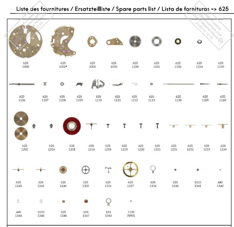

So I did this a little bit different I looked up Omega 620 and wind up with two separate balance staffs? Then if I look at the reference for 625 balance staffs once again there's two of them but I suspect they're probably identical even though the listing below says there are different? But in real life there supposed to be one staff the reason for this is an off to go to the best fit online would be the 100 number would be the generic best fit and the 723 number would be for Omega original. But they both should be identical. The problem sometimes with aftermarket balance staffs are they may not actually be identical. This is why when replacing balance staffs you need to use a micrometer and measure the old versus new preferably before you start to assemble and then discover there's a discrepancy.
OME 620 100/2238 STAFF/OME 620 BESTFIT BALANCE STAFF
OME 620 723/926 1321/OME 630 GENUINE BALANCE STAFF
Okay I'm having a confusion? Currently I'm on the best fit site and I wonder verifies of staffs you really do cross reference here and they don't? Okay let me look up the 625 parts Okay this is weird for the 625 parts there are no balance staffs listed at all not a generic or an original?
Okay let's look up cross references the parts such as 100/2238 Now we have an interesting problem I'll just copy and paste
Not expect anything different but let's look up the other reference number
Tech sheets can be fun can't they? So the initial 620/625 tech sheets and looking as it does not reveal anything of use and I did not see a balance staff at all. But further searching in the computer revealed a new verse 625 tech sheets with an interesting paragraph
Man I found I have a much much newer 625 parts list one that of course every single corner is watermarked so not that I give it to you but it does confirm that for the most part all the parts are unique to the 625 and of course there is no balance staff but there is a roller with the interesting part number
So it does look like the roller table interchanges with the 620 but as we don't have a balance staff number and nothing else is now confirming?
I thought I'd look in the bestfit physical book itself but it only shows the 620 because the 625 is after the books were printed. I am guessing that somebody made an assumption that the 625 is more or less identical to the sixth 20 and didn't read the one technical sheet that I quoted up above where the most part it is not. It's one of the problems of the technical reference material where this stuff was readily available into the 70s and then when the watch companies got well hate us all the amount of technical information available to us dramatically shrinks.

723/926   STAFF, INCABLOC   1321/OME 620
http://cgi.julesborel.com/cgi-bin/matcgi2?ref=[^]D`FY
100/2238  STAFF, INCABLOC
http://cgi.julesborel.com/cgi-bin/matcgi2?ref=U\ZDYFVM

Welcome back @JohnR725, I've been awaiting your response. I thought that with your access to Omega documents you would clear it all up 🤣
I've never been so baffled before with a movement. The Incabloc document lists different hole sizes, so the staffs must be different (?)
Yet Cousins do list a part
Out of curiosity why did you need to change the balance staff?
Because the bottom pivot was broken. How you do that with Incabloc, I don't know.
I've just about given up on understanding the balance staff situation, so I will just find a donor movement.
I do have a spare 625 movement, in very good condition complete with nice dial and hands. I've been waiting years to find a nice case for it. I don't want to strip it for parts, so will look for another cheap movement.

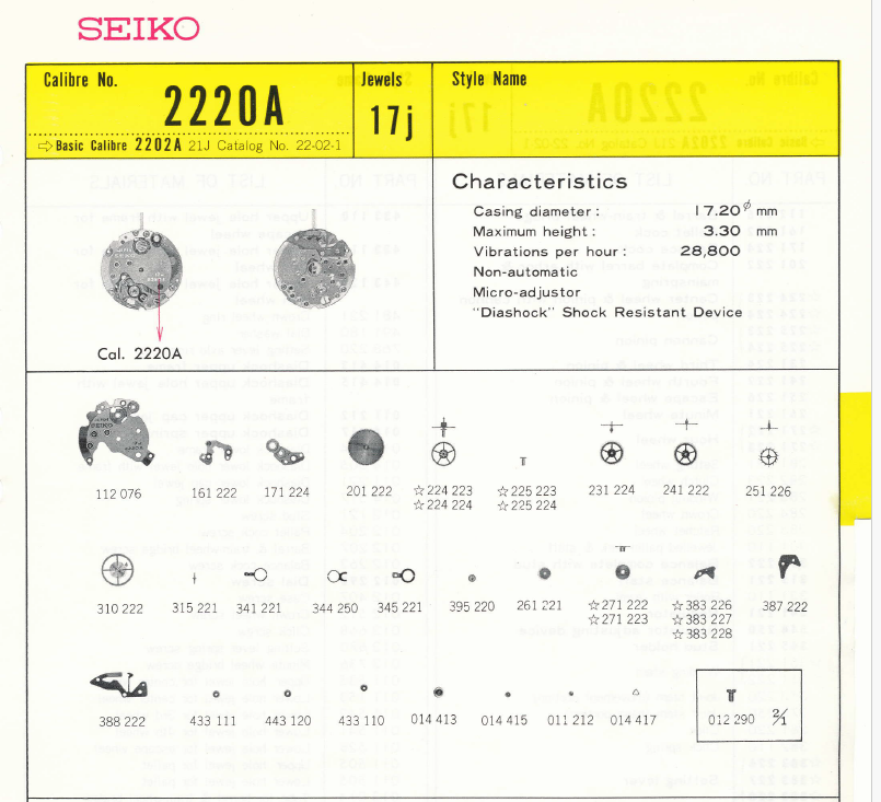

620 is not the base calibre for the 625 as shown by @JohnR725 as this is a completely independent movement.
A base calibre is one that is then modified to create a new calibre as an example shown below.
The base calibre here is the 2202A which is then modified with the parts shown to create the 2220A
If you look at my post above where I show the parts list, the only parts common between 620 and 625 are the stems, and a couple of screws.
My post was in response to Nucejoe

I'm planning to buy a donor movement.  But ......
As I have spare 620 and 625 movements, I thought I'd compare the staffs. The 625 is a running movement, the 620 has no hairspring but the balance us good.
I measured them both as about 2.19mm length.
This is from a cal 620 (no hairspring). The staff I fitted to the 625 balance looks just like this.
This is from a running cal 625, there appears to be more staff below the roller.
So is it just the roller that's different between the 620 & 625?
Edit
Found these rollers on eBay and although not very good photos it looks to me like the 625 has a recess so sits further onto the seat?
620
625
Edited by AndyGSi

It looks like the only thing as far as the parts list is going to show is the roller table and the stem. The weird aspect is the parts list for 620 lists a staff and for the 625 it does not? I wonder if with all the exciting new changes that?
One of the minor annoyances with watch companies are if you look at older technical documentation oftentimes you'll see all kinds interesting parts that have been dropped off later tech sheets because they do not expect you to for instance replace a balance staff hence the reason it's not listed here supposed to purchase a balance complete.

Dr ranfft calls 620, 625, 630 and 635  a family,
Wonder if the doctor ever made a mistake? Then the definition a family could be interesting like their all physically the same size and that's what makes them a family.
I'm attaching a whole bunch of PDFs of parts listings and one technical document the 625.
If you look at all the parts lists you actually find two separate base calibers. The base caliber only list itself and the caliber that's based upon the base will reference the base caliber for all the parts not covered in the parts list. So in other words the movement based on a base caliber will only show us the secondary parts.
So for instance the 630 is based on the 620
Then the 635 is based on the 625.
Omega 635_1_2101.pdf Omega 630_complet_2100.pdf Omega 625_complet_2097.pdf Omega 620_complet_2093.pdf Omega 625_complet_4087.pdf
Mike, OK, You have the staff riveted on the balance. The roller doesn't fit as there is not enough lenght of the downside part of the staff. If I was You , I would turn the hub on the lathe so it will get thinner and let the roller get a little up on the staff. Sometimes it is easier to solve problems this way than wondering for several days what is not correct.
