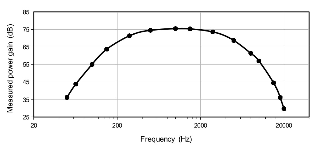

That looks approximately as expected, although it's hard to tell with a linear gain axis. It should be down 12dB (i.e. down to 25%) at about 160Hz, and drop 24dB/octave (i.e. drop by a factor of 16 for each division by 2 of the frequency) below that. Likewise, it should be down 9dB (i.e. down to 35%) at about 11kHz, and drop 18Db/octave (i.e. drop by a factor of 8 for each doubling of the frequency) above that.
There's a hell of a lot of gain there which is quite possibly necessary, but you are more liable to have oscillation problems as you go above 60dB of gain.
Yeah, the design has about 76dB gain in the middle of the passband, and it is necessary, since the signal from the piezo is very weak. I'm currently working on a non-watch-related application where I need even more gain, so I'm really going to have to work hard to avoid noise.
Here is the gain in dB. I account for the noise by using the corrected Vout = sqrt((Vout)^2 - (Vnoise)^2), where Vnoise=0.015 V.  The input voltage is 182 uV (using a 5490:1 voltage divider). I don't have 160 Hz and 11 kHz settings on my signal generator, but at 150 Hz, the gain is down 12 dB from the peak. At 10 kHz, it is down 18 dB. The latter does not agree with the prediction of -9 dB. What could be going on?
I'm not sure what's happening here. To tell you the truth, I've never actually tested the frequency response of any of the amps I've built, although I have modeled them in a simulation tool. I'm about to head out on a week-long trip, but when I get back, I'll try to measure the response of the amp I'm currently using, which is built as shown on my site.
(I recently completed rebuilding a valve amplifier for my Hammond organ, at which time I put together the tools I needed to measure frequency response before and after the rebuild, so I'm now able to do this for the Watch-O-Scope amplifier as well.)
Given that you don't need massive bandwidth, I'd consider putting an input transformer before the opamp stage. Something like 1:4 would give you 12dB of gain, though you'd want an opamp with very low current noise.  Also depends on piezo source impedance since a step-up transformer increases impedance by the square of the turns ratio.
