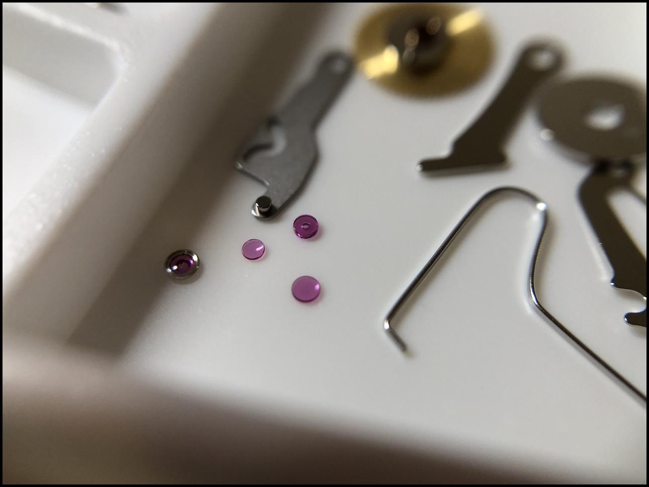

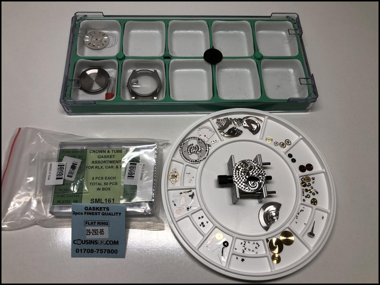

A small update for those who are interested.
Last Friday I finished the disassembly and for those of you who are interested, I have added new pictures to the link I published in a previous post (please sort by name in ascending order). It was over 300 pictures. In the long run, I plan to create a service walkthrough and then I will have plenty of pictures to choose from.
I was a bit unsure whether I should dismantle this cannon pinion-like part on the "Cover mechanism" because Rolex explicitly writes "Do not dismantle". But, since the whole movement is covered with metal debris, I chose to do it anyway. However, I had some headaches because it did not work with my trusted cannon pinion remover nor with some of my presto tools which were all too big.
I tried to pull the tube off by clamping it in my staking set and pushing the tube up with brass tweezers, but that only resulted in the tip of the brass tweezers breaking off (easily dressed) but better than damaging the tube. After looking through a bunch of videos I finally found a video where @Markshows how to do it. Many thanks!
The parts are now soaking in a degreaser (Horsolov) and I will brush them all off before it is time for the cleaning machine. Getting everything perfectly clean will be a challenge considering the service neglect and damage made by the loose rotor.

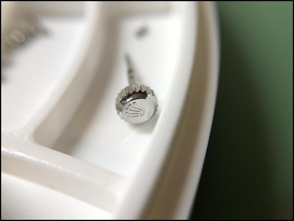

Here is a small update and a few pictures for those who may be interested.
Finally, the cleaning is done! 😮‍💨 It's been a hard and time-consuming job, but a crucial one, as even the smallest residue of metal particles loosened from the rotor could wreak havoc.
The next step will be to inspect all parts under my stereo microscope carefully. I already know that one or two pivots need burnishing. Overall, however, it seems that the damage is limited (knock on wood). I'm guessing this is because the watch probably stopped being used when the oscillating weight stopped working. We should all go back to organic watch oils so that no movement is in danger of being destroyed and users are forced to overhaul their precious timepieces! 😉
