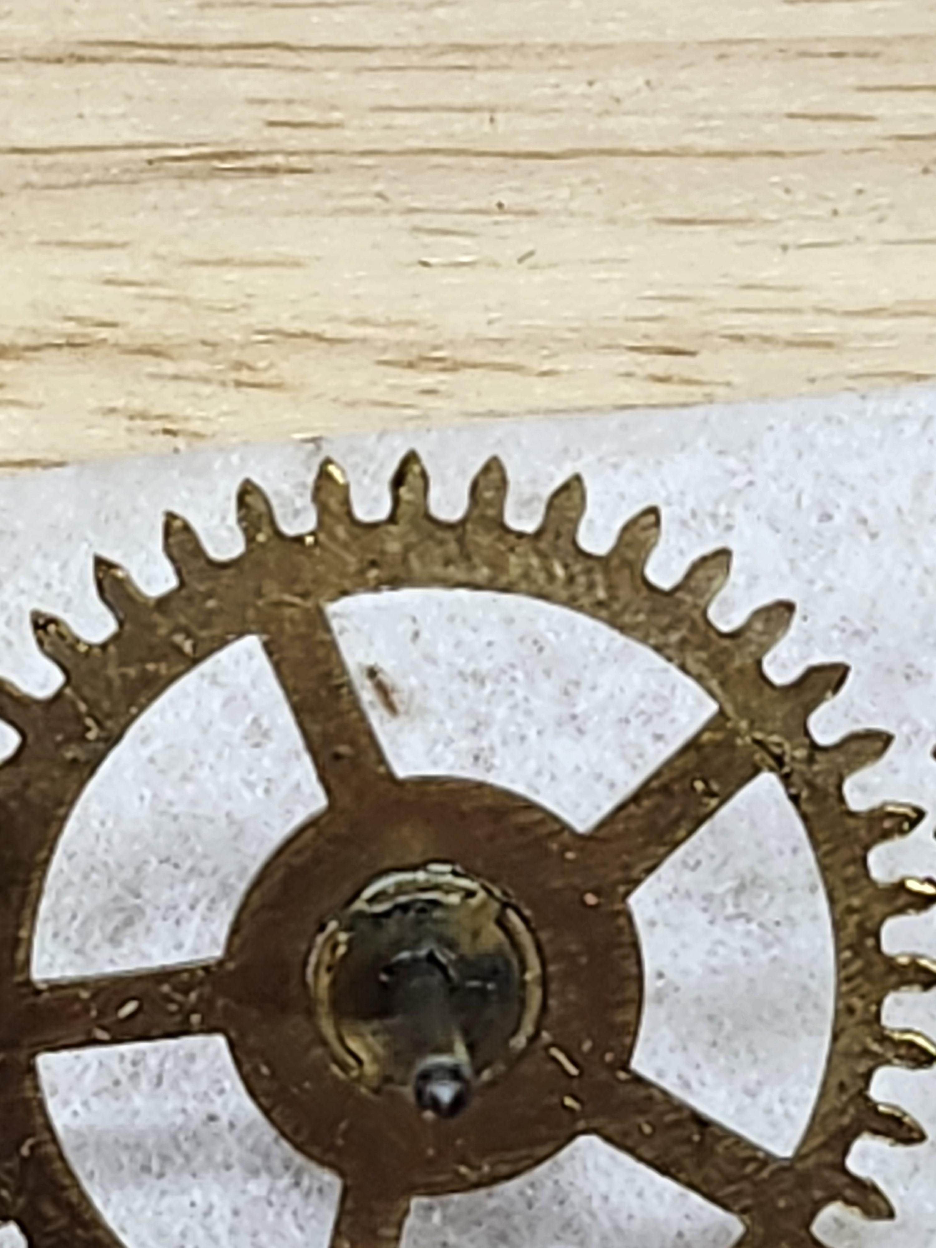

The chime side winds clockwise, but the power side winds counter-clockwise.  Looks like someone has been trying to wind the power side clockwise for who knows how many years and the spring was been unwound to the state you see in the pictures.  It doesn't seem damaged though, and I was able to wind it in the correct direction.

To my untrained eyes, wheel 1 does not look too bad. Wheel 2 appears to be showing some wear on the left hand face of the teeth. Wheel 3 appears to be a little bit worse than wheel 2 in the same place.
The faces on the pinion on wheel 3 appear to be rolled over/deformed as well.
I'm not sure what the tooth profile should be, but I think the wheels are showing some wear.
It might be the angle of the photos though.
This is quite common with these clocks. The problem cause the springs are so powerful but the brass? is soft so wear occurs on one side of the teeth. Clean up the bur and with needle files shape them a little but do not file them shorter as the depth will be wrong and they will not run smooth.  Your photo doesn't show it but I expect the wheel train has lantern pinions which can take wear so the pivots can be loose in there holes a little more than the fixed type. This is the style of lantern pinions.
Your untrained eye is very perceptive!  Wheel 1 isn't too bad.  It is the last wheel in the train so maybe it doesn't get as much power to wear the teeth?  The teeth on wheels 2 and 3 are both rolled a bit on the worn edge, wheel 3 more than 2.
They are lantern pinions.  I'll check the pivots of the pinions and file the burrs off of the wheel teeth.  Thanks for the insight!
Hi there is a definite wear pattern but follow old Hippys advice and face up the teeth and don’t shorten them , check the bushings and pivots also. If they are lantern pinions and worn they can br replaced easy enough.

The non-lantern pinion and wheel combo are actually for the motion works.  It drives the center wheel.  Both the power and chime trains (including the regulator) are all lantern pinion style.  The trundles in the lantern pinions all look to have no direct wear from the wheels - no rutting evident under magnification.
