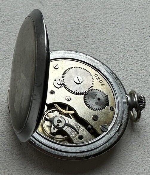

I've just received a pocket watch without any brand name wich looks quite old, and the only information I could see on the movement is 7020. I haven't disassembled it yet, and I must admit I am a bit reluctant to do it as it seems old (but it works well).
Could anyone help me? Here are some photos.

Lovely dial. 15 jewels and Breguet overcoil on the hairspring. Have you got a pic showing all the movement, i.e. looking from the crown?
I've no idea what the movement is, it will be easier to ID once out of the case and measured.
Might be able to identify it once the diameter is given and a photo of the keyless works but no guarantee.

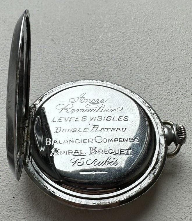

Ancre-----Lever escapement
Levees visibles---visible (jeweled)pallets
Double Plateau-----double roller
Spirale Breguet--Overcoil hairspring
Balancier compense----Compensated balance wheel
15 rubis---15jewels
Looks to be in good condition, and fairly modern.  I've never seen a bent regulator arm like that. Also the click is in an odd position. Should make identifying easier.
I found a comment suggesting that Cortebert are known for curved regulators

This is more complex than a standard pocket watch owing to fact it has 2 driving springs. A mainspring and a smaller spring that acts directly on the escapement. This direct spring provides a more constant torque helping to maintain isochronism and doesn't suffer the energy differences that a mainspring does delivering power through the gear train. The mainspring keeps the escapement driving spring wound up.

I have one very similar to this, i wouldn't disassemble it until you are ready to.
@Neverenoughwatches Many thanks for your remarks. As I wrote earlier, I was a bit reluctant to disassemble this movement, and you gave me further motives to be careful. I'll just remove it from its case so as to clean it a little.

Looks as if some screws have been replaced. The regulator is curved not bent🤣. Look in the BestFit Catalogues on here that I posted ages ago for the I D.

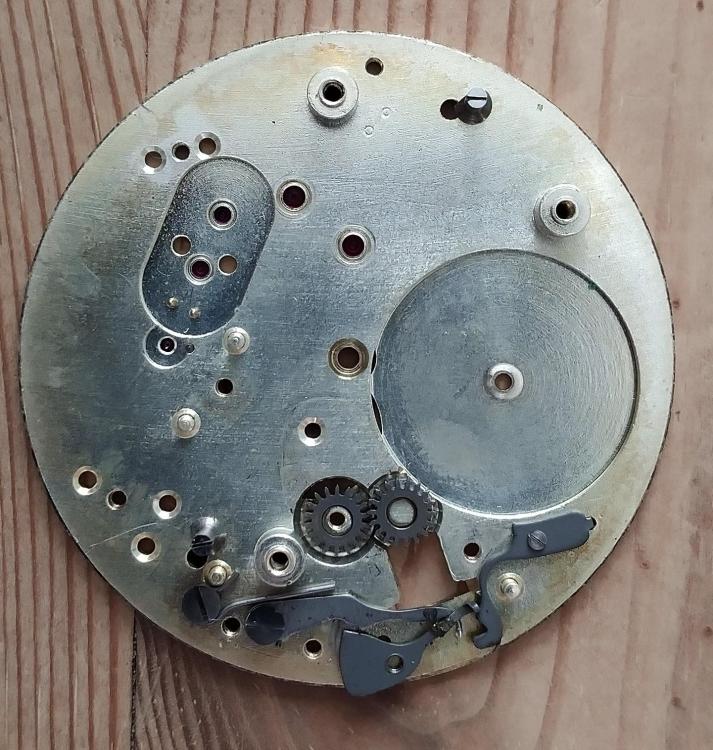

The keyless works used for identification are hidden under the watchmakers side. You would have to disassemble it, you dont need to worry so much about that, doubtful it is a Remontoire as i suggested earlier this morning 🤦‍♂️ but you never know 😁

Haha no not a remontoire, looks very basic.  Good to see the keyless works, can you measure the plate size to cut down on the search for them.

Can you lay out that brass bridge cover as well please next to the other 3 pieces.

Ok thanks  it was just the brass cover next to the previous 3 keyless parts. Normally i wouldn't have expected that to be used to identify,  but I've searched American,  German and French part catalogs and coming up with nothing for the set lever,set spring and  yoke. I will have another look later today.

There is another way but you would have to measure the stem very accurately.

Its ok blueharp the pictures you provided earlier of the 3 keyless components,  the setting lever, the setting lever spring and the yoke plus the brass cover plate should be enough. If they are not listed anywhere then you are relying on any lettering on the movement or someone that just knows the movement from experience.
