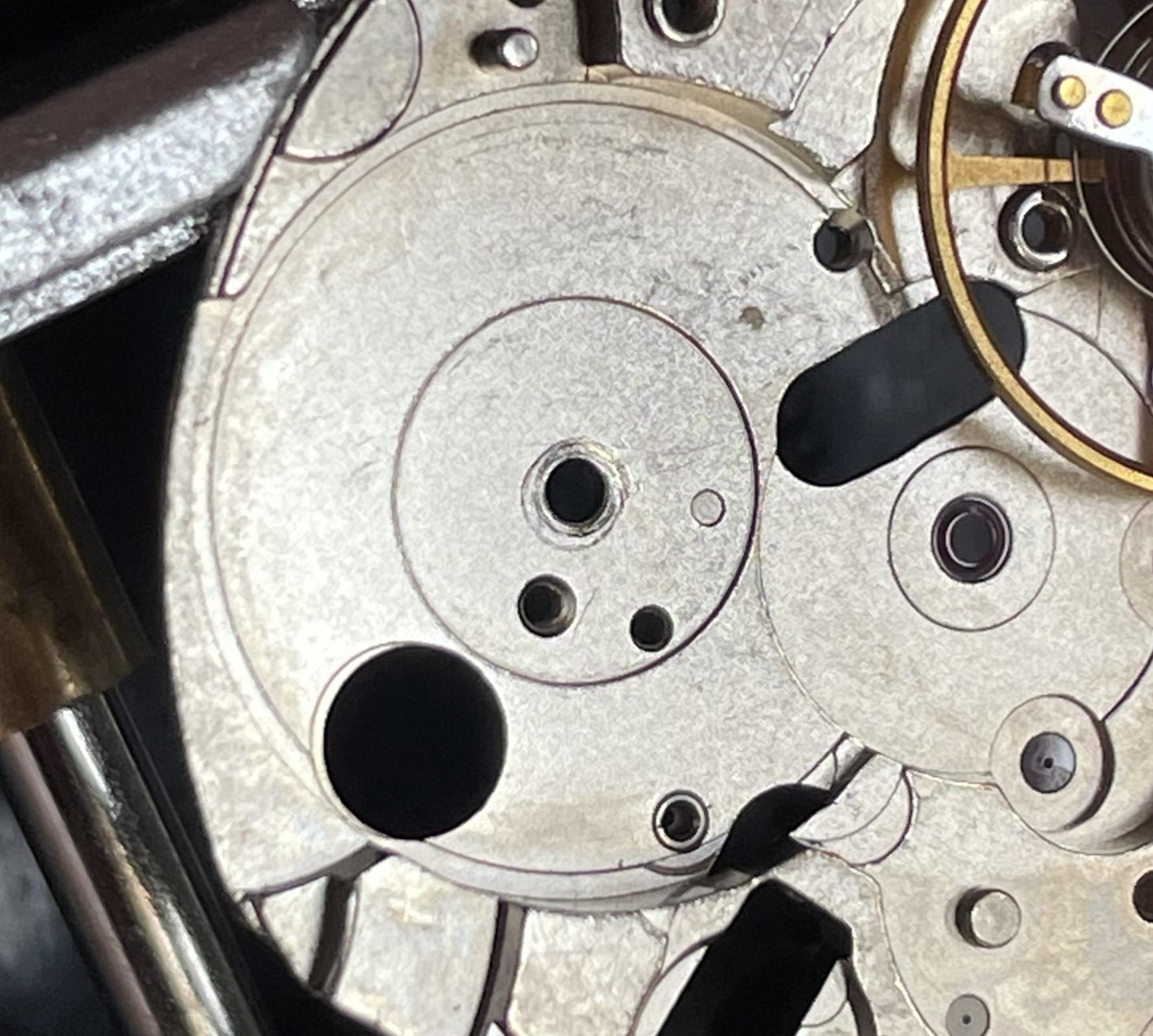

1 hour ago, HectorLooi said:
This sounds like one of the pivot holes has worn and become elliptical.
Can you post some photos of the plates?
I don't know how I could miss it, but your suspicions were right: it looks to me like one of the pivot holes is elliptical, and quite clearly so. There also seems to be some scoring from the ratchet wheel on the bridge, which is odd, as well as the other pivot for the barrell bridge on the main plate.
I suppose I need to find a replacement wheel bridge at least, what do you think about the other damage on the mainspring barrel pivot?

IMG05845.thumb.png.79ea192f6e138261f1660ba7e92d1391.pngpivot.thumb.jpg.589b5eded6ac0bcfb415fa49ca842b4e.jpg
There are some wear marks on the other pivot for the mainspring barrel as well
The hole in the main plate looks kind of oval from here, but it could be perspective. You'll probably want to put the arbor  and bridge back in and wiggle it around to check for side shake. I'm not sure about the 6309, but for the 6139 you can get a jeweling kit to replace the barrel bushings, if you're looking to make extra work for yourself 🙂

4th wheel bushing hole wearing oval is typical for these movements. The bushing has possibly also been moved while pressing the seconds hand too hard so the end shake is so big that the pivot might even fall out of the hole, stopping the movement, especially with an oval hole. The bushing can be replaced with a jewel from a jeweled train bridge. I replaced one 6105 4th wheel bushing with a jewel from a 6119 train bridge.
The effect that You describe (no friction when turning train backwards and noise + friction when turning forward) is due the oval wear of the 4th wheel bush. The oval lets the 4th wheel tilt and get closer to the escape wheel in normal direction rotation, and thus the mesh with 'scape pinion is wrong. There is a simple way to confirm this - mark the bush, remove it and press it back but rotated to 180 degr. This will restore the correct wheel position and mesh when rotating the train in normal direction. The mowement will start working normally. Well, this is not perfect soluion of the problem as the oil retention will be not as good as with new bush, but if You lubricate with 8200 grease, it will stay in place and work good. Of course, placing a stone there is good, if You can find one with correct sizes.
The hole for the arbour in the main plate looks rather punched than weared. So if You have not punched it, then someone before You did. It means that You have to check if the arbour stays upright, as closing the hole by punching it may lead to shifting the hole. What You actually need to check is wether the barrel stays tilted when the movement is wound and let to unwind by train rotation, does it rubb on the bridge or the mainplate or gets dangerously close to the 4th wheel table, and if the mesh with the 2nd wheel pinion is correct. Wear of the barrel bearing holes may lead to similar problems too.

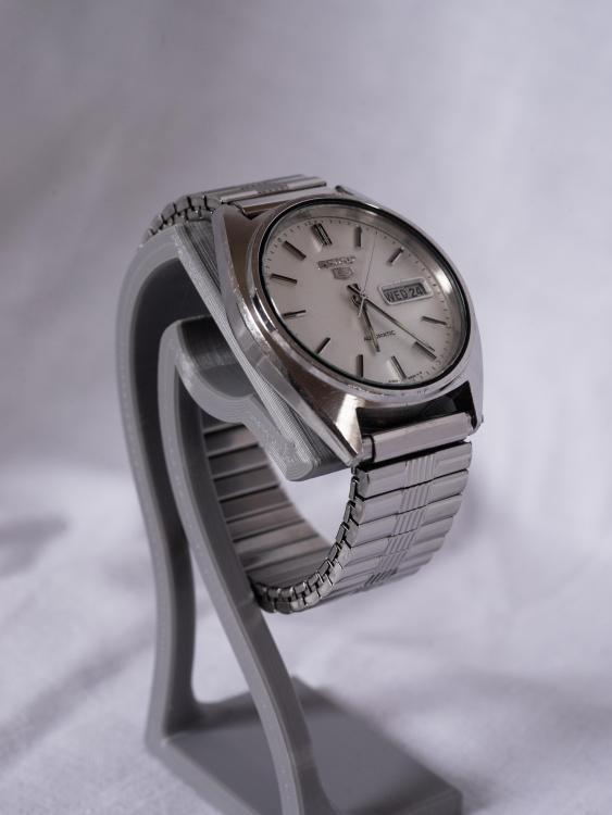

Hello everybody, sorry for the late reply.
Thank you all so much for your help and your tips. I got lucky and found a replacement wheel bridge for cheap which actually ended up being in decent condition. I decided not to do anything about the mainspring barrel pivot since I didn't have the right tools and the barrel didn't have much endshake anyhow.
I am happy to report that the watch now runs great, I have regulated it to about +-10/s day which is fine by my standards. The timegrapher result looks decent as well, although beat error is around 0.6ms which could be better I suppose. Amplitude reaches over 230 quite consistently which I'm happy with also.
My lighter fluid has also been replaced by balance spring cleaning solution and now the springs don't stick to themselves anymore - who would have thought.
I'm super happy with this watch, it might not be worth a whole lot but it's awesome that I could restore it and it makes me wear it with pride.
To me it's a genuinely good lucking watch, it'll be my daily driver for a while.
Thanks again to everybody for their input! I couldn't have done the repair without your help.
Here are some images for those interested, the bracelet isn't original but I don't really mind:
