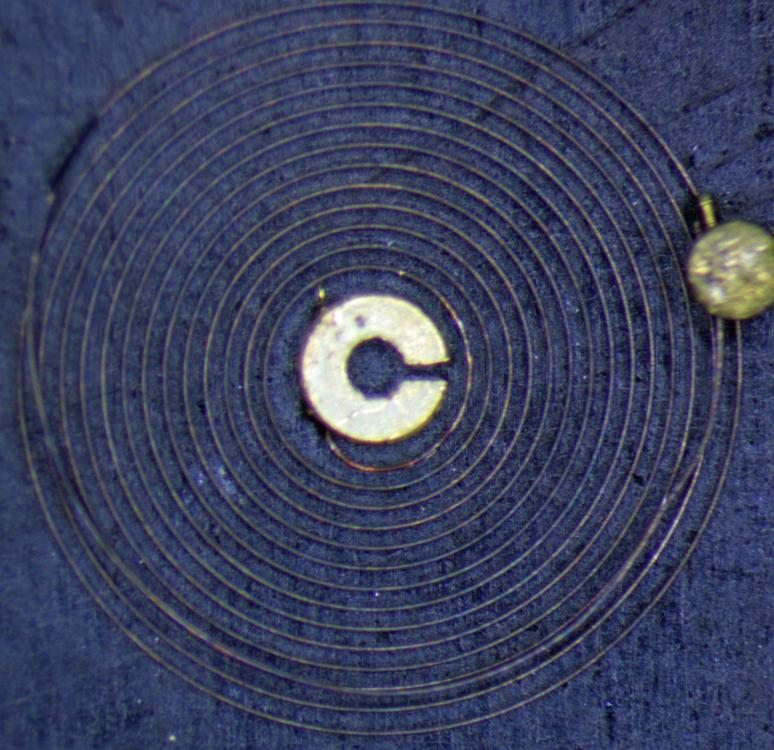

Got my calipers and made the balance as flat as I could.
So it was time to assemble, and when I pressed the hairspring on, I noticed it was super wonky. There was a pretty hard bend and a bit of a twist near the stud.
At first I thought maybe it was supposed to be there, but after looking at the path of the regulating pins, it seems much more likely that it was bent to begin with, or I bent it taking it apart a few years ago when I was less experienced and even more prone to ruining parts than I am now.
Which is saying a lot.
So out came my #1 and #6 tweezers, my favorite hairspring bending tools. It also needed a little twist and adjustment near the overcoil to get the collet centered, but I'm pretty happy with the results. I know the terminal curve could be more perfect, but I had to call it at some point.
Final assembly soon!

Edit: well I was right about needing to see other positions. The hairspring is definitely hitting something in positions other than dial down--you can hear it when you put it to your ear. The overcoil probably needs more tweaking.
Which I'm not going to do right now. Maybe some time in the future when I'm ready for more hairspring practice 😉
