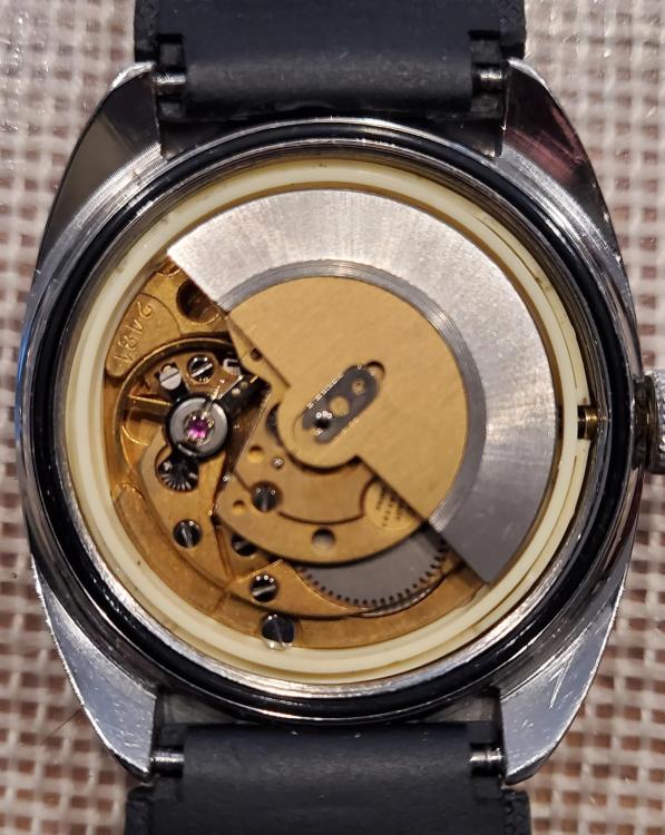

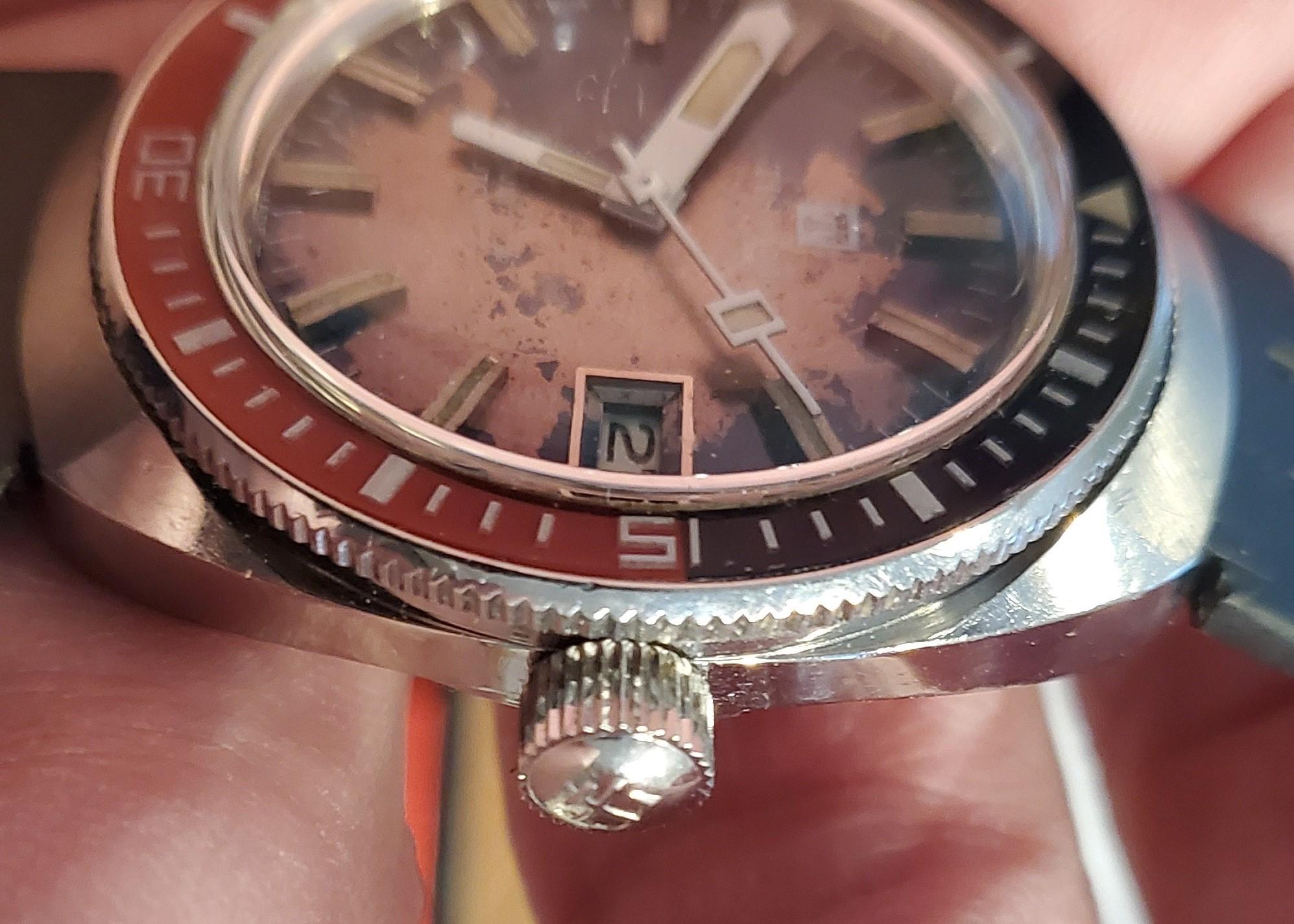

Here's some pics. What the crown does in any position seems completely random. It screws down fine, though to engage the threads you push the crown all the way against the case and then rotate. When unscrewing, the 1st position it springs out to can allow for setting the hands, but that can slip. This position can also wind, or just freely spin. There's a position between the 2 unscrewed positions shown that can wind the watch, or spin freely. Mostly in either of these positions it just spins freely with no resistance. Pulling to the outermost position, which can be easily done, brings the crown out beyond the tube where it won't rotate. But the whole movement can be moved around slightly by moving the crown back and forth in this position.

I think the winding stem has been pulled out and away from the setting lever pin.
You could remove the stem from the movement and re-fit it, I have done a Tissot 2481 and from memory it is a push release rather than a screw.
But most likely the the yoke has come out of the slot in the clutch wheel which would cause the issues listed.
Either way its dial of to fix the problem
