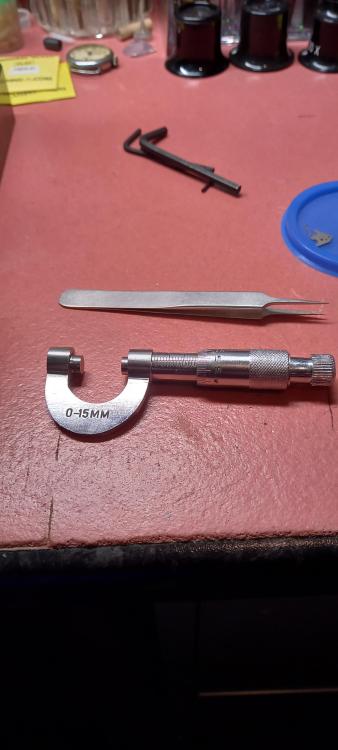

Yeah that sort of thing H but with less frame work, a simple U shaped frame so that you are able to see all around the balance to check that the collet and roller are pressing on ok and you aren't pressing too far. Literally just this but with changable pushers and stumps. I just wondered if there was already something that simple that was made.
Actually a micrometer would work perfectly if it could take pushers

🤦‍♂️ ive just found exactly what i wanted , it just needs modifying.
Quick thought,  the adjustable stop unscrews so does the micrometer adjustment. Drill some brass rod into the ends, one end can have a notch to accommodate the roller pin.

What about the one above i just posted using brass rod for pushers ? The micrometer end has a ratchet 👍. Bloody thing has been looking at me and waving " I'm here you muppet I'm here " 🤣  just realised the adjustment side will need a bearing or it will turn the balance.🤔
