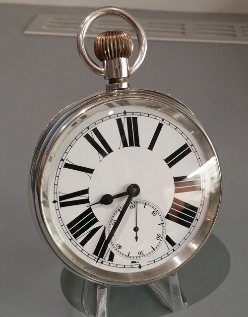

Its been on the back burner for a while but now finished:
..oops, that was the before pic I forgot about (Nurse get my pills). Here's how we're looking now:
I managed to fashion a bow from 3mm sterling silver wire supplied by Cooksongold.com, very good suppliers of findings, bullion, gemstones etc.
Big thanks to:
Clockboy - for the hand, although I used a fettled chrono one in the end. Please PM your address & I will return it.
Edmund - for the lead on the crystal- perfect.
Geo - for the bleach tip. Its worked really well. The hole was filled with Bergeon 1590 white wax.
.............couldn't have done it without your help. Cheers!
Big thanks to:

Stunning work. There you have another ticking fellow who is going to survive us all.
Did you use any special tools to create the bow? I precisely need to restore my great grandfather-in-law's silver watch, that has a missing bow, so your comments could come very handy.
Very basic work - just bent it around a suitable piece of round steel (a socket set extension in this case) gently tapped with a nylon face hammer, ends cut with wire cutters rotating while gently applying pressure which rounds off the cut & helps in fitting into the stem tube. Silver hardens quite quickly when worked so no further hardening was carried out. The bow is more of a decorative item on this watch, I wouldn't suggest putting a chain on it as it may not hold in place.
