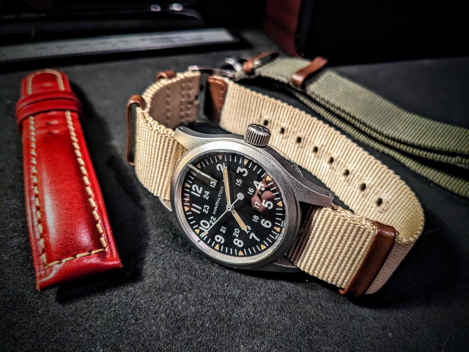

here's front and side of the watch as requested. I don't know it'll come out from the front. But if indeed it's one of those watches that need to come out from the front, I would then prefer just sending it in to my watchmaker to have it done instead. But any confirmation would be appreciated as well.
This is clearly a front loading movement. Measure the width of the dial, then measure the width of the opening in the case-back, then you'll understand there is no way the movement could come out of the back. It's pretty apparent from your photos

hi Jon,
Thanks for your expertise. This is exactly what I am looking for. I wouldn't have thought of the dial vs caseback measurement difference to arrive at the conclusion of front loaded movement until you pointed it out. This saves me the potential mishap. I already learned once to not force my way into a watch without fully understanding the mechanism.

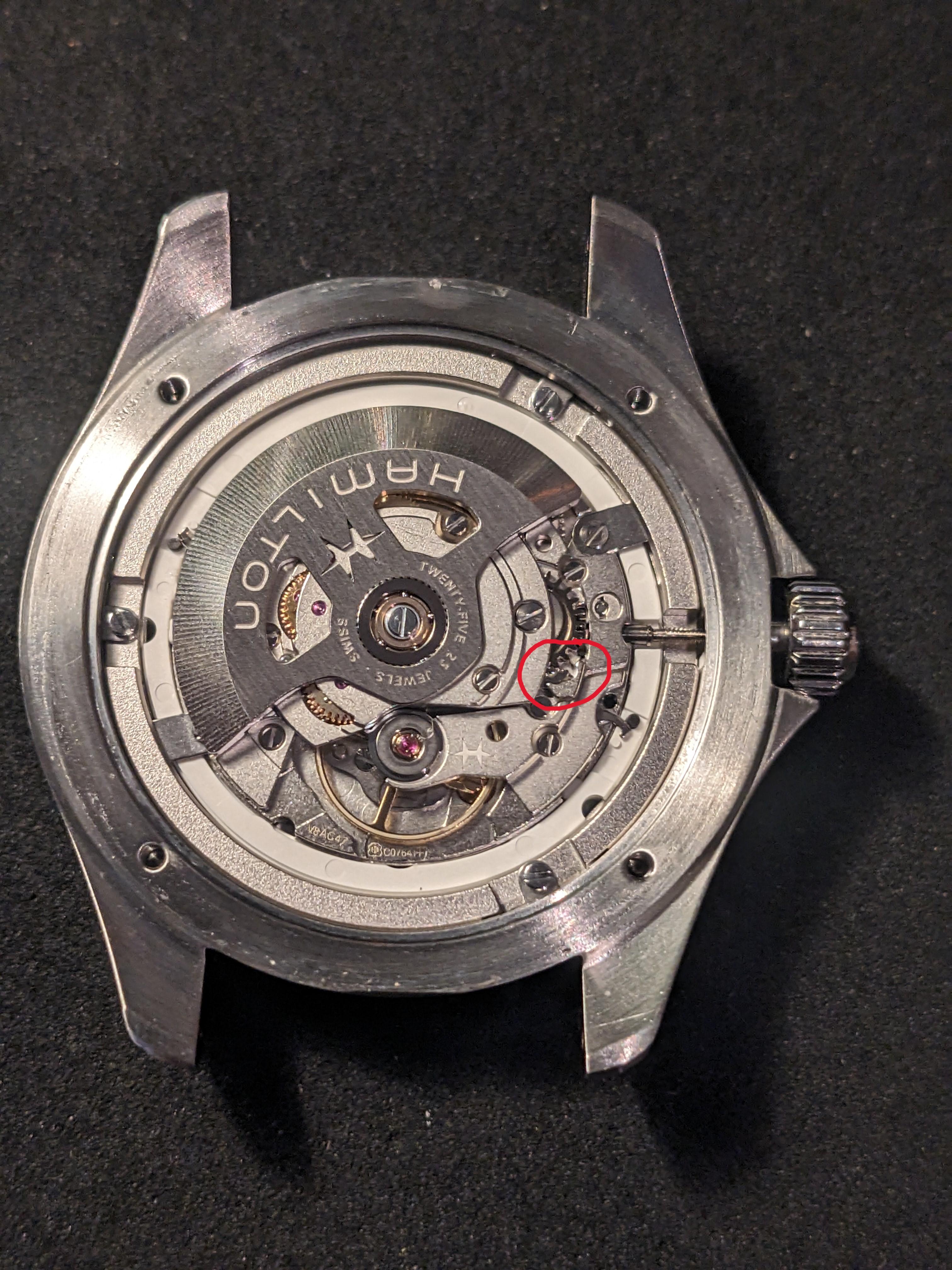

quick question. For automatic movement, particularly this one. can I power down the main spring by pushing this rachet down?
i've gotten pretty used to SW210 and powering down a manual movement. But so far i've only been waiting for the auto movement to run out of juice before opening the case.
Hold the crown when in winding position, move the click away from the crown wheel, and then while holding the crown let it slowly unwind. I recollect that you must remove the automatic device bridge first, but maybe I'm wrong. You can first try without removing the automatic device bridge.

thinking about your movement I don't recall you giving us the movement number? I snipped out an image I can sort of read a C0 but not quite sure what the rest the number is so could you give us the exact number.
