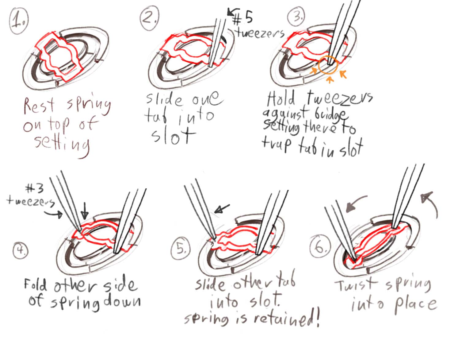

BTW, are we talking about the rectangular Diafix springs or the tuning fork style Diafix springs? It's the rectangular ones that I find extremely "feisty".
On 2/16/2024 at 11:32 AM, Birbdad said:
In another thread somewhere here i drew a diagram of how i set them and it works super well.
That would be interesting to see. I visited your profile but was unable to find it. If it's not too much trouble can you link to that post? Thanks!

I am indeed talking about those godforsaken diafix springs and here's the step by step of how i do it now. It makes it basically impossible for them to ping off because they're trapped by two points before you even really try to move them much at all.
I'll have to try that. Replacing those rectangular Diafix springs has probably been the most difficult motorically among all the challenges I've taken on since I started.
Clever to take advantage of the spring not only springing in one plane but also springing when rotated in opposite directions. I probably never would have figured that out on my own.
BTW, if anyone wonders about the origin of the Diafix name it stems from the word diabolic. The Diafix spring was invented by a particularly sadistic Seiko employee who, during World War II, worked on the design of exceptionally painful torture methods 😉

Yeah, the diafix springs were torture, to the point i would just put off servicing a watch cuz i knew i'd probably have to set them a few times. It's sooo nice being able to just do it in seconds now. Practice that method and it gets easy quick!
