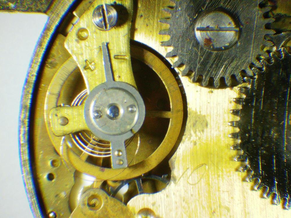

Can someone tell me how to remove this balance spring from the cock? It's wedged into the bottom of the circular metal tab marked in the photo. I know some springs can be loosened with a screw, but not this one. Thanks.

The stud is press fitted into the hole in this fixed stud holder arm , can be pushed/ punched out of the hole.
OR
You might unpin the hairspring.

Some studs are fixed to the arm, i had one a while back and did have to unpin the hairspring.
The cheap Smiths and the Baumgartners in the Mickey Mouse watches have a similar design. Are you just getting to the jewel for service? I was propping up the edge beyond the stud with a V groove stump and a press on the stud with a flat punch. It felt too risky so I just secured the balance wheel best I could with the underside of the cock exposed and unscrewed. Easier and safer I thought…

Thanks for your thoughts. I'm trying to fix the spring, so I must release it. The spring is off to one side.
 Hairspring pin can be pulled out with a percision long nose pliers.
Used carefully cheap pliers last long, heres
https://www.aliexpress.com/item/1005001972446614.html
Repinning the spring back is a bit challanging as you ought aim for the stud hole.
No more than Pulling the pin out with stud left in the cock is needed, preferably cock with balance attached  back on mainplate.
Good luck

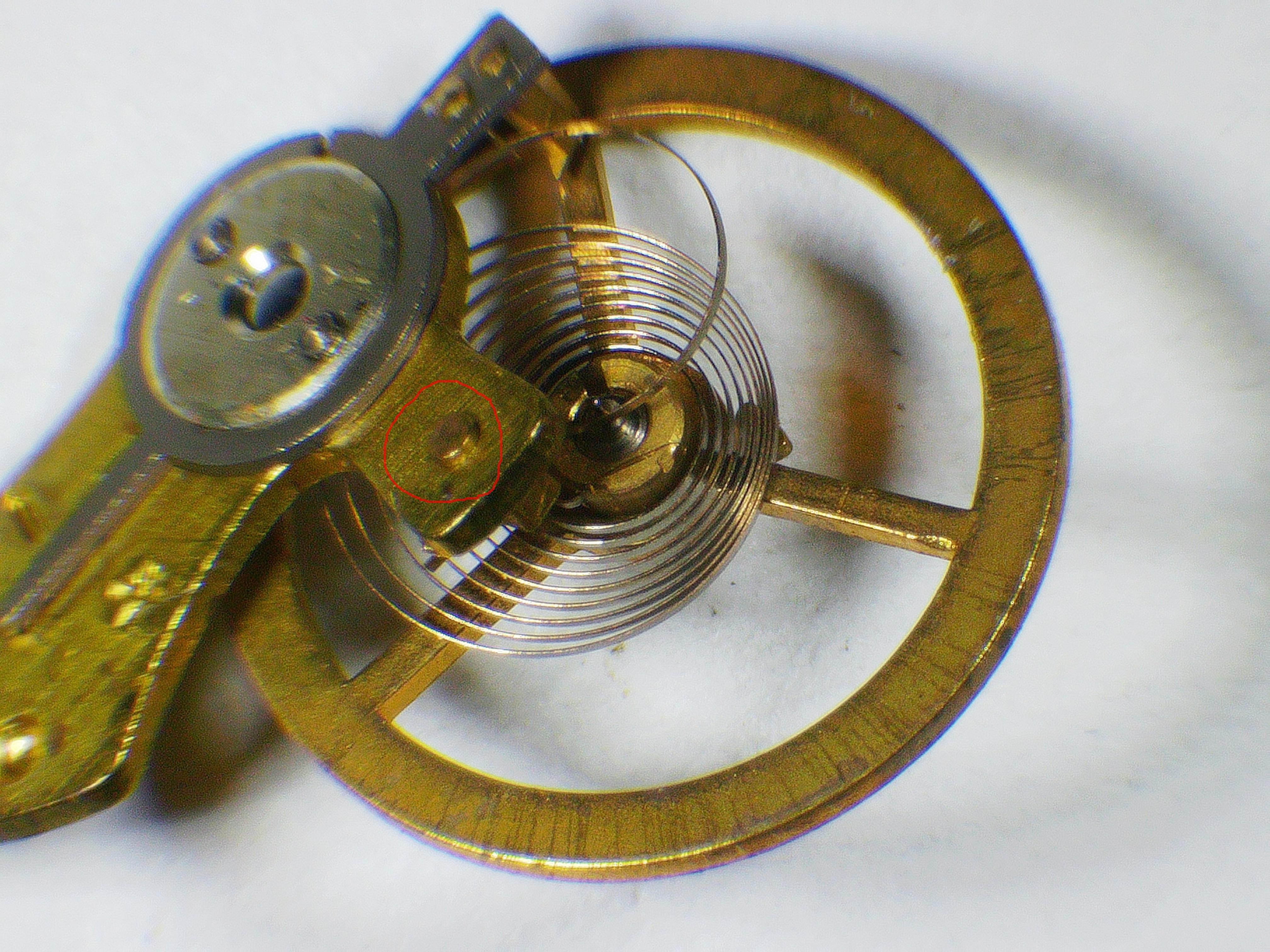

OK, I removed the hairspring pin by putting back the cock bridge and then tapping gently with a hammer and pin driver (for watch bracelet). Here's what I have. It looks like concentric circles except for the last section. I've watched quite a few videos on shaping the spring. Even though it's a cheap movement (but Swiss made) it looks like the spring metal is better than the blue steel.
 Apparently it didn't even need to be detached from the cock, as the coil looks undamaged, but the terminal curve should be shaped parralel to other circles such that you end up with a concentric coil when terminal curve passes through the regulator slot. Final adjustments are done when all is installed back on mainplate .
Its likely to be out of beat when installed, which requires turning the coil a few degrees, you'd be shooting for zero beat error , not an easy task.
I wouldn't touch the impulse pin, turn the coil instead.
Good luck.

It looks like you originally had the two bends to make the start of the terminal curve, but now you've removed the second one.
The first action needed is this:
Here the small circles show where to grasp with tweezers and arrow shows where to push with something, e.g. needle or another tweezers, the aim is to increase the radius and bring the studd some little away from the sping body.
The next step is this:2a.jpg.e1ead368ccfec658d32d05dff2077db9.jpg
The aim is to bring the outer coil closer to the spring body. It actually has to go paralel to the body and to keep distance about 2X the distance between the other coils inside the body. Try to do this as acurate as possible by bending in the manner with tweezer and needle.
Next step is to bring the outer coil in one plain with the spring body.
Here You must grasp with two tweezers and twist the portion between tweezers in manner that hte outer coil will get in the plain of the body. I am not sure about the points where the grasp mus be, as I don't have picture from aside, but hope I am close and You will get the idea.
The next step is to put the studd in place in the hole of the cock.
originalmainspring.thumb.jpg.e7a0fddd496ed21c033e5570fedfe264.jpg.e95b67d9d207b6f72981be4758f044c0.jpg
The studd must be oriented as per the line shown.
The cock is upside down, hairspring up. Then, grasp with tweezers close to the studd and pish and twist  as needed in order to bring the spring in place and paralel to the plane of the cock.
Show the result at that point.

The last outer coil is the one that fits between the regulator pins not the second coil in. The stud also needs to be turned anti cw and the spring straightened out from there. I'm beginning to think that the spring is too long and should be repinned, or the bend at the terminal curve be removed and  completely restarted

You have shown it to be  3.3mm , thats where( called regulator arm slot )  the outer most circle ( the terminal curve ) should pass through.
Lucky the coil looks flat, adjustment for levelness is most likely needed near the collet, sort out the terminal curve and relevent area first.

I hope this is close enough. And given my lack of experience, it's as good as I can get it. It's a $5 Waldan watch, so no worries.  To me it looks ok, although there's a small kink at the outer coil. The coil is flat. It was pointed out the spring might be too long. It could be, but I think it's original. Thanks for all your help! Now I have to reassemble the balance. I got some advice on how to orient the stud. I know how to guide the spring around the regulator pin and shut it. I'm not sure about the alignment between pins. I don't have a jewel, but I think this is what they're talking about (circled in red) in photo.
