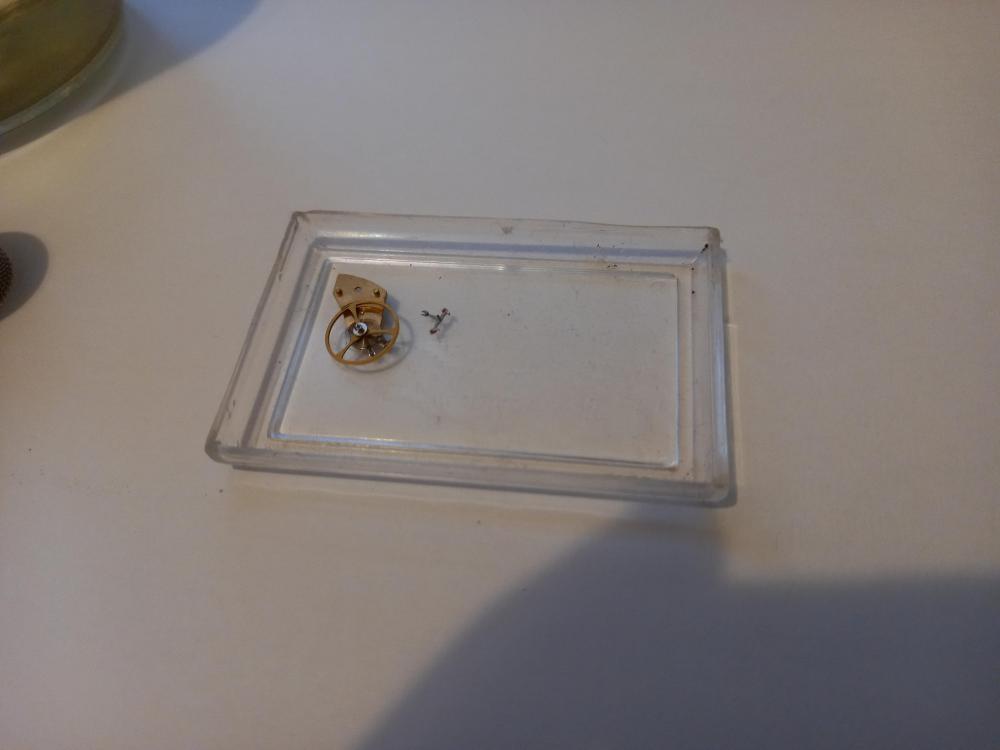

Before;
After;
and the same results I get with the wheel-train, screws etc.
Everything comes out sparkling clean 🤗
