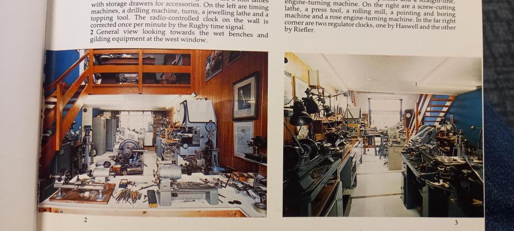

And here are the Struthers' workbenches. George Daniels never used armrests either.
37 minutes ago, Jon said:
I like them and I find the position of my arms a little more comfortable but they don't make you a better watchmaker! Here's a photo of Roger Smith's workbench with not a pad in sight and look at the stuff he knocks out.

Took these pictures from George's book.
