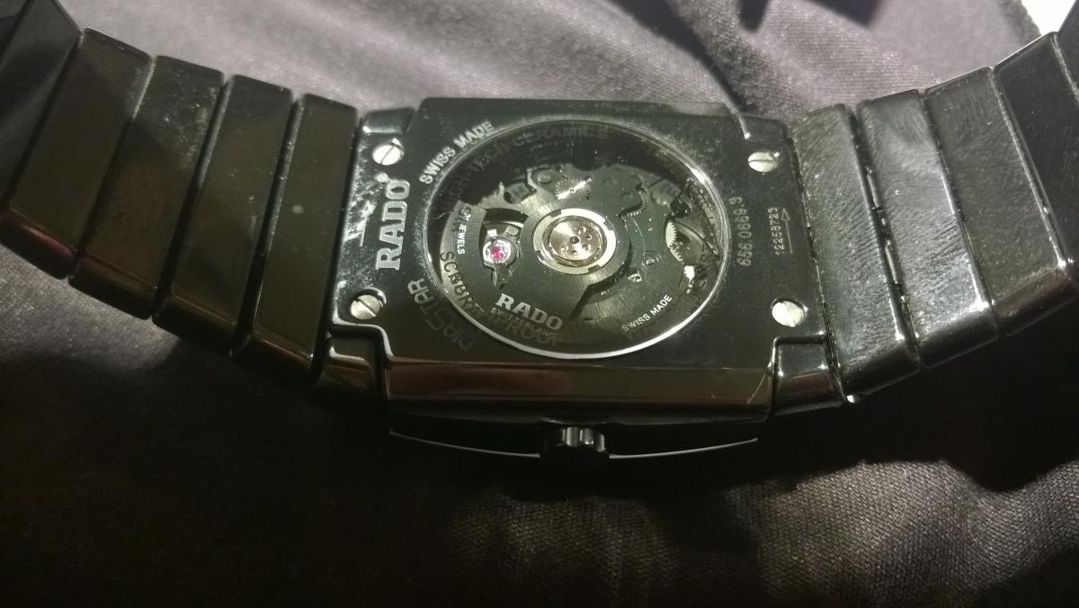

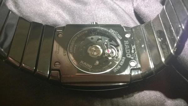

Thanks for the responses so far. As requested, I am adding some photos. One is a front view and two with a view of back of the watch. I hope this helps.
post-1431-0-91841800-1442019898_thumb.jp
post-1431-0-59894400-1442019901_thumb.jp
post-1431-0-04705400-1442019905_thumb.jp
That's a beaut. Cosc certfied too... Should be top notch. I would ask for my ££££ back. Does it state what movement it is ??
Sent from my HTC One using Tapatalk
I love the watch! Problem is I'm not familiar with it...you said it won't hold a charge but...is it electronic/digital? I think I saw a balance wheel there...maybe it is an auto with a weak spring? In any case, I'd love to know what movement it uses...maybe it is an easy fix, like a simple maintenance as Geo recommended.

Salon, As I stated in my original post there are quite a few things that could be wrong.The fact that the watch runs is good.
However the only way to fix is to have it looked at by a watch repairer who will strip it & inspect.
Dear Saleen,
New old stock watches may have problems with old oil.
What happens when oil gets old is that it takes greater energy to keep things moving.. so you may have a watch with full wind but somewhere at the half-way point between fully wound and unwound it stops, possibly because the 'resisitance' in the train is more than the residual power in the mainspring.
One way to check this is once the watch stops (without hand-winding mind) ,  release the mainspring keeping track of how many turns of the crown, or ratchet wheel screw until it is fully unwound (you need to remove the winding rotor and bridge first),. typically you should have less than half a turn. If you have only half a  turn then then the fault is in the automatic winding. If you have more than one full turn of the ratchet wheel you have a problem in the train.
one thing to consider is that the watch may have been faulty in the first place...someone bought it but found it didn't work well and brought it in for a replacement...dealer was lazy sending it off and then it was too late!
