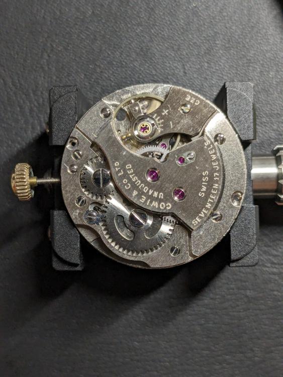

Hi, I wanted to ask around here before attempting to lubricate the shock setting on this watch. It's got an odd assembly that I wasn't able to find online and I'm unsure of how to take it apart. This comes from an FHF 1686 movement.
Any help with identifying this shock setting and subsequent disassembly help would be appreciated!
Neat, I've never seen one like that. It looks to me basically like a circlip, where you need to squeeze the prongs together. I'd get my fine tweezers in one of the holes and push towards the center.
Looks like a serious candidate to join the Swiss Space Program, so maybe take precautions with some Rodico or a plastic baggie.

Its a swiss bal. shock spring. Stabil, it should operate like a lyre spring. If you can post a clearer closer photo.

As a quick update, I was unable to remove either of the shock setting springs. I think they do have a similar structure to a lyre shaped spring as suggested but the "prongs" are just too wide to be unseated through the provided gap.
Any suggestions where I could find more info on this assembly? At present, I don't know how someone would be able to service these without a specialized tool.
 If you seperate the balance  complete   from balance cock, removing the stud and regulator arm would reveal whats  hiding  , you see how its structured thus are likely to figure out how to get the sucker removed. Just an idea.

Is the width of just one arm wider than the space provided to remove it ?

I think it's only 1.5 the width or less. If I try to remove one arm, the other blocks it preventing it from being removed. I've also tried pushing the spring to different positions to give more clearance but my attempts have been unsuccessful unfortunately.
I may try as Nucejoe suggested although it looks like the shock setting is press fit into place. I don't own a jeweling press nor have I used one but I don't mind just shelving this project until a later date.

You might be able to lift one arm up and over the other as you push it out of the slot. Obviously dont force anything and use good magnification so you can see how much space and tension there is between the two arms. Good luck🤞

We have success! I was able to service the shock setting finally and the watch went from running at +100 s/day to only -9! The tolerances are significantly tighter than in incabloc springs and it was difficult to see even if the spring was unseated or not. I'm still curious about what this shock setting is called but for now I'm willing to just accept this small victory.

The design is as i mentioned earlier Stabil
