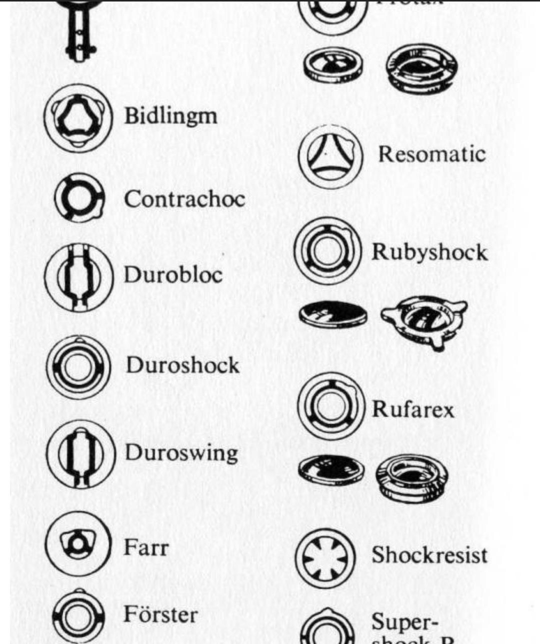

Interesting. Yeah, Ranfft says the Durowe 7523/2 has the Rufa-Anti-Shock system. 17jewels says the 7255 also uses the Rufa-Anti-Shock system and the photo of it looks the same as yours. There seems to be a glitch in the matrix with the incorrect Incabloc information. It looks like that system isn't hinged, so I can see why it pinged off into the great beyond.
Edited by GuyMontag
Might be economical to just get a 7523 movement or one that interchanges, but it seems like the interchange info isn't accurate. Not sure, I'll check and see if I have one in my parts drawer.
Expand
Ive been looking for a movement that i could get the spring from, but haven't been able to find one.
according to this sheet, it looks like the spring is a Duroswing.
I forgot to close this out, so thanks to GuyMontag, who graciously sent me the correct shock spring, the watch is up and running again. I still need to go back and fix a few things; needs a new stem and the date jumper isn’t  quite working right yet.
Thanks Guy, and thanks for all the help with this watch everyone.
Bill
