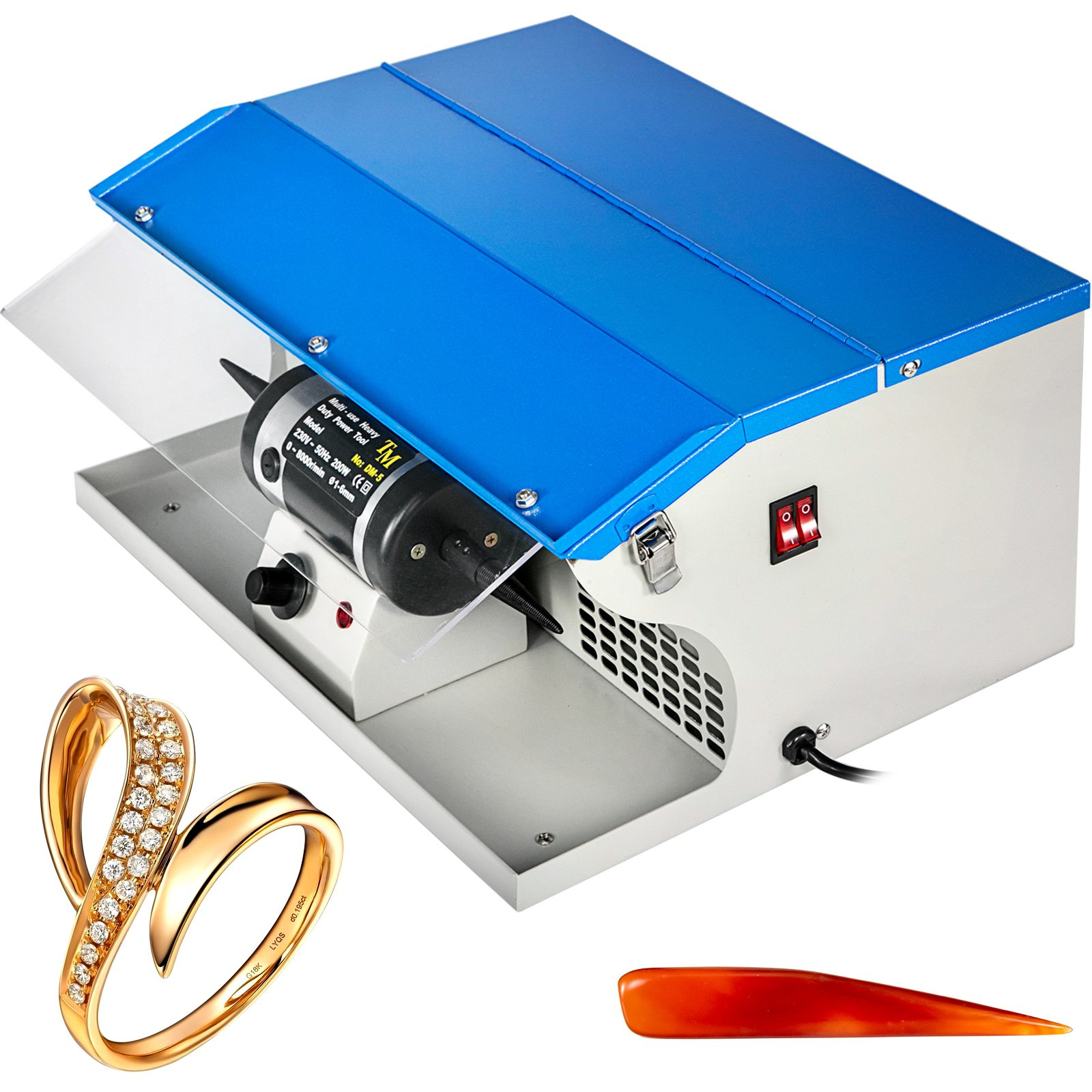

Right now I have my eyes set on this machine. The ad says it takes 4" wheels which seems to be the most common wheel size with a plethora of options. However, one of the reviews mentions "best result is achieved with ~70mm discs" without any further explanation and it makes me feel a bit uneasy. It's about $200

Your 1st and 4th options have a built-in dust extractor. That is good feature to have.
Don't get the Foredom. It looks like a Chinese made motor that should sell for less than a $100.

I believe this setup comes with different types of motors. Some are stronger, some weaker, and I believe that's what's reflected by the price. Anyway, this version may be perfectly good for polishing watch cases so if anyone gets it, please let us know what you think. The dust from the wheels, polishing compounds, and metal is definitely a poisonous cocktail that you don't want in your lungs. Since I have zero ventilation with my setup I use FFP3 classified respiratory protection.
Yes, there are different versions.  One is 200w and another 500w.  The one in my link is the 500w version.

I sure would have expected it to be the 200w version considering the low price. if I had lived in the US I would not have hesitated to order it. Thanks a lot for the tip anyway!
