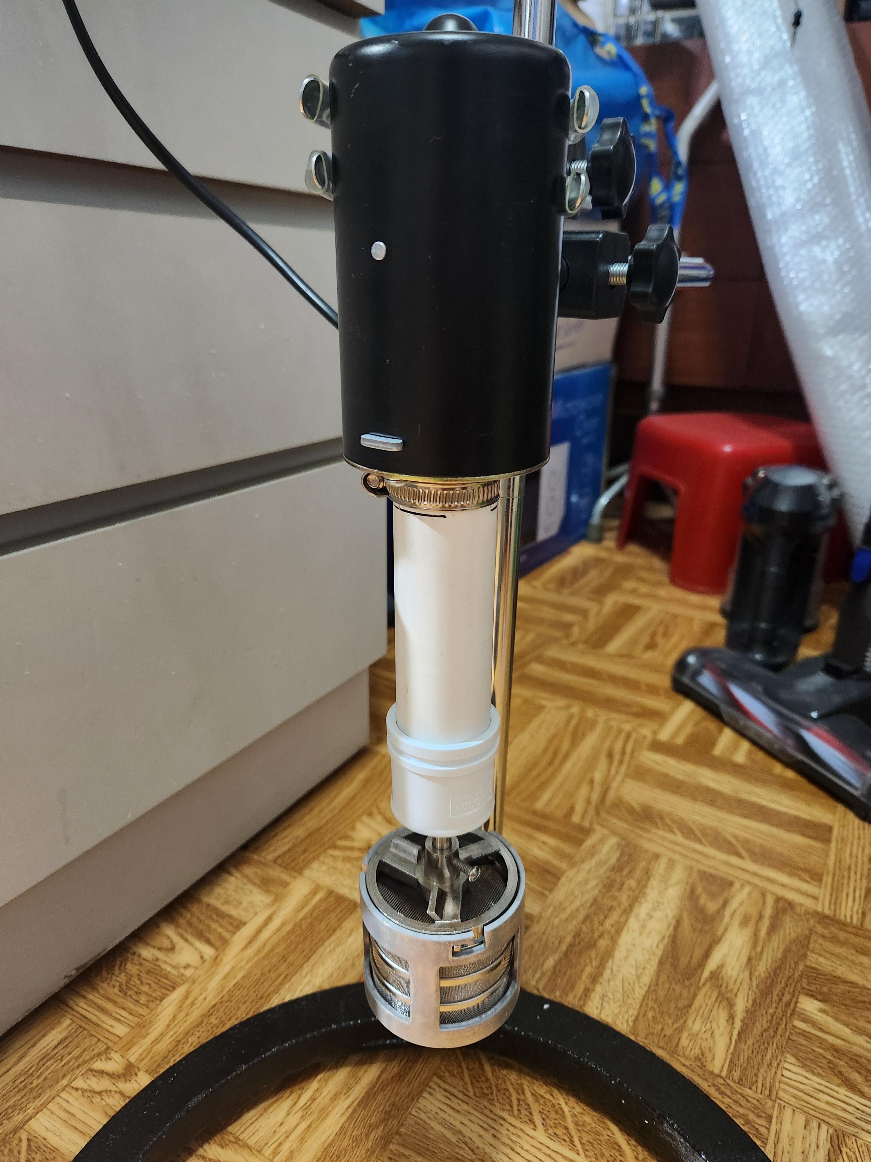

After watching Alex Hamilton's video on improving ultrasonic cleaning, I decided to make a similar machine but using studier components.
I first got a chemical stirrer almost identical to the one in the video. Then I got an Indian-made cleaning basket from eBay. After the parts arrived, I set about putting it together. I wanted it to be able to straddle my ultrasonic cleaner, so that the basket can be lowered into a glass jar containing the cleaning solutions. I wanted the basket to rotate slowly while the ultrasonic was on to avoid dead spots on the tank. I also wanted the basket to spin rapidly to spin dry the parts after each cleaning cycle.
So this is what I came up with.

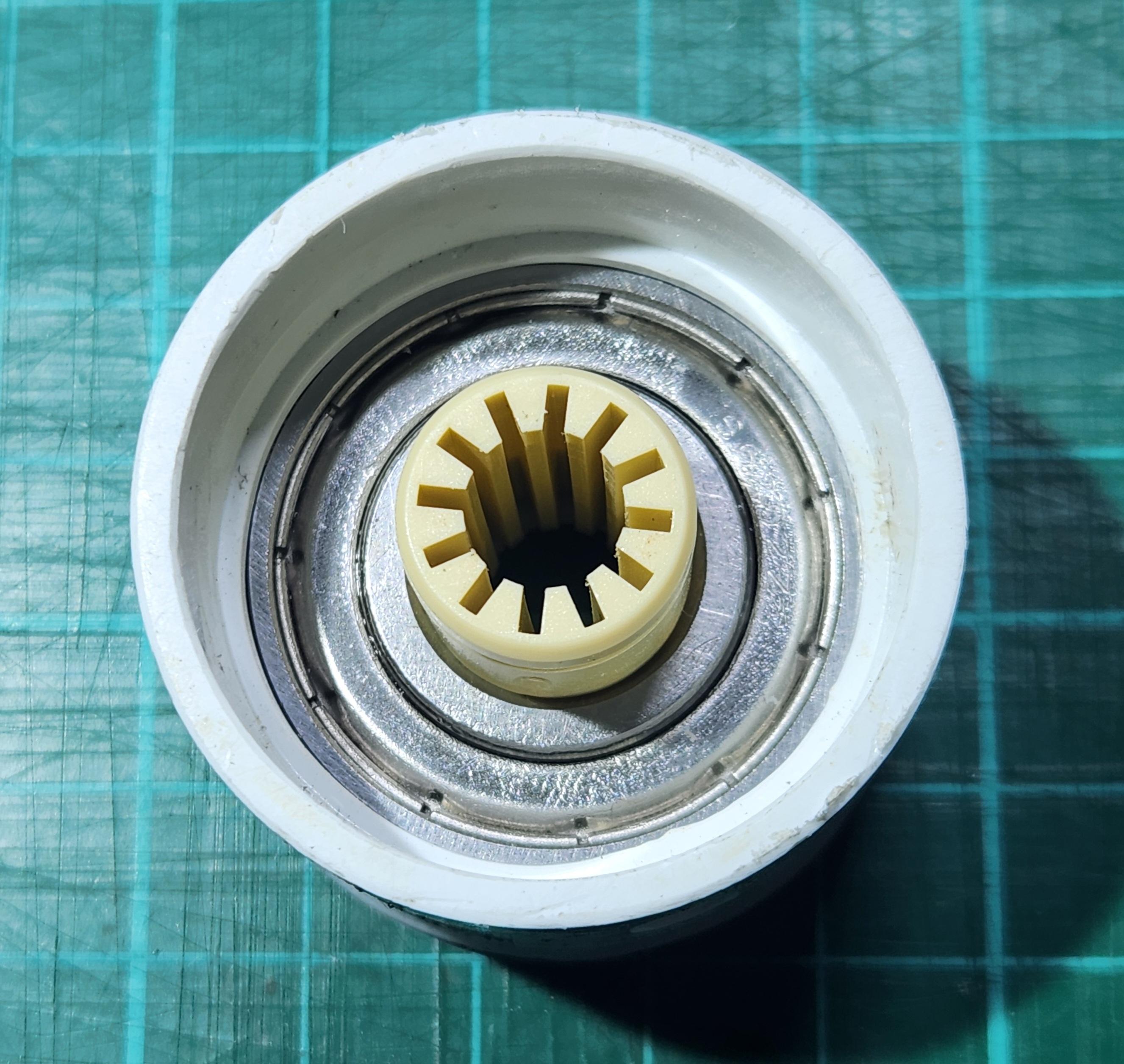

The basket fits to a 8mm shaft but the chemical stirrer only accepts a 6mm rod. So I glued a 8mm stainless pipe over 6mm stainless tube. The rest was easy.

I'm having a slight problem with the basket. The cage is a little crooked when it locks into place. And that causes a very bad wobble when the basket is spun at higher speeds.
I'll investigate this tonight and see how to balance it properly.
Yup. As expected, the cover is crooked. It is probably sand-casted and was distorted right from the start.
I'll try to mitigate the situation. Failing which, I might have to fabricate one out of plastic or aluminium.

If the lid is bent then I'm guessing the 3 locking tabs are not in line with each other. Couldn't you file them or /and the locating recesses on the basket to bring the basket and drive shaft into line.

Yes. I've been filing the tabs. It has improved but still wobbles a bit. Another thing I could do is to shorten the shaft. I'll continue working on it tomorrow.

For a moment it was like the cartoon where the chair had a shorter leg and I cut the longer ones and end up with another leg longer.
But happy to report that the basket trued up nicely. I also noticed that the stirrer motor has a collet chuck. I could remove that and fit a fixed coupling to reduce some more wobble.

Haha sounds like a laurel and hardy scene.  Yes i think those stirrers have a 7mm collet attached to an 8mm drive shaft. Shortening the shaft from the basket to collet would also reduce the  run out at length. Good to know you fixed the wobble, i think a little is good as it adds to the agitation as long as its no real detriment to the motor bearings and basket fittings. Appreciate the feedback on this hector, i contacted the seller and he ships to the Uk. Including shipping around £80  which i think is very reasonable if it holds up to weekly use.

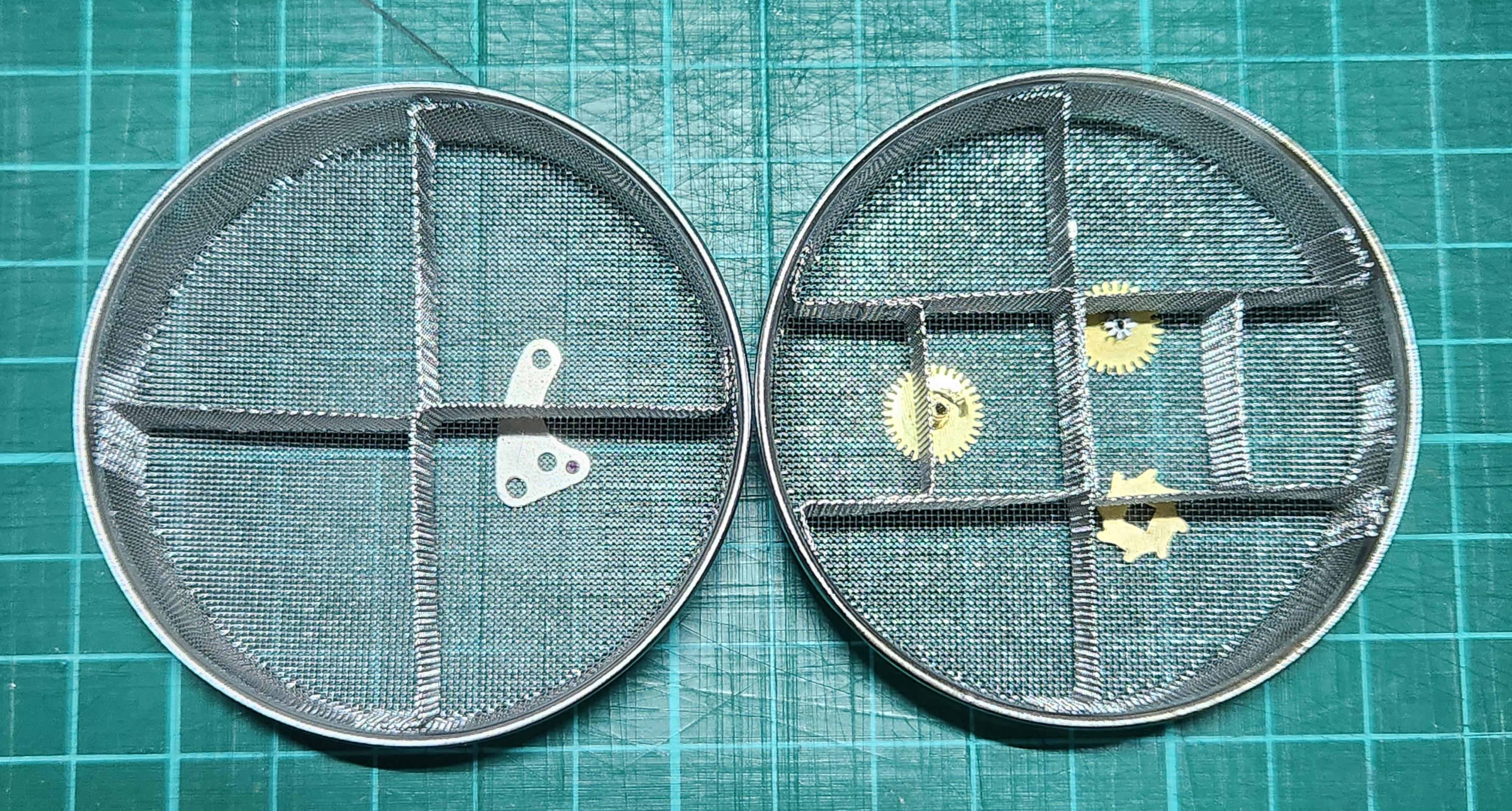

Another new discovery after using this basket for awhile. The wire netting dividers are not welded or soldered to the bottom netting. So small parts can slip under the divider and end up in another compartment. 🤣
Haha yeah i meant to mention that  H. Another great aspect of Indian quality.
I got the same set with my pearl watch cleaning machine, I soldered along the bottom seam/interface myself to prevent the parts moving around. Also the dividers were not folded over at the top, so the steel mesh started to fray and pokey bits of steel wire stabbed me when using the baskets. Slowly swapping them out with higher quality ones.
