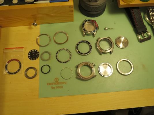

Update,
Here is the way I got these cases and believe me, I'd like to save them all (put them all together/restore).
Thank you in advance for your help and instructions,
Cheers,
Bob
Okayyy.........
From what I can see.......
Top row left to right: 1. not sure. 2. bezel insert spacer. 3. 7S26-0050 case. 4. unknown crown & stem (might be for the 7s26).
Mid row: 1. 4205 dial. 2. unknown grey movement spacer. 3. bezel insert. 4. bezel complete. 5. 4205 case. 6. caseback.
Bottom row: 1. pepsi bezel insert. 2. 4205 movement spacer. 3. unknown black movement spacer. 4. not sure. 5. 4205 case 6.4205 caseback. 7. bezel with spacer & without insert.
Cant be 100% sure but if you can post closer individual pics of the items I would be able to confirm what is what.
You should be able to make up one 4205 from this lot with the addition of a caseback gasket, probably a bezel o-ring, movement, hands, chapter ring. crown and stem. Same extras again plus another movement spacer will give you 2, although it looks like the case on the bottom row is missing its crystal and gasket. Crystals are not a problem, however the gasket is another matter. As for the 7s26 it looks like it could do with a movement, movement spacer, dial, hands, chapter ring etc.
