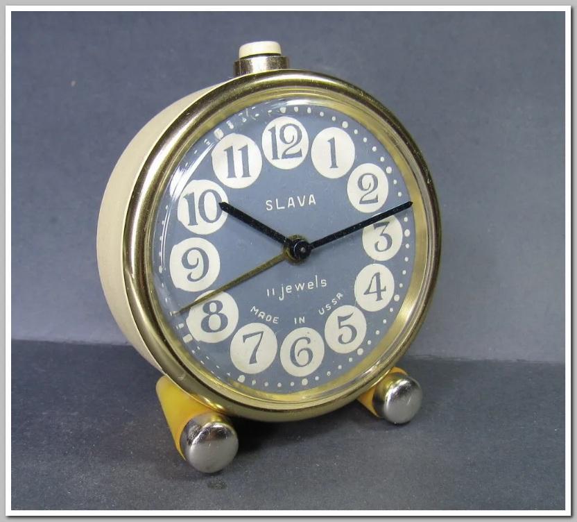

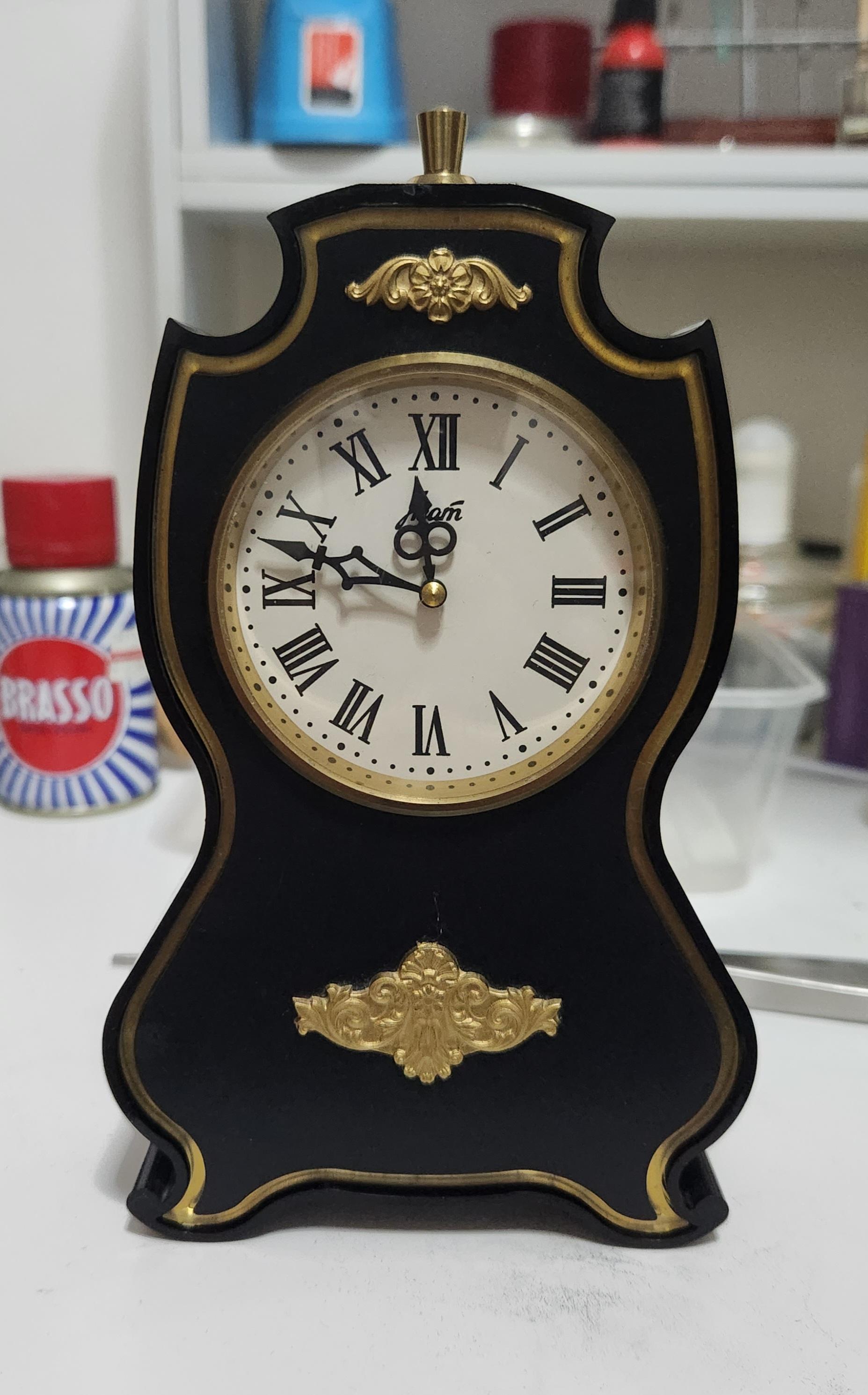

Hi @nevenbekriev, in your article on setting pallet depth in The watch Forum, you mentioned Slava alarm clock as a good example to study the escapement due to its size. May I know what model is recommended? Would the model in the picture below be suitable?
By the way, I love Soviet clocks. Like my Agat table clock and my submarine clock.
Hi Hector, The one in the first photo is the one. No mater of the model outside, they have the same movenetnt (11 jewels) with sometime different names on the dial as МИР, ДРУЖБА. The second one, АГАТ  is different, it is based on the old Hampden 42mm pocket watch movement that russians bought the factory back in 1933 and started production of КИРОВСКИЕ 1МЧЗ.
I used Slava movement in the article as there is (stil) many of them here (Eastern Europe) and You can get one on a carboot sales for less than 50 cents, and of course, the size and design of the movement are perfrct for educational purpose
