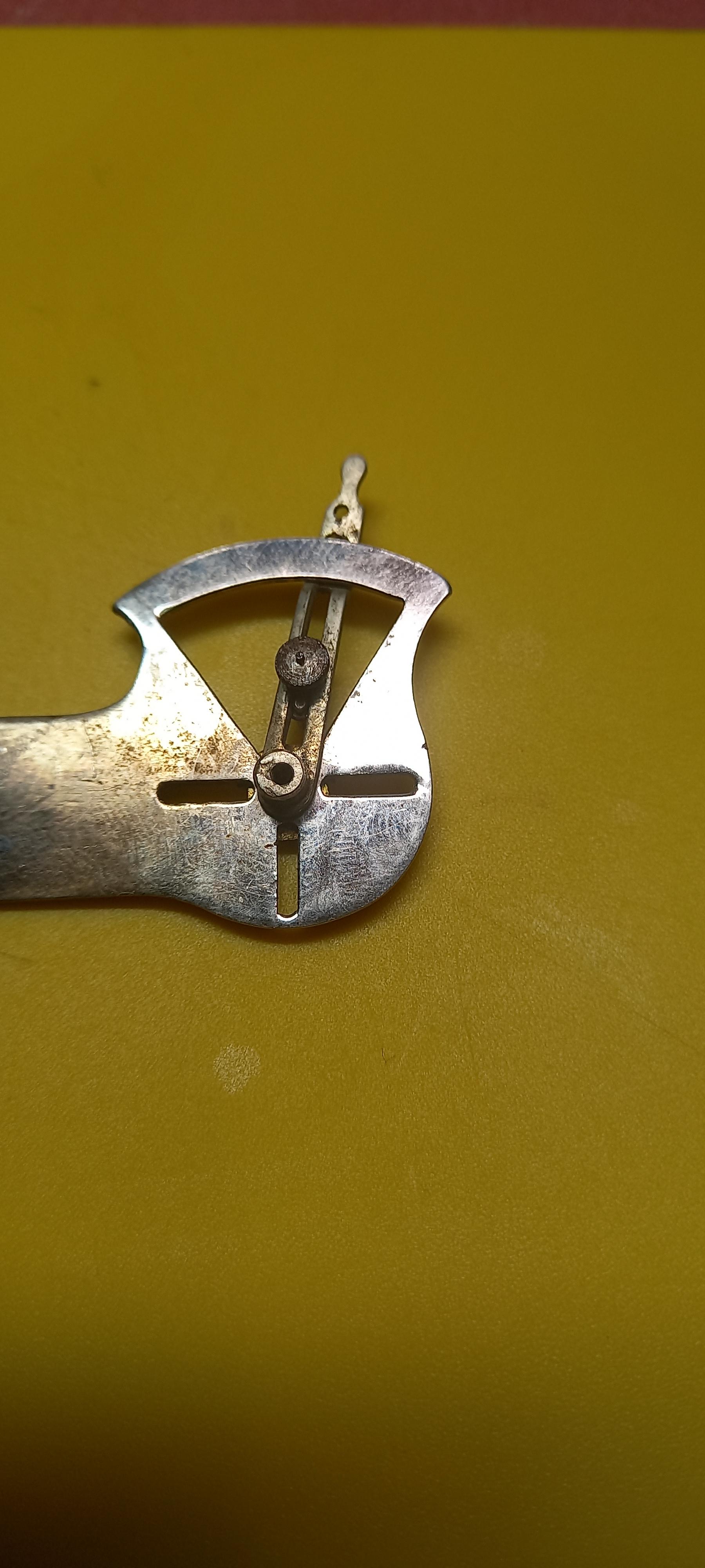

Another mystery tool of the day chaps. This design is 120 years old, no idea how old this one is that i have. Had it for ages and almost binned it as it doesn't look like much. Then someone posted on another site they had one along with an advert for it. Its open to anyone, tbh i think only the pros will guess it. Only clue i can give is that it used in conjunction with another tool that only the pros will use, although its condition is also a clue. This has to be the most difficult yet. Oh dear i seem to have inadvertently masked out the patent on it, thats a bugger.

Bit of scale added, oh no tweezers fell and obscured that patent again

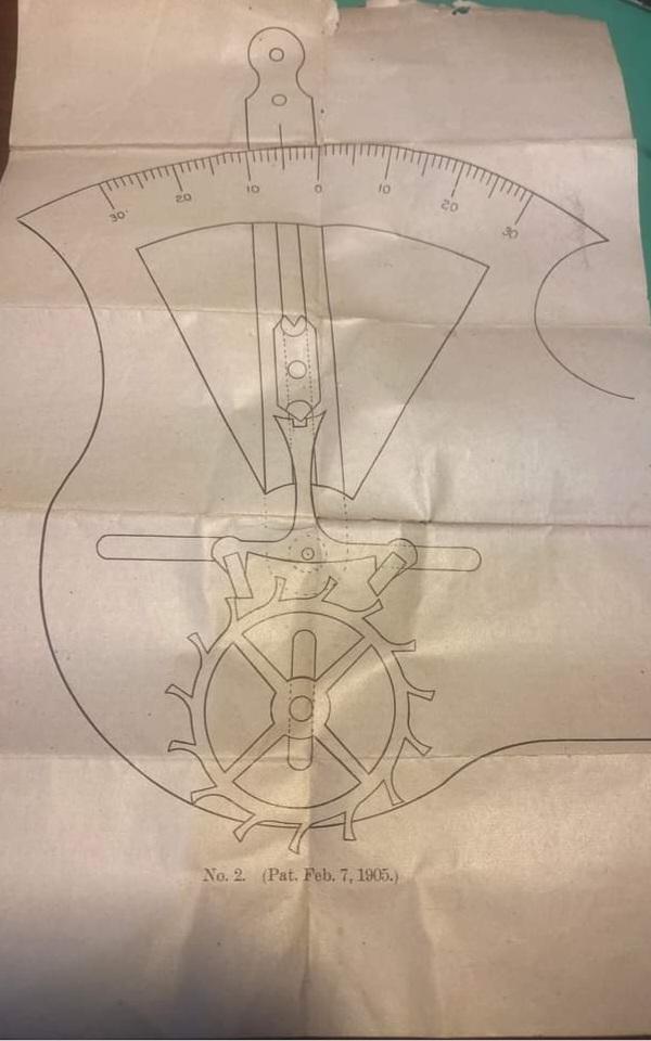

No not the impulse jewel, Tom was right with setting up the pallet jewels but in a way i haven't seen before. Here is the advert for it from 120 years ago.

@Neverenoughwatches, from the news article the complete set is $3+$2.25 = $5.25 in 1905.
Adjusted for inflation, that is around USD 183.18 or GBP 144.69 today. Watchmaker tools cost an arm even back then.
I wonder what "order from your jobber" means?
The patent was issued 1905, the advert i guess a little later. Actually for the depthing tool sounds quite reasonable but for the pallet setter which costs more seems a lot. Maybe its a piece of amazing innovation, I'll let you know when i try it.
