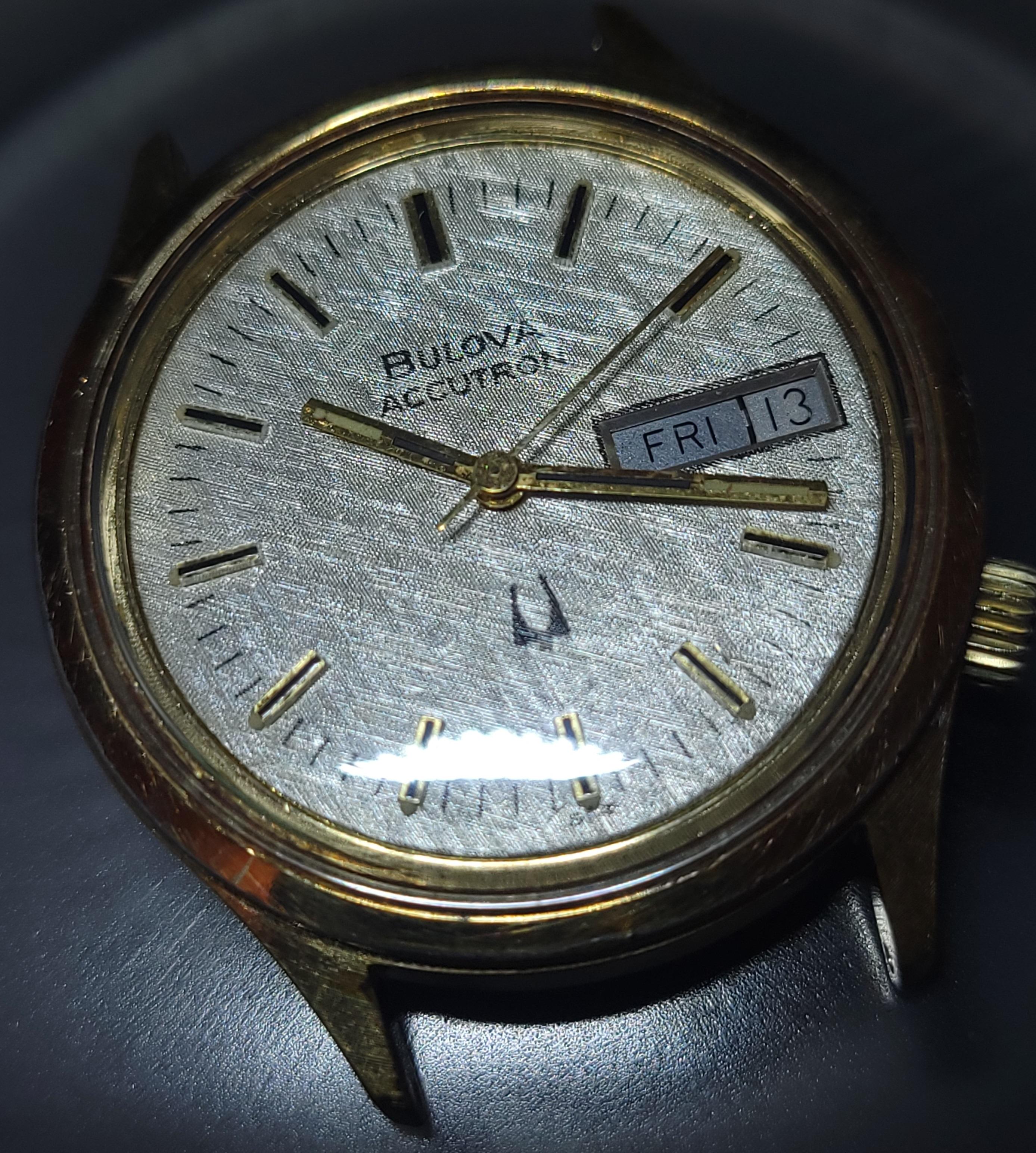

I've got a 219 that I'm playing with. When I hook it up to the 700 test set, it pegs the ammeter, so I'm trying to determine if I need a new coil.
I first determined that the previous owner had screwed the battery strap to the main plate, causing a dead short. After I fixed that, it still doesn't run, regardless of how much tapping I do on the side. The ammeter needle stays all the way to the right.

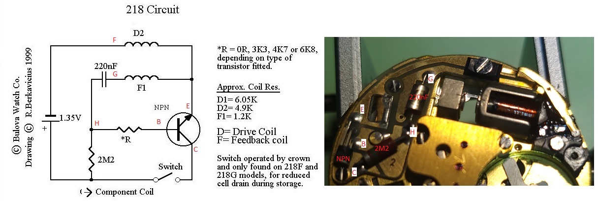

So assuming they just removed the cell coil and left the rest of the circuit the same, this is how I matched my 219 to the schematic:
I was measuring between E and G, so across F1. 900 ohms makes a little more sense. I'll try tomorrow between F and E. To tired and too much Scotch to do more tonight 🙂

Looks like my hunch on the schematic was correct; I was measuring the phase/feedback coil.

Okay, according to my DMM, the drive coil is reading 12k ohms, and the feedback coil about 900 ohms. Which seems high and low, respectively, based on what we'd expect for the 218 movements.
But at least we know the coils aren't open, and maybe they wound the coils differently for the 219, so:

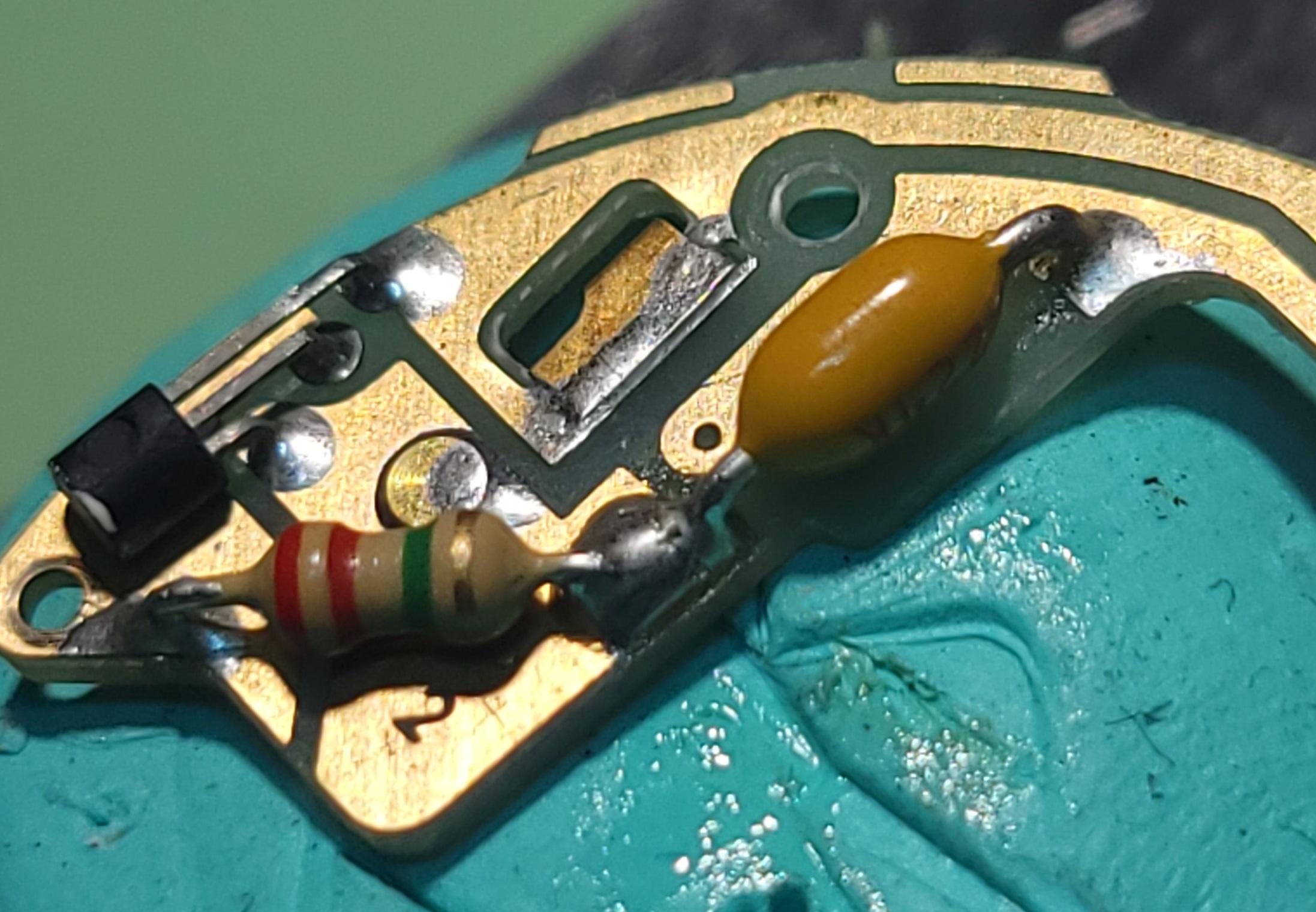

Update! Treated myself to a new DMM that tests capacitance, as well as a resistance range large enough for the 2.2M ohm resistor.
The capacitor reads 0.05nF, the resistor 3.2M ohm. I've got replacements on their way from Digikey.
It worked!
I measured the new cap and resistor to make sure my meter wasn't the problem, and they were 220nF and 2.2M ohms, as expected. I did have to open up the holes for the capacitor's leads slightly with the smallest drill bit I had (0.026", #71), and I didn't snip the leads short enough, but otherwise it went together with no issues.

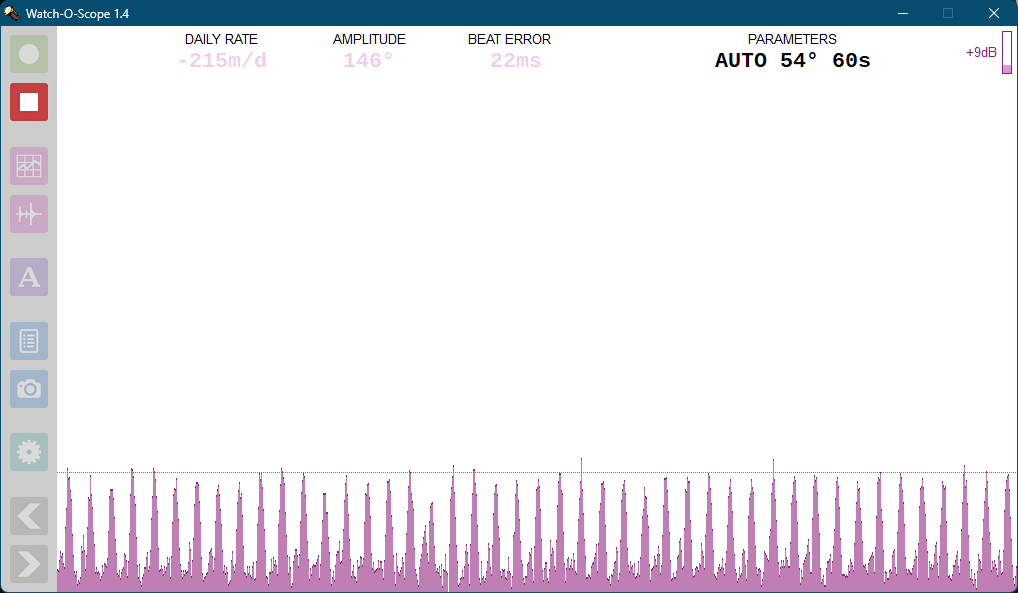

Popped in a battery and it's humming away! I tried to take a video but my phone camera won't pick up the hum or the vibration, so I popped it on my timegrapher's microphone. Watch-o-Scope has a nice mode where you can just view what the microphone hears:
I have the software set to the shortest sweep time it can do, which is 1/8 second. So if the fork is vibrating at 360Hz, we should expect to see 360/8 ticks: 45.
And what do you know, I count 45!

Got the calendar works together last night, now on to cleaning up the case and sourcing a bracelet. The case is pretty beat up and may be an opportunity to learn buffing and plating, but for now I want to just get it cased up and work on my grandfather's 218.
Pictures coming soon 🙂
Cased up and running! Unfortunately, despite the crystal opening in the case measuring 32mm, I ordered a 30mm and 30.1mm crystal for reasons unknown.
The old crystal isn't a tight fit, so I still have to replace it, and find a nice bracelet. But I'd say I can feel pretty good about it running strong after all the work I put into it.
