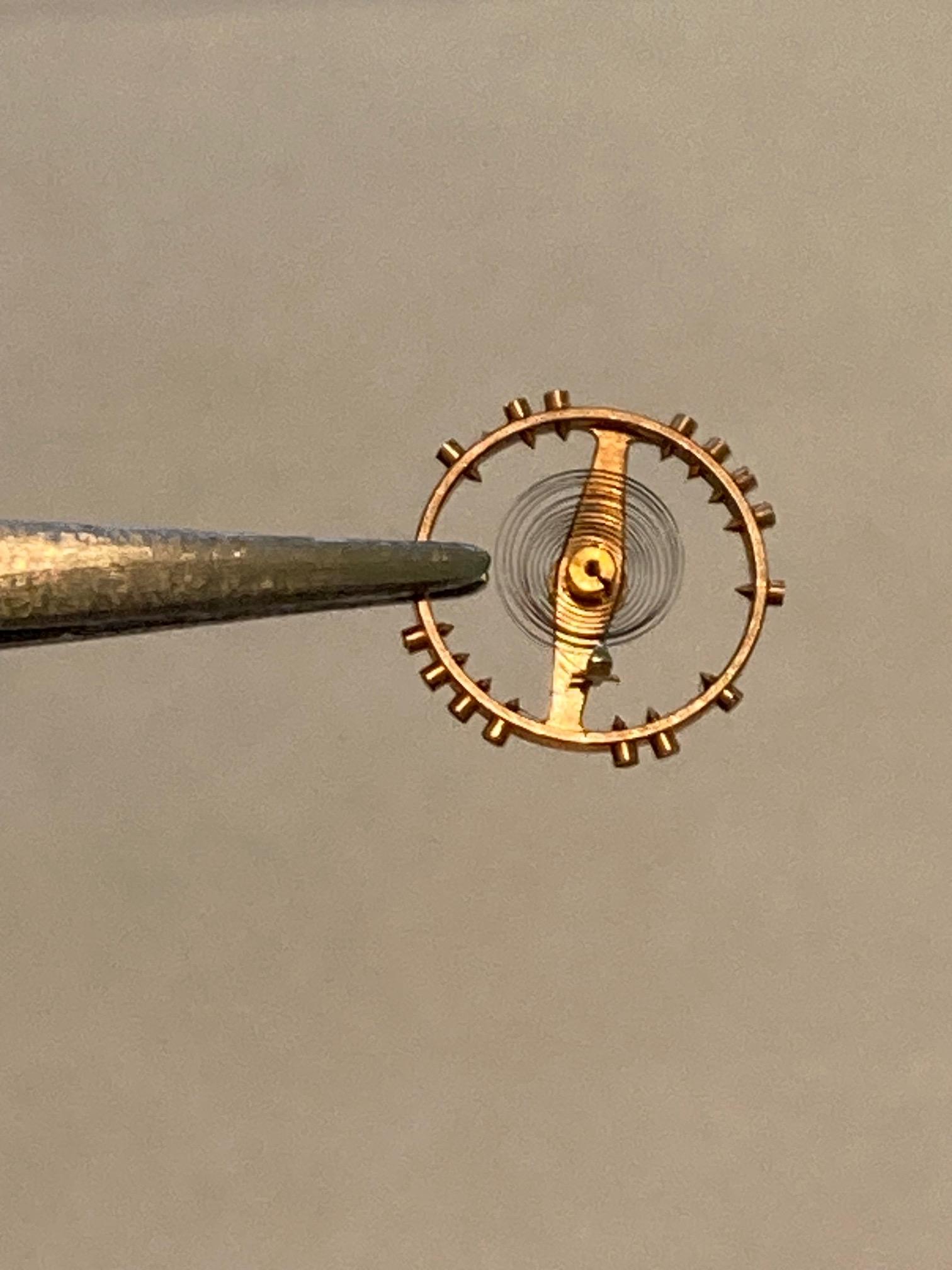

Update on the Omega.  I was able clean, lubricate, and rewind the mainspring.  The watch is all reassembled.  The movement is running extremely fast now.  I don't have a timegrapher, but its around 15min per hour fast.  I have demagnetized the watch,  which did not have any affect.  Possible balance hairsping issue?
Providing the right hairspring is on the balance wheel, running fast means an issue with hairspring which commonly are the spring fouling itself, sticky spring, damaged/ tampered with spring....
Helps if you  show a pic of the coil preferably detached from the cock, or a vid of it as oscilator is running in the watch.
Rgds
When you're running that fast the timing machine will just tell us that it's having a problem because you're having a problem. But still timing machines are wonderful for diagnostics.
I see you're up to 10 messages on the message board so I popped over and read your introduction. A lot of times when people need help we will ask questions like what was the watch doing before you service the watch? In other words was it running fast before you disassemble the and now it's running fast or you have no idea it wasn't running at all? Then this is your second watch I believe and little tiny leaders Omega watches or any Omega watch isn't really the best second watch that you should be doing parts are dreadfully expensive and hairspring is on Omega watches tend to be easy to damage. Plus ladies watches present all kinds of interesting challenges.
As fast as you're running yes it's definitely an hairspring issue. Then as far as pictures go you did give us one at the beginning and it's a little bit concerning?
So we need a better picture preferably without removing the balance wheel first. Because typically when watches are having issues it's because the balance wheel is in the watch not out of the watch oh and I see your balance wheel has timing screws just make sure you have all of those in place. In other words if there's one on one side there should be one on the other Side they should always come in pairs as of this was a pocket watch that would be the reason to be running faster missing a screw. But I think more than likely if you look in you'll see your hairspring isn't flat or isn't centered or isn't where it's supposed to be.

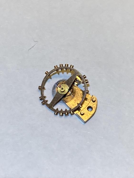

Here are pictures of the balance assembly.  Don't know why but the regulator arm decided to come off.  Uuuugh, I may need help with this one.
With the regulator off allowing the spring to have full motion it it still running at 53 seconds per dial minute.
This picture eleminates just one of all possible causes JohnR listed ie;  NO MISSING BALANCE SCREW.
 Regulator arm is made of spring so it snaps back on easy, best to detach the balance complete from the cock, there are two advantages to doing that.
1- We can then see hairspring coil to check for concentricity, levelness, flatness.....etc.
2-Lets you  keep the balance complete out of harms way as you try to refit the regulator arm.
Looks like the hairspring has some issues,  Not concentric to the pivot at all.
I have been looking for a replacement Omega balance complete 250-1327 without any luck.
I have located a Renata 273 and a Ronda 1846 but I cannot find a catalog to confirm they will work.  The description in the ads for both say 13.5R movement but not the R13.5SC or 250.
