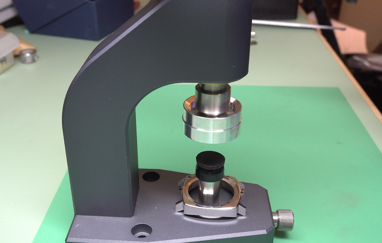

I have just got a crystal press and following instructional videos i cannot seem to get the hang of it.  Its a high dome crystal and .02 bigger than the hole and it wont press in. I managed to get it in with the claw type but it leaves marks on the crystal due to the pressure and i dont want any marks. Does anyone have any tips. I have steel and nylon dies.

The walls on the acrylic die are angled, not straight, correct?
correct but the 0.02mm is proving an issue centring maybe and i cant get it to compress

And the lower die is a domed die, not the kind you are showing in the photo?
Both are domed. Ive tried every bottom die and the case is centre to the top die but the crystal doesnt just sit in the hole due to the 0.02mm from what i can see. The pressure I put down just causes it to break when i think i have it centred.
1 minute ago, GuyMontag said:
That aluminum die you are showing isn't a domed die. It should look like this:bergeon-bakelite-dies-set-5500-Ephoto2__58608.thumb.jpg.9a729d8dc2c17fb0e752416d554595a5.jpg
Potentially i am using the wrong technique then, apologies i am new to replacing high domed crystals. From what ive seen, I put my watch case on the bottom die and then the top die should just over hang the outer of the domed acrylic and then compress it into the case bezel.
If this is wrong what technique should i use?
For an acrylic crystal it should look like the below. You place the crystal on the lower domed die, bring the upper die down to the crystal and compress it slightly, raise the watch case and compress the crystal slightly until you can feel the crystal click into the case and then while maintaining a slight upwards pressure with the case, back off the upper die.
I glued one of those felt things that goes on the bottom of furniture to the domed die so it doesn't scuff the inside of the crystal. If your press takes the M6 style that screw on, Cousins sells the Bergeon bakelite domed dies individually. I only bought the 14, 16, and 20mm dies and those have worked for me so far.

Looking at the dies in the first post I took for granted you were trying the press in an armoured watch crystal (with a tension ring on the inside of the crystal). In that case, your dies were the right ones to use.

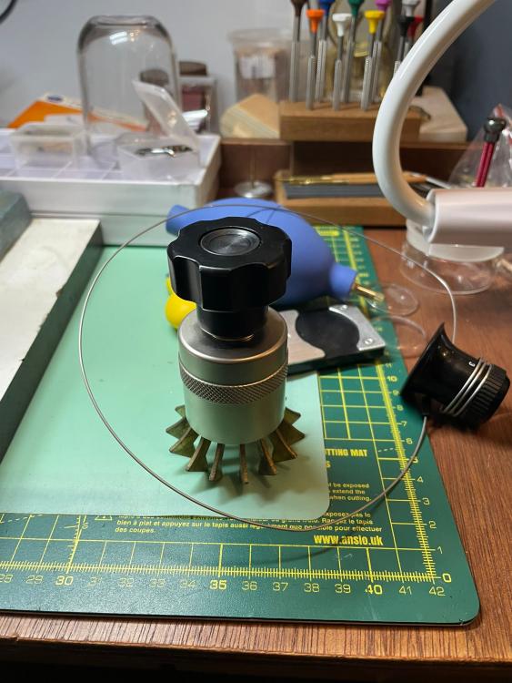

In this video, I show how I do it.
Anyway, for a non-armoured watch crystal, the method described by @GuyMontag is the way to go!

For acrylic glasses Sternkreuz recommend 0.2mm to 0.5mm larger than the hole, but this depends on the size of the crystal. I use the Bergeon claw tool and usually use 0.2 - 0.3mm larger diameter.
