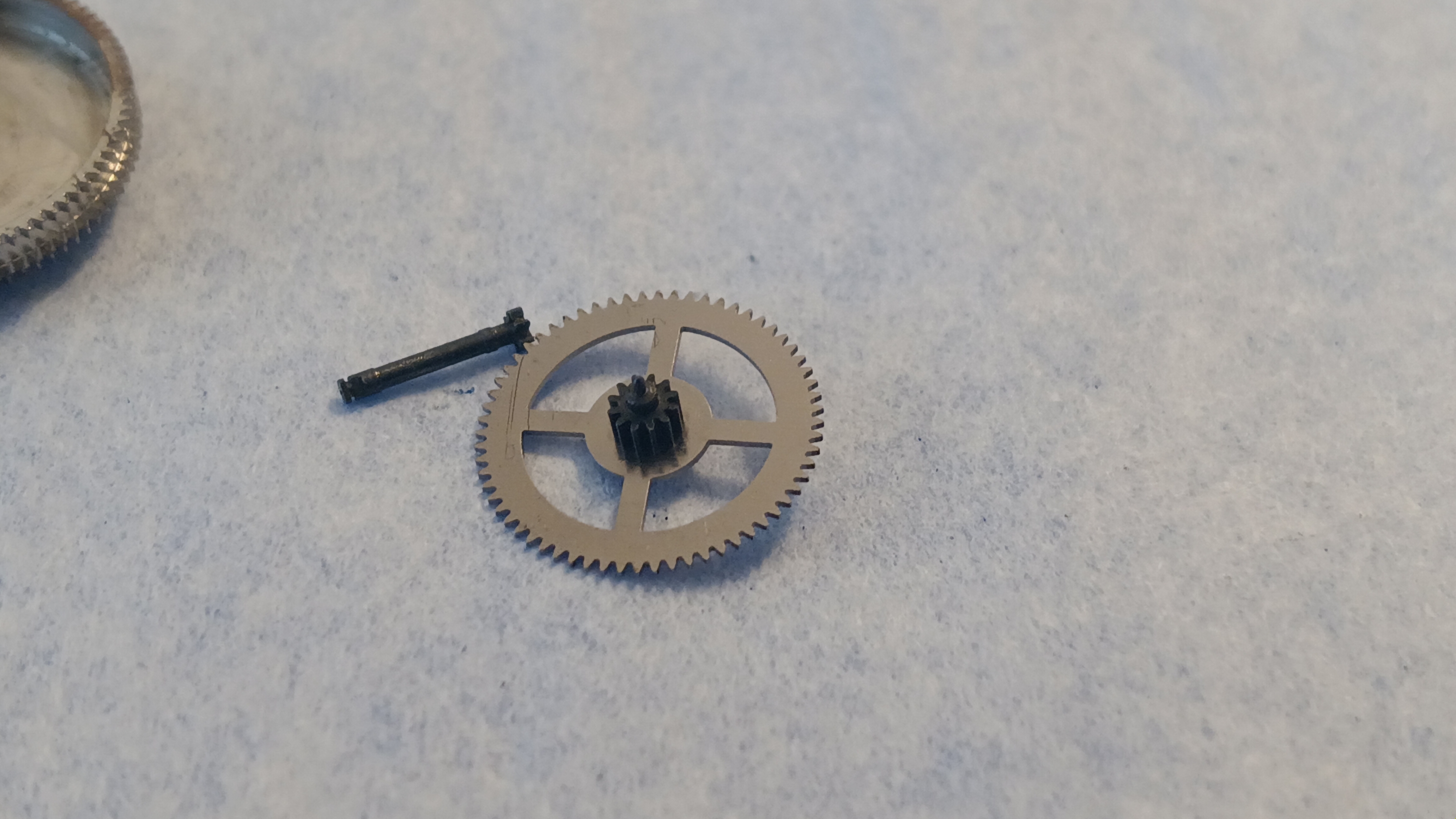

Here is an example of a setting wheel and a date corrector operating lever from an ETA 2892-A2 that has been discoloured by using vinegar.
Great pictures.  I'm seeing exactly the same thing.  Strangely, the black discoloration is not uniform.  I work on Timex watches almost exclusively.  After soaking, their gears are still shiny, but their pinion leaves turn black.  If you look at a non-rusted Timex, the pinions are already a different color from the gears, like they're made of different materials, and the pinions are always the ones to rust.  So I'm thinking maybe the pinions are made of carbon steel, whereas the gears are made of stainless steel or zinc-plated or something.
Regardless, I want to try to find a way to loosen the carbon.
Part of the problem is that the carbon is really on there.  Your fingers will get a little dirty if you touch it, but you have to scrape to get it off.  I had hoped that the ultrasonic would get it off, but I tried that to no avail.
I did see a product called Carbon-Off that's used to dislodge carbon from cookware and machinery. Perhaps a light soak in that would loosen it enough that the ultrasonic could do its work.... or it could destroy it entirely... who knows?

Hi folks... Just wanted to add my own experience with evapo rust.  I recently had a center wheel with a fair amount of rust on the leaves.  I used a sharpened oiler and a fiberglass pen to carefully pick off as much rust as possible.  I then soaked the wheel in full strength evapo-rust for 10 minutes.  Removed it, rinsed it in distilled water, then put it in distilled water in the ultrasonic for another 10 minutes.  Dried it in my parts drier.  The result was a rust free part with the typical grey carbon color.  I was able to polish off the grey coating with the fiberglass pen and a silicon polishing pin.  In the end, the leaves are a bit pitted but the part is clean.   Unfortunately I did this before I found this thread so I don't have any photos to share.
