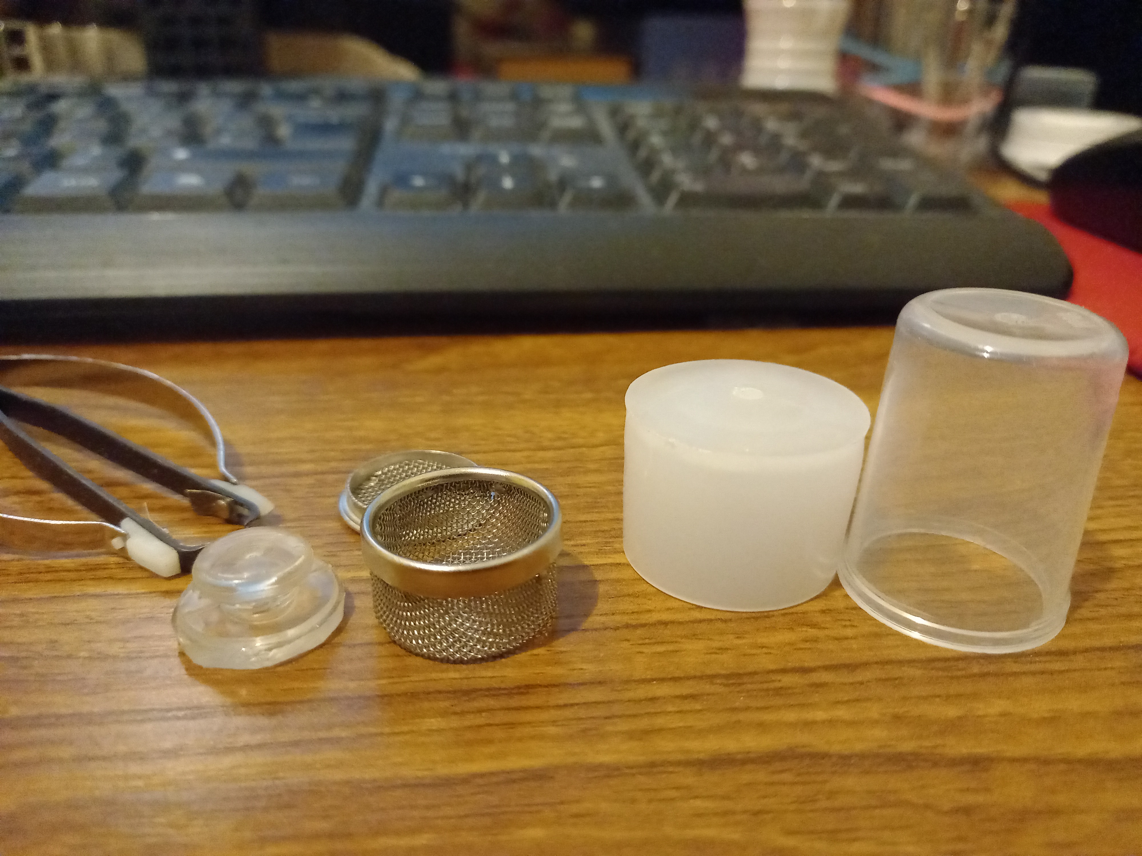

A tip from Chronglide which I made myself. I cut the outer edge of a mirror suction pad small enough to be placed on top of srprings in a basket. It stops them from floating around with the action of the ultrasonic. Note, the other plastic tops are from deodorants. Made a hole in the tops and they saved me the purchase of mainspring barrel press.
