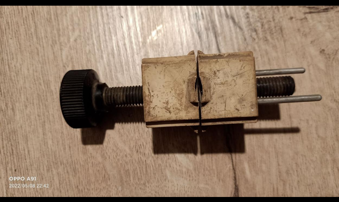

So I was looking at the local website for a new project and found this movement holder which cought my attention because I've never seen anything like it before not that I'm an ex0ert and seen everything but it's interesting nevertheless.
What do you think about it? Is it worth buying?

Hi Its a recognised brand (Favorite) swiss made. I have see some Rolex ones that are similar going for silly money, so it depends on the asking price.
It's so cheap, less than $10, but what do you think about the condition? can it be restored?
1 hour ago, watchweasol said:
T that price its worth a shot, as for restoration a good clean and lubrication would make it look a lot better
Alright I bought it, I'll update once I "restore" it.
On last question, what kind of lubrication should I use? I think some oils are bad for plastics.
I don't think it's actually a movement holder, rather a case holder. The different width tabs on each of the 4 faces correspond to different strap lug widths. You install the watch case face down using the appropriate side and adjusting the thumb screw so that the tabs fit between the strap lugs. The whole thing then goes into a bench vice and holds everything nice and solidly so that you can deploy a case back wrench with both hands. Helpful for avoiding slipping wrenches (and the associated damage) especially with tight case backs.

I think you're right, it doesn't hod the movements well and it's not stable n the bench it self but I didn't think it's a case holder I just thought it was a terrible movement holder.

Not sure about that marc. Look at the curved profile that fits around the movement also a shallow curved rebate. I would have expected the tabs to be square and deeper. If so a poorly designed one.

It looks like its made of timber.

I have a few holders, the one to the far right bottom is what i use a lot of the time Ammar. Its an adapted  jewellers vice, the wooden inserts are pegwood and can fit into a variety of holes to suit the movement. They grip really well without damaging the movement and its heavy so it only moves when you want it to. I use it a lot to hold the barrel when hand fitting a mainspring. I think it was around 12 quid so 15 bucks ish. The back two are really only good for something big like pocket watches, the left is a Japanese MKS the right a Rolex oyster, a little cumbersome Imo especially the MKS.The middle one a cheap bergeon 4040 style not keen on those they dont feel particularly stable i only use this for holding dials and the bottom left a Bradux that will go up to a 12 ligne this one isn't bad  actually quite stable

It's made of some sort f hard plastic, it's surprisingly heavy for its size.

That's an impressive collection, I have to admit I sometimes put the movement in one of those plastic case holders they hold the movement securely without damaging it.
