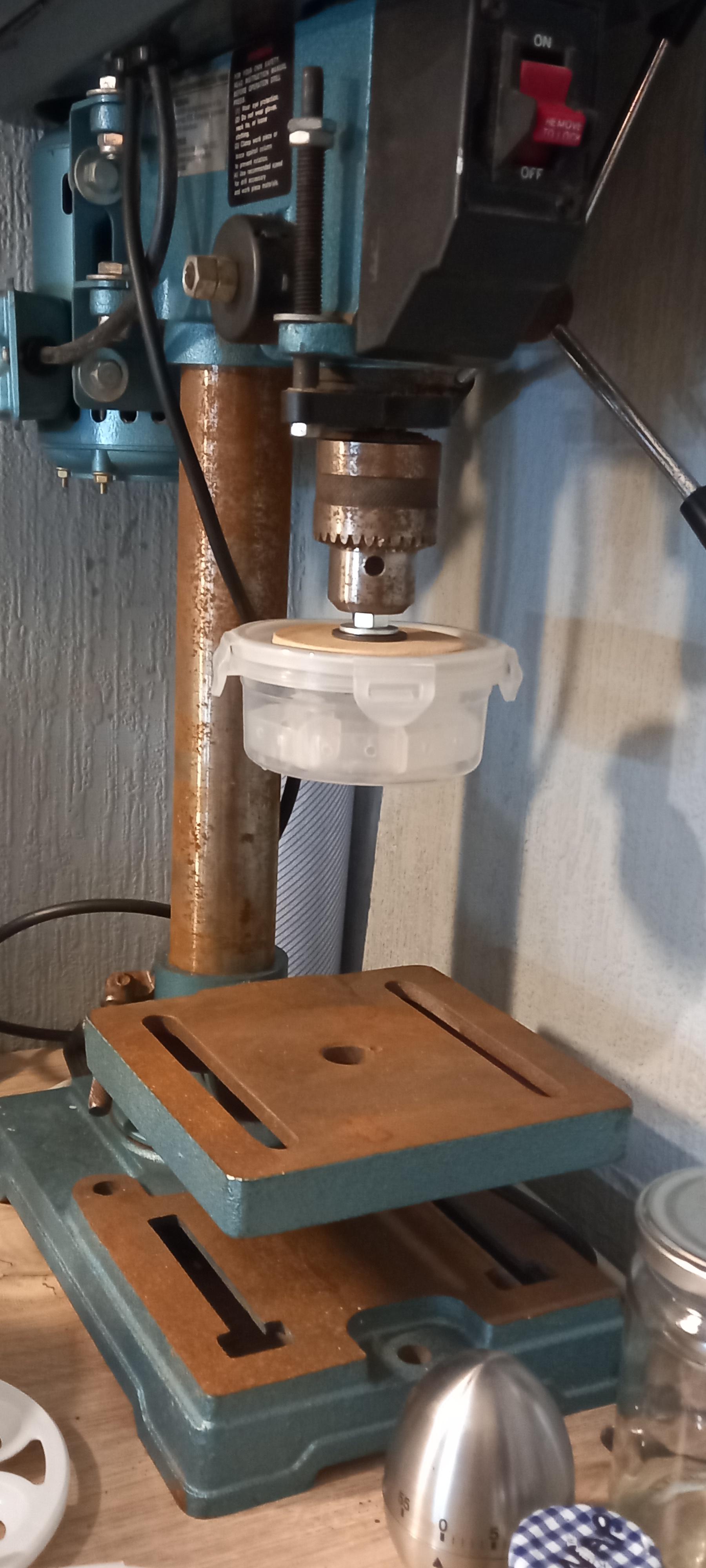

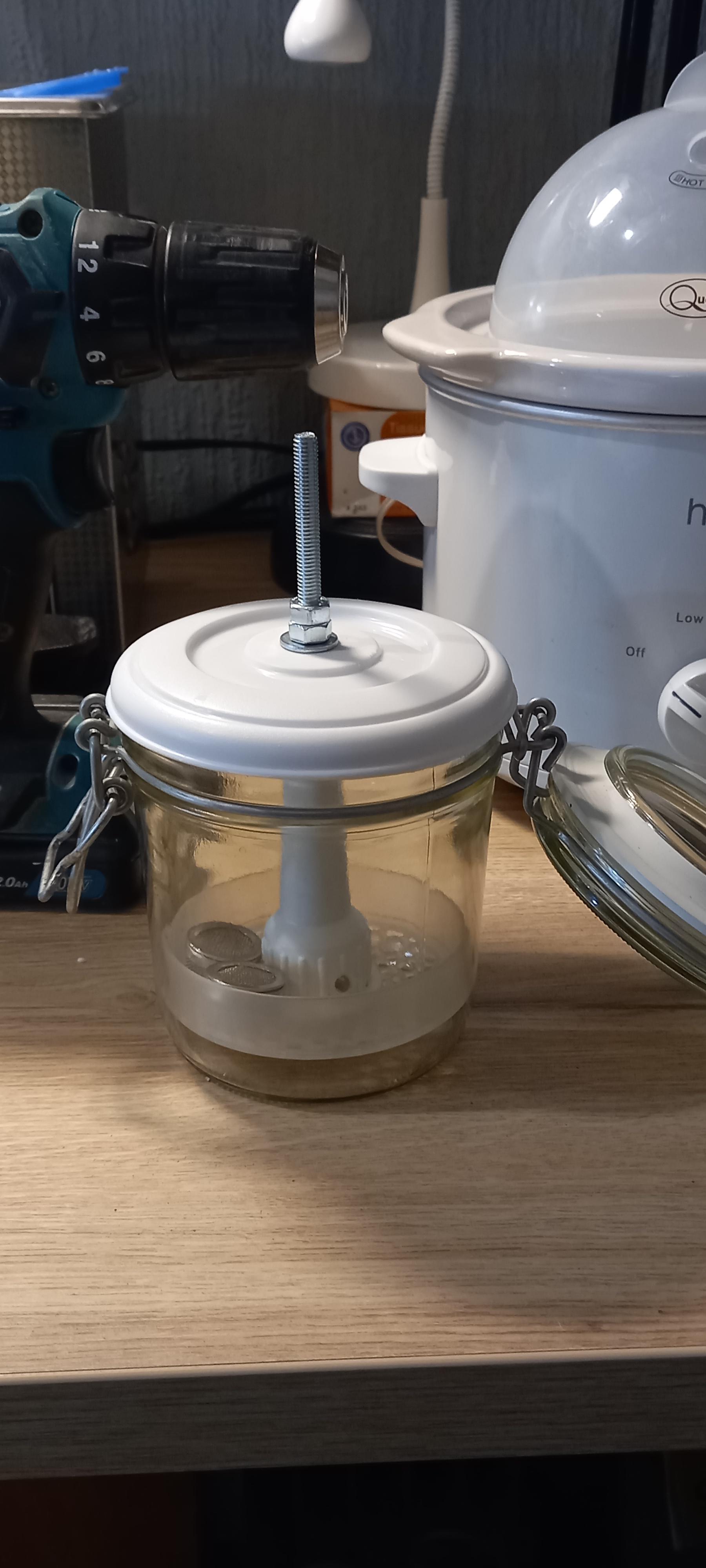

This is an update on a diy cleaning machine i made a while ago. Been using it a couple of months  now and its ok and it cleans well, but i was bored this evening and decided to make up something  cheaper still and that could be a useful little gadget when you want a quick hassle free clean and maybe something beginners on a budget could try. Its a little adaptation to # Its about f--king time's # little invention he made at the same time i made the big one. I was going to go the same route  but then decided to go big. And our Gerty ( soz matey lol, love you loads of course you know that ) directed and inspired me to have another little play. Here are some photos, and a bit of info as to what i used. The first is a pillar drill, this only spins one way and rotates the basket along with the fluid so not loads of agitation created, but the insert for the tray does stir things up quite well. And then this evenings,  made up of some kitchen and shed bits. 1 glass jar with rubber sealed locking lid to prevent evaporation when not in use.  1 agitation mixer insert from a protein shaker. 1. Plastic lid from a tuperwear tub to prevent any splashing. 1 mastic tube nozzel . And 1 . 6x150mm bolt with washers and nut. Total cost about 4 quid. Pros over the pillar drill, small and neat so good space saver, rotates both directions when used with a cordless drill and the basket spins independently of the fluid so much more agition created. Cons you do have to stay with it and operate it manually unless you wanted to rig up a frame to hold the cordless drill. Obviously other cost incured is the cordless drill, but everyone has a cordless drill right ? Even my kids have one, i had 47 of them at the last count. 🙂. My recommendation would be to let the watch parts soak for ten mins first to loosen up the tenacious mank then give them a good swish around backwards and forwards for a few mins. Repeat if necessary. Enjoy playing and inventing. I'd love to hear about any other ideas 👍

I have questions about the set up illustrated in your drill press.  How does the container holding the solution keep from turning while sealing?  What RPM are you planning on turning that at?  Without the outer container resisting the motion of the fluid there will be no motion relative to the watch parts inside (they will all move together, with the fluid).  Some surface details or texting in the outer container would help by adding some turbulence but will also make it harder to clean.
Hi Shane, the pillar drill is a different action to the small version. The whole container spins along with the fluid and baskets . Hence the agitation isn't as good as it could be but still works ok. The small one would work in its place when i have time to make a frame to secure the container.
I was thinking of offsetting the spindle attached to the container to create turbulance but then came up with the cake mixer as a better idea

Looking at your idea has given me another thought as regards to a rotary machine. In a conventional cleaner the baskets are spun along with fluid ( when the fluid catches up to speed ), this is why a reverse of the fluid is needed to keep turburlance active.  If the baskets were   held static then a reverse of the of the fluid is not required. So if the fluid is continually  passing over the parts that should provide a good cleaning action should it not ?
Edited by Neverenoughwatches
I have toyed with the Idea of spray cleaning, where the parts are static and the fluid is continually sprayed over them  using something akin to an air brush set up or similar. Kind of like when cleaning engine parts in a paraffin  bath.  not done anything with the idea as yet but its one for the future.

This is an effective means of mixing and agitating a fluid.  I have even used it for cleaning particulate contamination from oil's.  I'll tell you because of your interest in cleaning.  Put enough water in the bottom of a container of oil to cover your air stones.  The container should have proportions more of a column then of a pan.  Since the bubbles are formed in the water and then traverse into the oil, a thin membrane of water still exists.  When the bubble pops at the surface the water droplets collect or adhere to particles, pulling them down on the return trip.  This is better for organic particulates, as well as others gust above and below what is economically viable to filter.  At some point the participants are to small to remove this way and are way to small to filter.  The next and best step is gravity settling.  Anything not removed by this point is probably a very fine mineral or metallic substance (or fine drop of water) and is denser then the oil.  It will sink to the bottom over an extended period of time.
That being said, without the trap at the bottom to hold the contamination, I think its addition to mechanical washer might keep more of the finer particles in suspension, not allowing gravity to remove them.  If it's your only way of agitation, we do what we need to do but I don't think it's necessary to add to a mechanical cleaner.
The proof is in the doing.  If you try it, let us know how it works.

Hi  Step two was to have a mesh base with a trap at the bottom and a filter (coffee filter paper) on top of the mesh to collect the dirt, that way with a second filter the fluid could be re used. These are still in the thinking stage and not been drawn up even, just food for thought.
