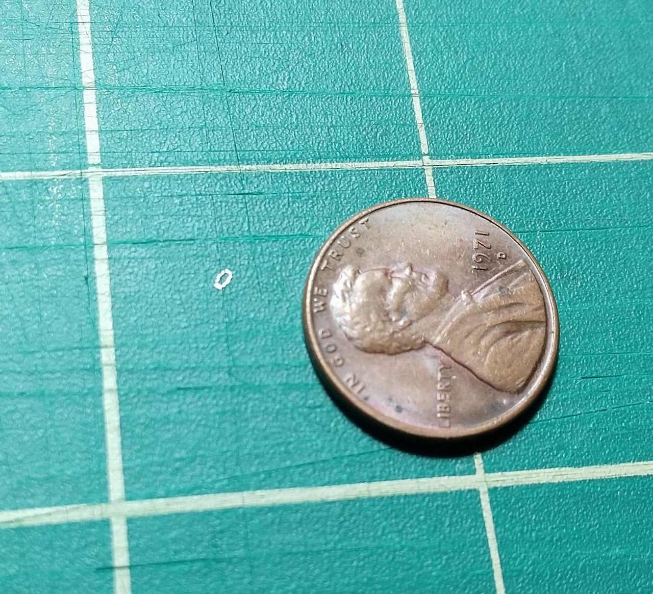

This goddamned thing.  A_curse_on_the_inventor_of_this.thumb.jpg.df50e1f5b734a067a726344354e96489.jpg
I am now over 4 hours trying to get this thing set and I just can't do it. I'm not completely terrible with tweezers  but it seems like people exclusively set these things with the TINIEST tipped #3 tweezers and my number 2's just don't seem up to the task...maybe they're not dressed correctly but they look like most number 2's i see in use and I would rather not have to drop 80 dollars on two pairs of #3 tweezers for this ONE thing. The moment i hold down one end of the diashock it shoots the jewel out the other end, sometimes i fold the spring over it and it jut shoots it out the side.
I've tried the hollowed out pegwood tool (Works like a charm for the balance wheel setting. Worked only once on this and I can't duplicate it, plus the amount of wood it sheds is...concerning, i'm sure the oil on that wheel is contaminated with sawdust to hell from my dozens of failed attempts.), i've tried sharpened pieces of pegwood instead of tweezers. I've tried slotting it in one end first but the moment a tweezer comes into contact with the thing it flies off (I'm not losing parts anymore but it flies out of the setting.)
Any tips, tricks, advice, or maybe curses you can cast on the guy that invented thse #@&#$%ing things would be appreciated. I'm super excited to continue with this project and everything else seems to be going great but getting these things back in is just a total roadblock.
Do I just have to suck it up and "get good"? Or is there some hack or trick I'm missing.

The tiny shock springs on the train are not to be removed for service. I think that is mentioned in pretty much any walk-through or discussion about these mov.ts.
As you noticed, pegwood is too soft for them. Only a small plastic tube might work. And if you use something too hard, the spring will break if excessive force is applied, as it happens when taken by frustration.

You didn't said it, but what you're are the swearing about about are the tiny shock spring on the train, that are not to be removed for service. I think that is mentioned in pretty much any walk-through or discussion about these mov.ts.

Because the smallest the part, the less tolerance for non-optimal factors. In other words, you need to have exactly the right tool and technique, otherwise most attempts become futile, or yeld marginal results.

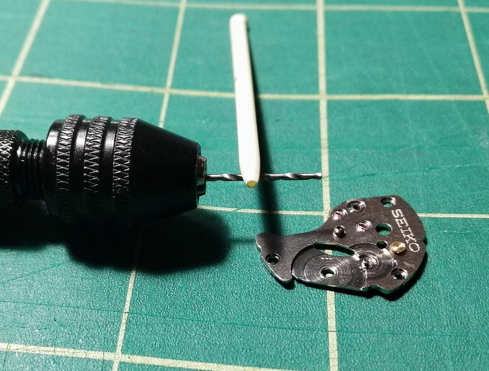

I bought a 6 dollar cheap  pin vise hand drill from amazon, for the small ones peg wood doesn't work, I found an old plastic knitting needle my mom had and cut the tip off and sanded it down flat but rough. The pallet stone is about exactly a 1mm wide, drilled a 1mm hole in the end and VERY carefully shaved the outside down with an xacto knife to get the wall exactly the right width of the setting slot so that you could put it in without the jewel in and push it side to side and it won't slip out. I thoroughly rodico'd it and it still took many tries.
If anybody is struggling with these and doesn't have proper tweezers or skills try this.
