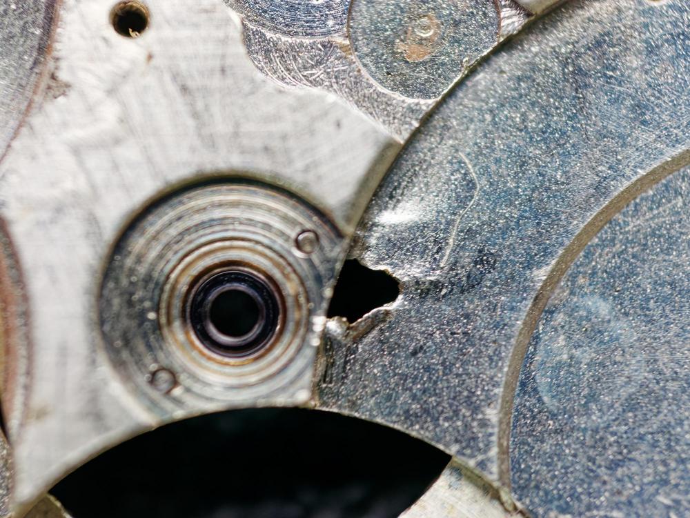

First off, what would cause damage like this? Under the barrel.
Is it worth trying to file out? The area above the tear with the line around it is buldged up, slightly.
Or should I look for another movement?
I don't think this is the original Elgin case, although it is a pretty nice one. So, it may be something someone threw together to sell.

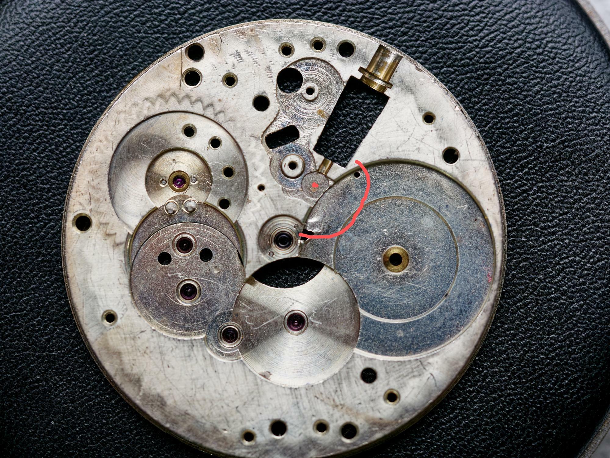

What ever happened, I don't think it happened from this side.  The plating under the barrel isn't even scuffed.  What does the other side look like?
It might have been caused by Elgin themselves when they machined the pocket for the minute wheel on the other side.

If that's true, I don't think it's very common.

if you assemble the mainspring barrel and rotate it does it stick up far enough to touch the barrel? Does it affect anything at all other than making for an interesting conversation piece?

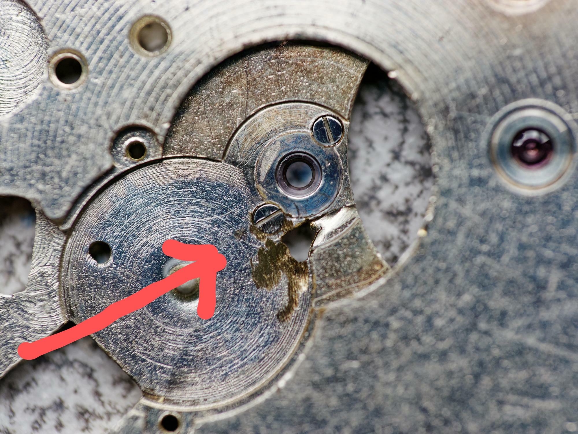

It does look like a very small diameter rotating cutter was used to address that screw head coming in from this direction.  As the cutter continually climbed across the brass doing more harm then good.  It chewed through the thin brass in that spot, grabbed and quickly dug in, folding that detail towards the barrel (probably snapping the tool in the process).  That screw was probably interfering with the minute wheel after an attempted repair and this felt like their best course of action.
They probably sat shaking their head for a while and never tried that again.
If it worked for the last fifty years in that condition, there's no reason why it shouldn't continue to work and replacing it won't magically add an otherwise complete serialized watch movement back into the world.
I'd put it back together unless I had an another complete serialized movements that just happened to need everything else transferred over.

I think Tammons and Shane probably hit upon the explanation.  Looks like some fellow had an idea about how to address a screw causing interference, then quickly learned what made it a bad idea.
It should work if you clean it up in that area as best you can, and reassemble.  If it functioned well before, then it still should.  The only real concern in that case is aesthetics.  Only another watchmaker might see this, and I could understand one being anxious about what the next watchmaker will think of him based on judging the watch.  But given how unlikely this scenario is - myself, I'd just focus on function with this one.
