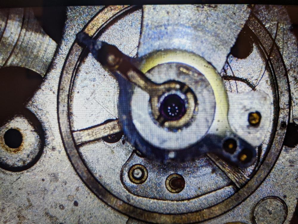

Ok I have reassembled this part. It still doesn't feel right. Here is a video of the keyless works in action. I also believe the hairspring on the balance isn't concentric. I guess I will be reviewing marcs course on how to address this situation.
Here is a short of the balance in action on the old main plate.
https://youtu.be/3z4uDOxqutU
It appears to be working correctly. How does it not feel right? Is it tight or rough?

Alright I finally got a new ratchet wheel in as well as a donor balance. The donor balance had a broken pivot but the hairspring looked ok to me so I switched it to replace the original. I believe I am ready to re assemble this thing. I was thinking about doing a post on the reassembly but wasn't sure what specific steps would be valuable to anyone. Should I do a re assembly post?
