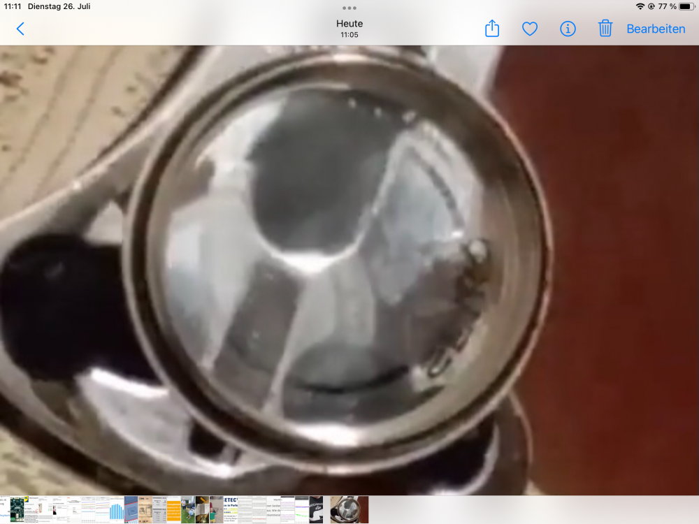

In my opinion the o-ring is held and centered by the threaded rim on the case back. It seals against the case in a chamfered recess (pics a from a video). I might be wrong though.
Again, this watch like many others uses a flat gasket not an O-ring. Its inner diameter is the threaded dia. of the case back, same it would be for a snap-on caseback.
Said gasket inner diameter is the most important dimension of the gasket, the others being the outer diameter and thickness. In case of flat gaskets these two may vary, but clearly are in a fixed relationship when it comes to O-rings.
