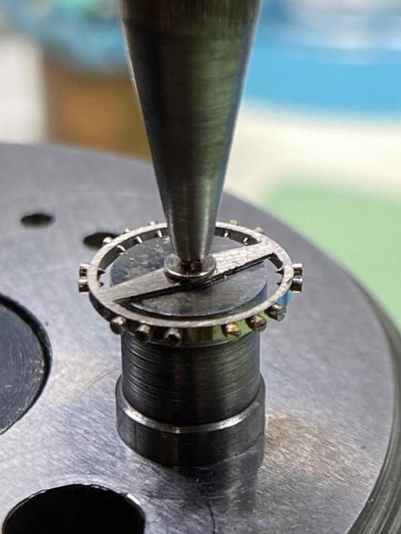

Hi, I have been working on what has turned out to be a larger project than expected and have learned a lot.  But I am pondering what my next move should be.  Your advice would be very much appreciated.

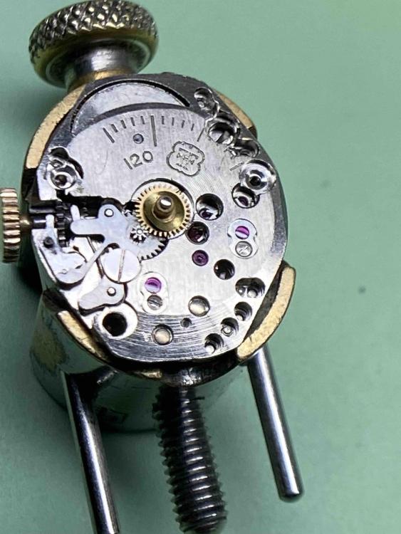

The watch is a Charles Aernie manual wind ladies watch.
Movement: FHF (FONT) 120, 17 Jewel  Fontainemelon SA. plate size: 6.75 x 8 ligne,  Rate: 18,000 bph
Things I have repaired on this watch so far include:  Broken Setting Lever spring (and the broken piece was wedged in the wheel train), worn mainspring, broken balance staff, bent balance spring, loose balance spring collet, trued the balance wheel using calipers, balance wheel out of poise (needed to add a timing screw).  I cleaned, reassembled and lubricated the watch and it ran fine sitting on my bench overnight.  Went to adjust timing next day and it is all over the place, runs in pendant up/down/left/right but totally stops when it is dial up (not very convenient for the owner).  Timing is erratic, increasing and decreasing and sloppy beat.

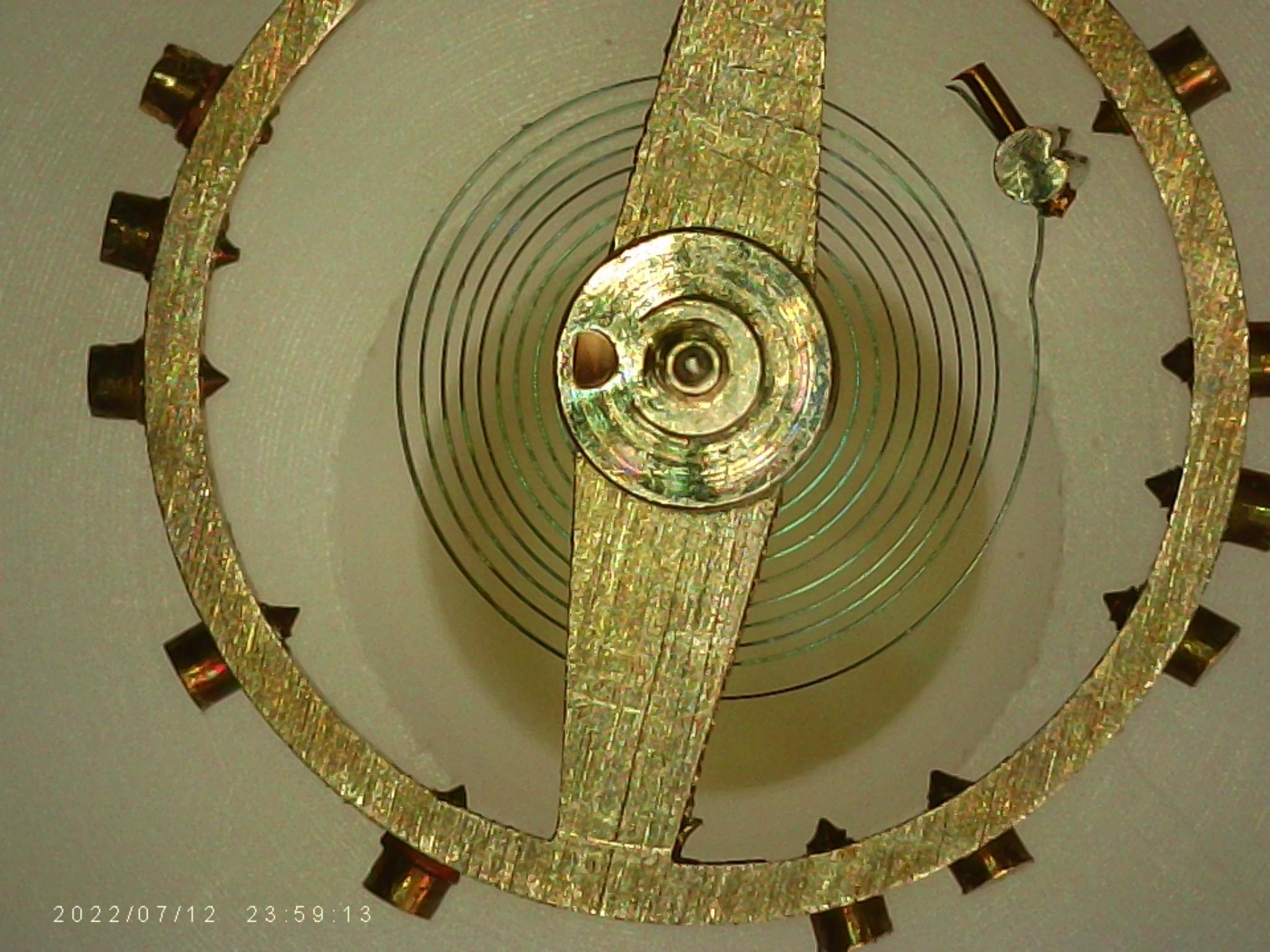

I went back and reviewed the watch further. The top set of jewels look ok, with the end cap not showing any pitting.  The obvious problem I knew beforehand is that the lower balance jewel has a chip in it and needs to be replaced.  (The picture was taken when I found the old pivot wedged in the oil well).
The balance complete looks fine and does not appear to be rubbing against anything.  The balance spring is sitting flat and doesn't appear to be catching on anything.  There is a fair amount of endshake so I would like to tighten the balance up a bit.  The rest of the wheel train seem to have reasonable endshake except the center wheel which has no endshake.
The bottom of the balance looks ok, with the impulse jewel solidly in place with clean edges.  The impulse jewel height goes almost up to the safety roller table so I think it is high enough.  Brand new balance staff so pivots look fine.
The pallets appear to have enough drop on either side.  There doesn't appear to be much endshake in the pallet fork.  Need to clean pallet fork again to remove excess lube.
The pallet fork horn and guard pin seem to be ok and straight in both vertical and horizontal planes.  The banking pins look straight. Not entirely sure how to check if the guard pin is too long or short since it is very difficult to see inside the small enclosed area.  Mr De Carle suggest putting some jewelers rouge on the end of the guard pin and look for marking on the roller table later, so I might try that.
The last two watch images show the actual foul in action.  The first shows that the impulse jewel has jumped on top of one of the pallet horns.  The next image shows that as it passed to the wrong side of the pallet, it pushed the pallet fork back to the opposite banking pin.  At that point the watch will no long run.
My question is what steps can I take to fix so it doesn't stop when I turn it dial up?

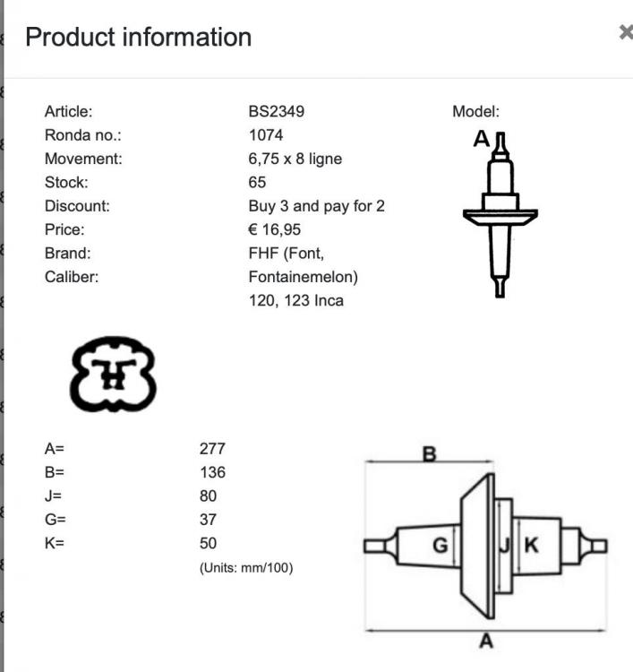

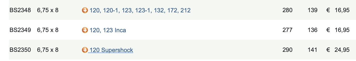

Which staff did you use to replace the broken one? I see 3 options on balancestaffs.com.
The obvious fault I see is the roller table has been crushed. The safety roller should be in line with the guard pin, and below the roller jewel; it very well could be that in dial down it is sort of doing its job, but likely rubbing, but in dial up with the endshake on the balance it moves away far enough that there's zero safety action and the fork moves to overbanked condition. I would replace the roller table and see how it runs, if there are still issues related to the balance endshake then address that.

I never knew about that balance staff website, but will remember it from now on!  I have a cache of new FF120 parts so didn't bother looking it up to find that there were other  potential sizes.  I measured the staff and it is 2.77 mm long.  So I guess I could try the 280 mm size to help reduce endshake  a bit and maybe not have to push the jewels in?

I guess this is why there are different overall lengths among balance staffs for the same movement.  Set up must be all in the part selection.  I would think the staff should be shorter than the assembled thickness of the main plate and balance cock (without the capstone on the cock), minus the depth of that pocket and acceptable allowance for end shake.

As an update, I replaced the double roller and that has resolved the problem.  The watch no longer stops when it is in dial up (or any position).  Still need to deal with cracked lower balance jewel (find the right sized friction fit olive jewel),
increase endshake for the center wheel and replace the mainspring, but the major roadblock has been resolved.   Thank you very much for providing a fast solution to my dilemma!
By the way, I am now pressing the roller table in instead of trying to "gently" tap it with a hammer!  Way safer 🙂
I can watch the gap under the roller table close as I gently press down on the handle.
