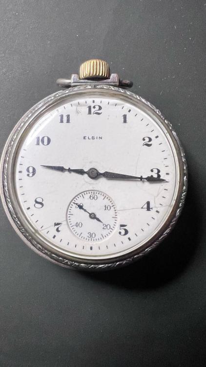

Hi there.  I'm new to watch repair.  I'm in the process of going through Mark's course which I just love.  I got hooked on this by watching Marshall on Wristwatch Revival on YouTube.  He was the one that suggested Mark's program and i'm so glad I did.  I have my Unitas test movement which i'm in the process of stripping down and reassembling and I have invested in some tools (Much to the shagrin of the wife I might add).  I also purchased an old Elgin Pocket watch off of EBay which i'm going to attempt to repair.  There's a good chance i'll be posting back on here when it comes to ordering parts for it.  I don't have a mainspring winder just yet so i'm either gonna have to attempt it by hand or try and buy a new spring if I can find one.
Me too. Have you opened it yet or did you just get the movement? Do you know what grade your movement is? My first (and second) were grade 313. It did finally have life however I had cobbled it together by attempting to use components from the second movement and they aren't 100% compatible. I learned a lot. I've got the Elgin Material Catalogue and portions of several other grades.

I have removed the rear case cover to take a quick look.  It's a grade 291 made in 1927 according to the Pocket Watch database.   It's in fairly good shape with the exception of a little dirt and a very small crack along the lower part of the dial.  I bought it as a non-runner so it will be my first movement to actually pull apart and try to repair.  My only issue right now is I don't have a mainspring winder as of yet so I either have to try and find a new spring, find someone local to me that has a winder who can rewind it for me or try to rewind it by hand which im reluctant to do.  Mike on My Retro Watches has a video on how to do this but I know it's not good practice.   What are y'all thoughts on this?
Finding a new spring is easy however for a pocket watch it isn't going to come coiled up at the right size to just pop into the barrel (at least mine didn't).
If the mainspring still works you could: a) ignore it, b) wind it by hands or c) purchase an individual mainspring winder of the correct size.
So, here's the question: what are you planning to do with this  100 year-old watch when you're done? If it is just going to go into a drawer how critical is it that you have a brand new spring in it? If on the other hand you're planning for this to be the first of a 100 antique pocket collection maybe you should think about replacing the spring and buying the winder?
I ended up trying to find a single winder of the correct size and didn't have much luck so I hand wound it. My thought was that I likely wouldn't use the watch afterwards and that it was a practice piece that didn't have to be perfectly restored. Hand winding isn't hard and while handling the spring can cause bends it won't damage the spring enough that you'll end up worse off than you are now.

Your mainspring p/n is X817 and it is 0.008 strength. You can get one here:
https://www.ofrei.com/page298.html
or here (you'll need to match the thickness):
http://www.julesborel.com/home?search=elgin+%23817+mainspring

Excellent words of wisdom.  Thank you so much.  You are right.  Basically I was just gonna have it sit in a draw more then likely but the perfectionist in me was saying do it right and complete.  I think i'll take your advice and try the hand wind route and see how it goes.  Whats the worst that can happen right?  I screw it up and have to buy the spring anyway.  I do want to get it running though.  I want the satisfaction of getting a non-runner and getting it to work.  I'll keep you posted on how I make out.  Thanks so much for the help.  Oh, by the way.  I just completed level 3 of Marks course so now i'm gonna attempt some repairs and restoration.
