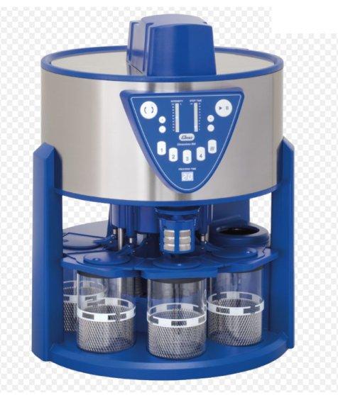

But you already have a microscope, so what else is there to spend your money on besides one of these:
What on earth are you going to do with 41 Seikos ? Are you some kind of ocd time dependent octopus 🐙
@gbyleveldt won't be able to reply for awhile. He'll be too exhausted winding them up. 😉
I’ve already explained my foolproof method at how to sneak new toys into the house without the missus realising. I suspect that that would be a stretch for even me with my impressive skill set.
