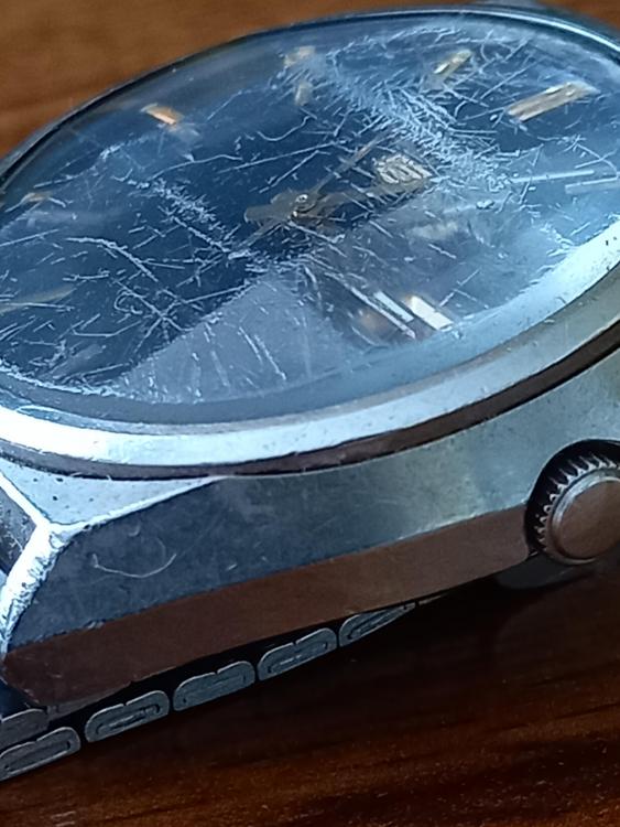

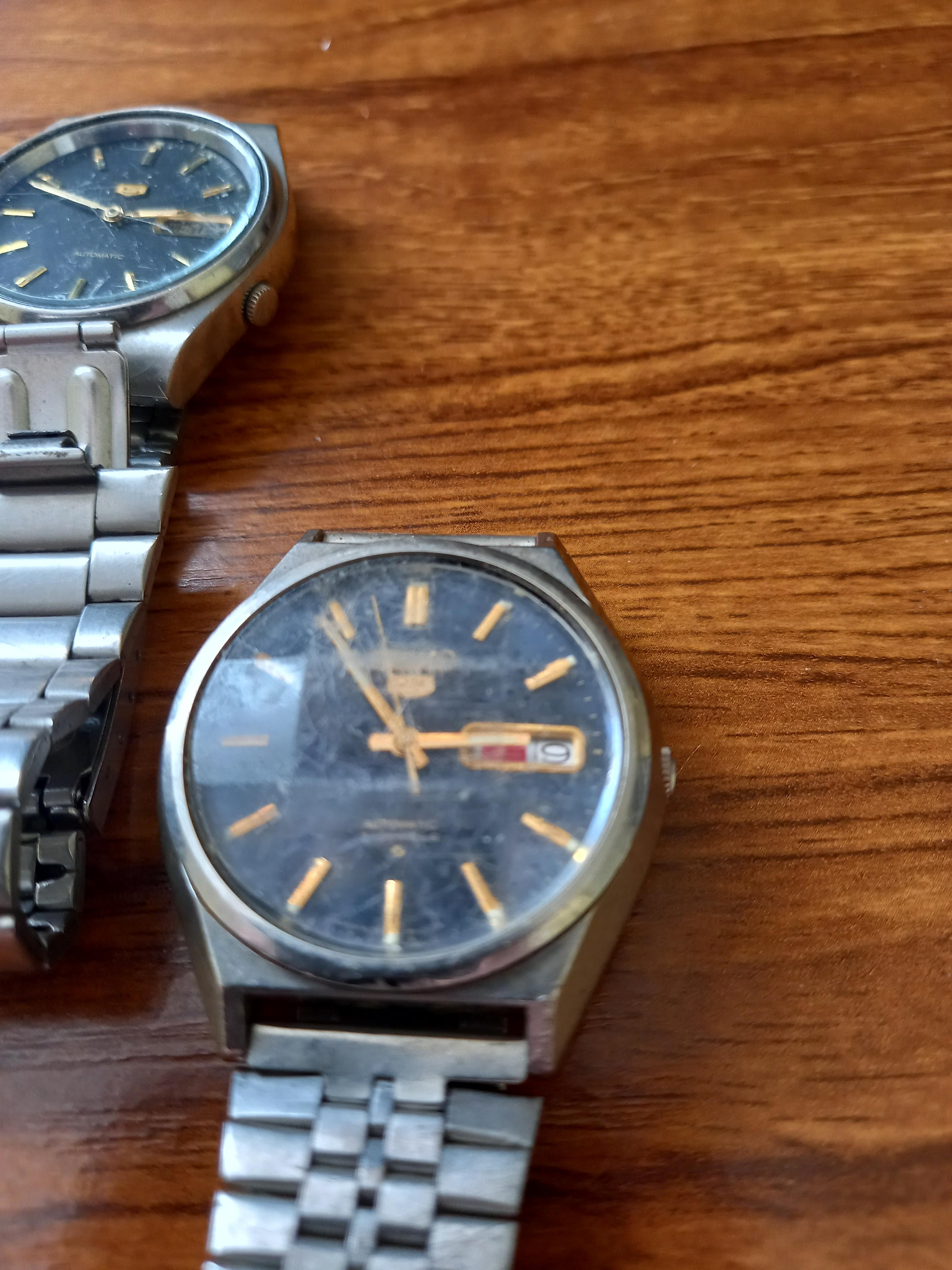

Not sure if I have called this properly. I purchased a set of Seiko watches to learn the art. Cleaning the white one at present.. I would like to show you the crystal of the black one. Never seen one before. I will obviously have to replace as it is just so badly scratched. Just thought I would show you all.
Regards
Ross
yes the faceted crystal I've seen one sometime in the past I might've even replaced one I just can't remember anymore. Crystals did not just come in flat glass sometimes they had interesting features.
You could just refinish the crystal to remove most of not all the scratches.  I did it on one of my Seiko 5's that was badly scratched but couldn't be replaced as it had a ring of numbers applied to the back of the crystal and a replacement was no longer available, I tried a standard crystal without the numbers but it looked wrong, so improving the existing one was a necessity.
It was not too hard. Just the usual decreasing grades of wet and dry paper, going from 240 down to 1200, then it was polished to a nice gloss with some polishing compound and a felt wheel on a Dremel type tool, took less than an hour and looked as good as new when finished.
Obviously just a simple crystal replacement is easier but it might be worth doing just because you could.

Basically you have to pretend your new hobby is lapidary because this is basically a form of glass. Then some of the scratches looked pretty deep. See may not build take them out 100% usually the crystals are relatively thick that are glass. My favorite used to be people who did arc welding because little balls of flying whatever would hit the glass actually burn into the glass. Fortunately those were the days we could get new crystals easily.
It depends how deep the scratches are and how hard the glass is. I have a Citizen Crystal 7 which had a badly scratched glass, and I couldn't find a replacement. The glass was very hard, Wet and dry barely scratched it. I used a diamond knife-sharpening stone and then diamond paste on a Dremel. Took a while, but did the job.

yes it's definitely not your normal glass. because normal glass crystals can be polished relatively easy these always just seemed much much harder. But fortunately they're still soft enough you can still polish them a few really careful and diamond grinding compounds are readily available is necessary.

Maybe diminishing grades of diamond paste on a sheet of plate glass could work. The crystal suckered onto a shaft and spun ?
