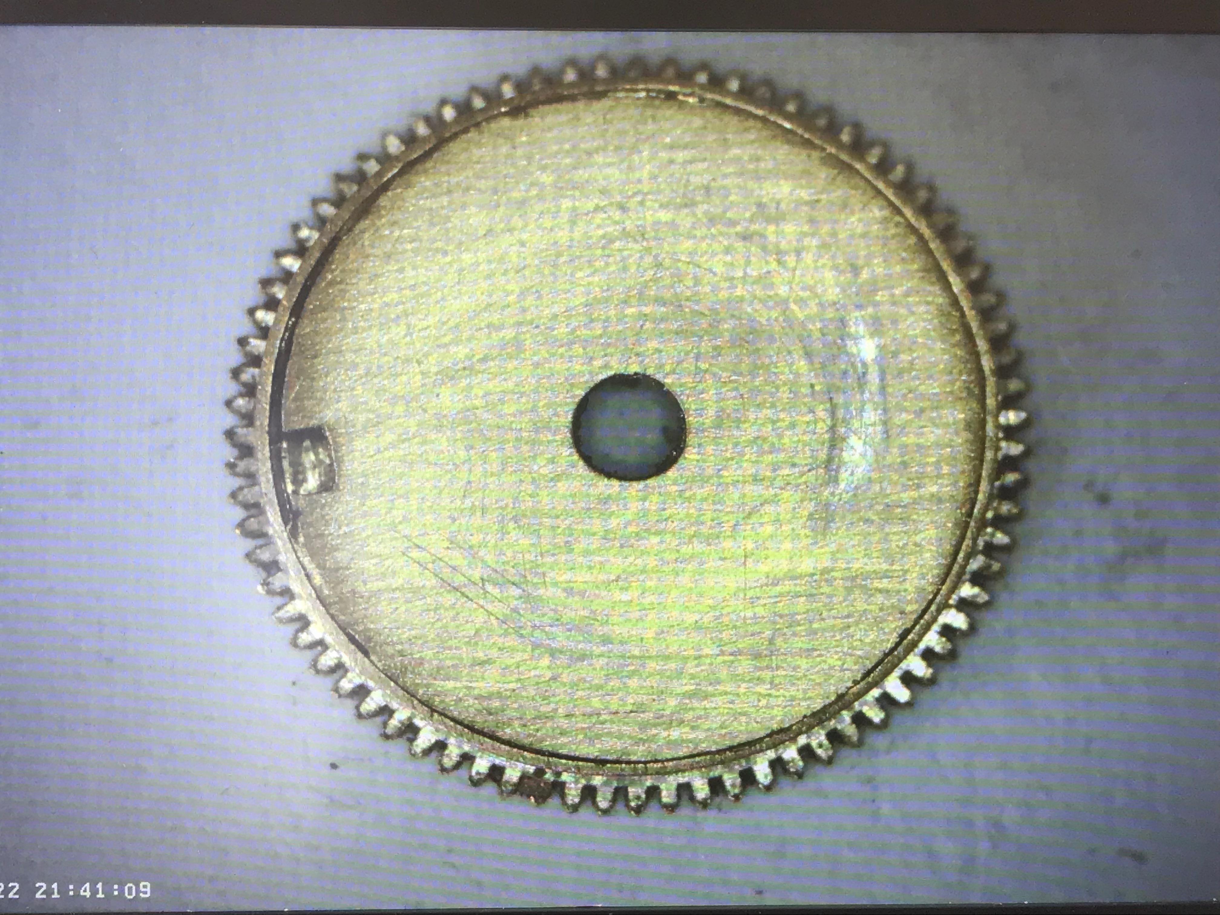

Next question I have on this watch. The barrel itself has a loose lid. The lid has some friction with the arbor - which I assume needs to be freed? but does not click into place but simply sits there?
I assume that the friction on the arbor will reduce the power? Is the lid itself a problem? and if so is there a way to tighten it so it clicks into the barrel? ... or can it simply sit there?
Presumably finding a replacement barrel would be difficult given we don't have an idea as to the movement?
Actually ... looking closely it appears that the outside coil of the spring is sitting slightly higher than the rest of the coil preventing the lid from seating ... when I remove the coil the lid clicks into place - a tad loose perhaps but it does click in.

Put some pictures  up of the barrel and parts matey.

The lid is usually a reasonable tight fit . Unless the barrel is the type with the rachet attached to the mainspring and the arbor just floats. Photos tell the story more than words in most cases.

I know ... but in this case it is pretty beat up and touches where it fits! It does click in ... sort of .... but not well and there are gaps around as you can see.
If it sits in and holds ... then presumably so long as there isn't undue movement between the arbour and the barrel bridge is there any reason there would be a problem? Or does the lid stop the barrel moving on the arbor?
Expand
Ok. I think someone might have reduced its diameter if they thought it was too tight to close back up. How easily did it come off?  Does it fit any better in a different  area ? What about making a lid ?
Expand
Yes mate the barrel wall  looks quite distorted. Over enthusiastic beginner ? Ham-fisted amateur?  Who knows. What sort of value watch we looking at any idea ?
