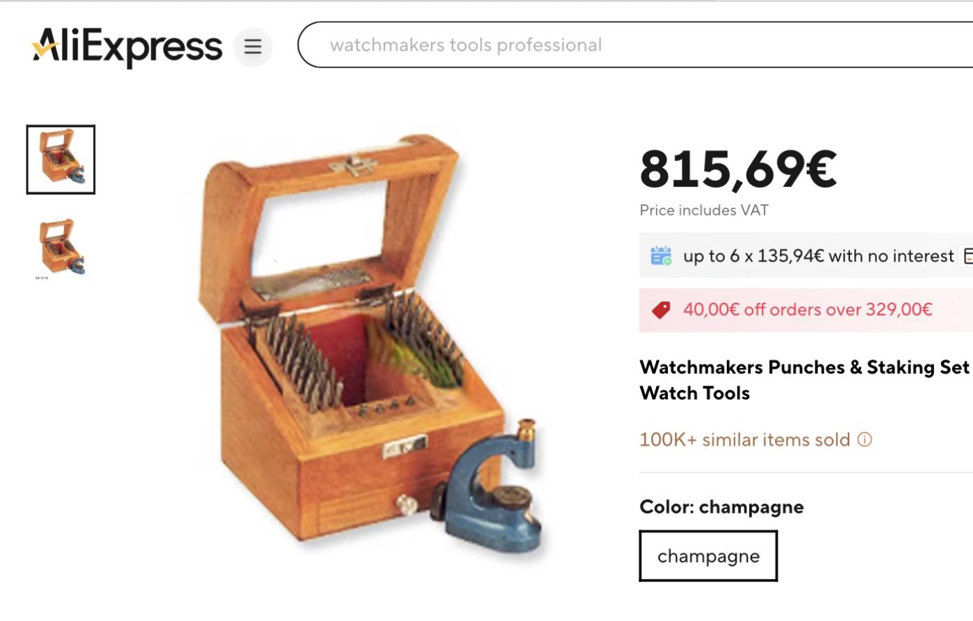

  On 2/12/2025 at 7:53 AM, Kalanag said:
This should be a quality staking set from China. The price is comparable to that of Cousins‘s „value“ version (made in India).
Expand
I am from India and have seen both of these in person. The Indian version looks like a miniature in front of the Chinese and you would be better off betting on the Chinese for this one. Also, the Indian set costs around USD 130 here and has and odd diameter for the punches.
The tolerances and quality of the Kwong yuen set seem top notch, will post an update once my watchmaker uses that for a while.

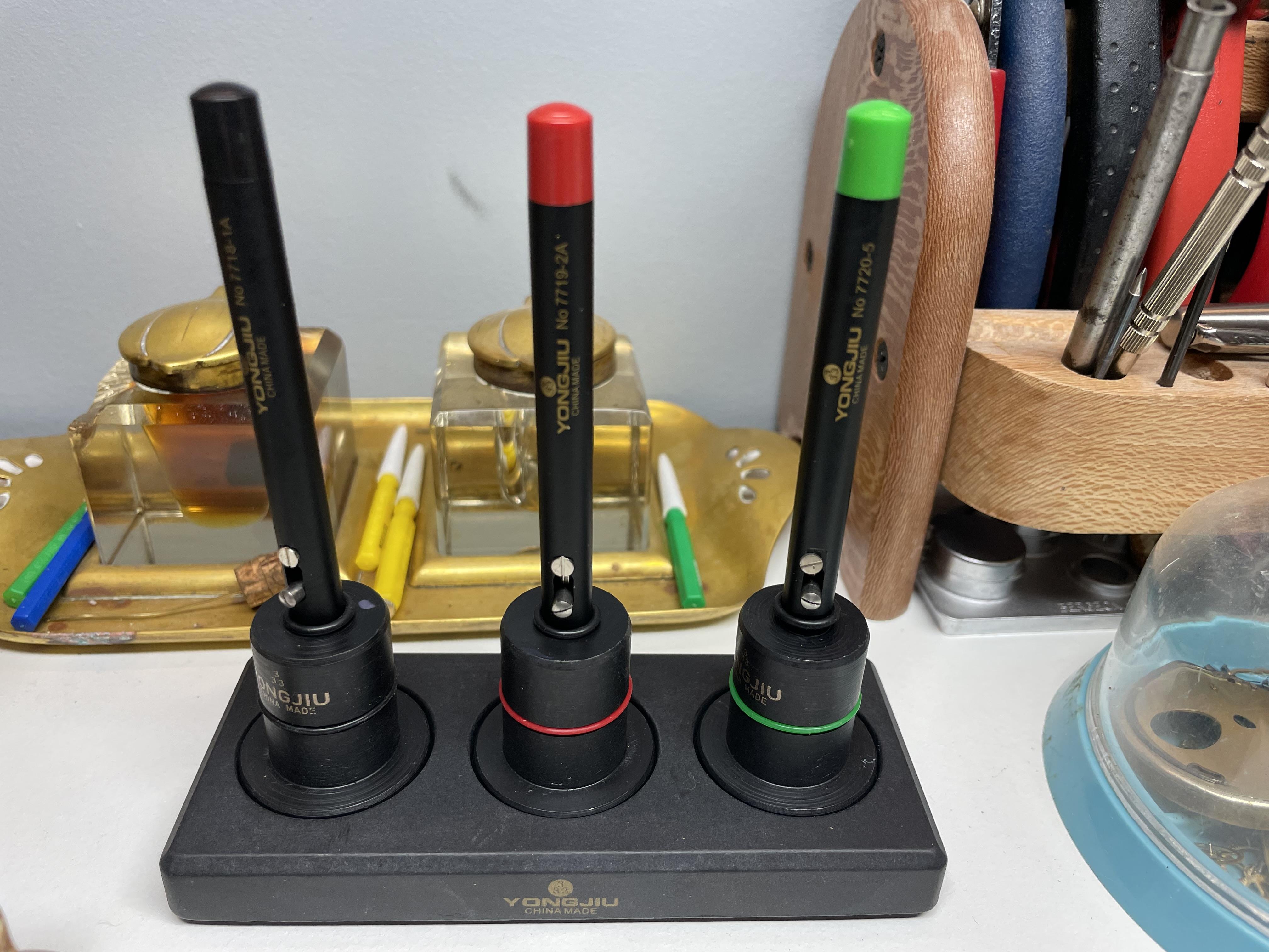

After using my old Bergeon auto oilers I thought I’d upgrade to a new/spare set.
So a quick hunt on Ali and I bought a single auto oiler £16 to see the quality.
Well it’s perfect and measured against a gen Bergeon it’s exact, even the Bergeon needles fit and visa versa.
So I plumbed to by a whole set including base, £72 including postage and under two weeks to arrive.
there are many on Ali, I just went with most sold with highest reviews.
Expand
Which one is equivalent to the Bergeon 1A for cap jewels?
EDIT: I think I can just make out the '1A' on the black one.
Edited by GuyMontag
I got one a few months ago and the needle doesn't fit into the hole in the chaton jewels. My understanding from reading Mark W. Wiles is that it should. I've seen other posts with a similar problem as one mentioned sharpening the tip of the oiling needle, which I have tried.
I also bought mine, at the time, from the one with the most sales and most positive reviews. This post isn't to say that they're all bad, just that they're not all good. As the saying goes: your mileage may vary.
Edited by JohnL
spelling
I have two of these, the red and the black one and not had any issues using them, I did though a misshap damage the needle on the black one and just replaced it with a Bargeon needle, as it was actually cheaper than getting the Chinese needle shipped over.
Never thought I would ever write that. 😉

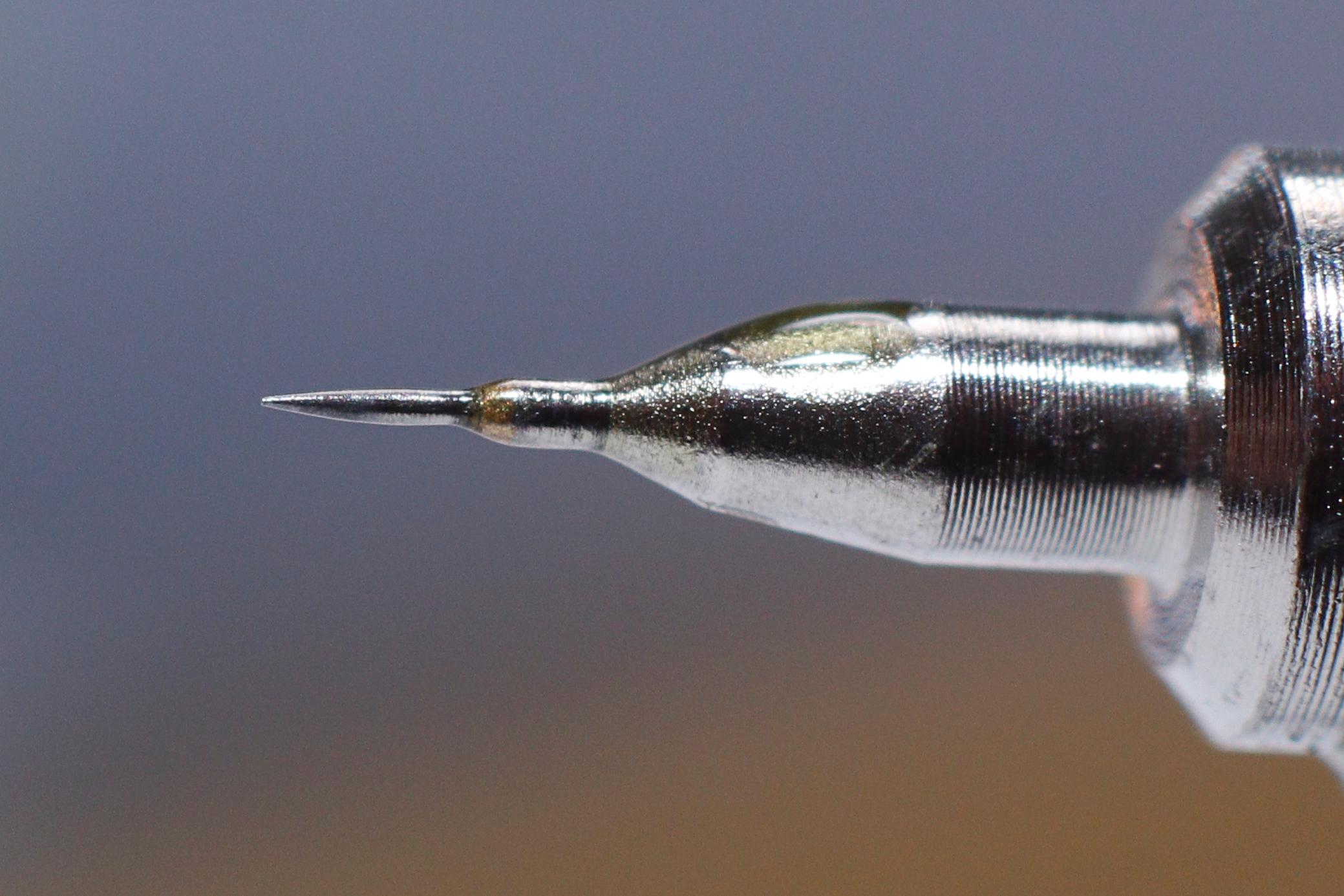

Just to show the sharpening of the needle and the rounding of the edge on the needle 'sheath' ? Not sure if it's an appropriate term or not. The needle now seems to fit in the jewel holes.
Apologies for the oil still there, just took some quick shots during lunch.

How did you sharpen it? Did you have to remove the tip from the holder?
Expand
Sorry, I meant to mention that, but I was on lunch and had to log back into work. 1200 and 2000 grit held on a staking block. The needle kept at a very shallow angle on the paper, gently rotating the oiler unit while moving back and fort across the paper. Cleaning (because it get's pretty dirty) in rodico to see the progress.
It may not be necessary, it may be the holes in the jewels I've been working on are for fragile pivots. I believe some balance pivots are stronger than others, but whether an actual Bergeon auto-oiler fits all, and whether the needle on the one from Ali is slightly thicker, I don't know. If I was a betting man I'd suspect the Bergeon needle is a stronger material and consequently thinner but 🤷‍♂️
