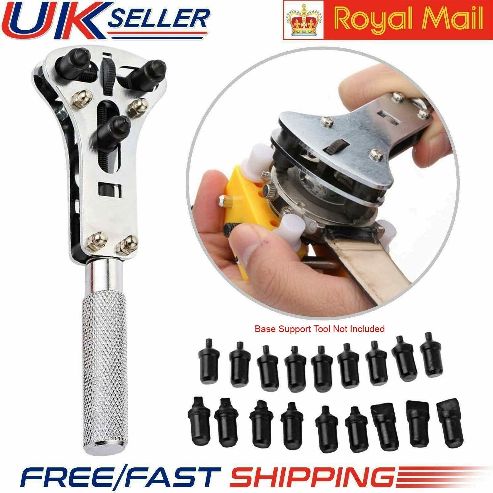

Here is a sample  of back removers ,whether it is screwed on or a snap on back a combination the one s-1600  and the jaxa copy on the far right will remove most backs.the yellow handle and case knife  for span on's.   The movement holder of the type shown will enable a good hold on the case whilst undoing the watch there are others to be had . Look up watch tools on Ebay or Visit cousins uk  watch meterial house and look under tools.     cheers

I have this very watch on my bench...belongs to my neighbor.  If you ever decide to open it, I suggest the three-prong back wrench because it gives more control than the two-prong one and typically this back is on pretty tight since it is a 300M diver.

I have just ordered a three prong back opener before reading your post Thanks for the great advice
