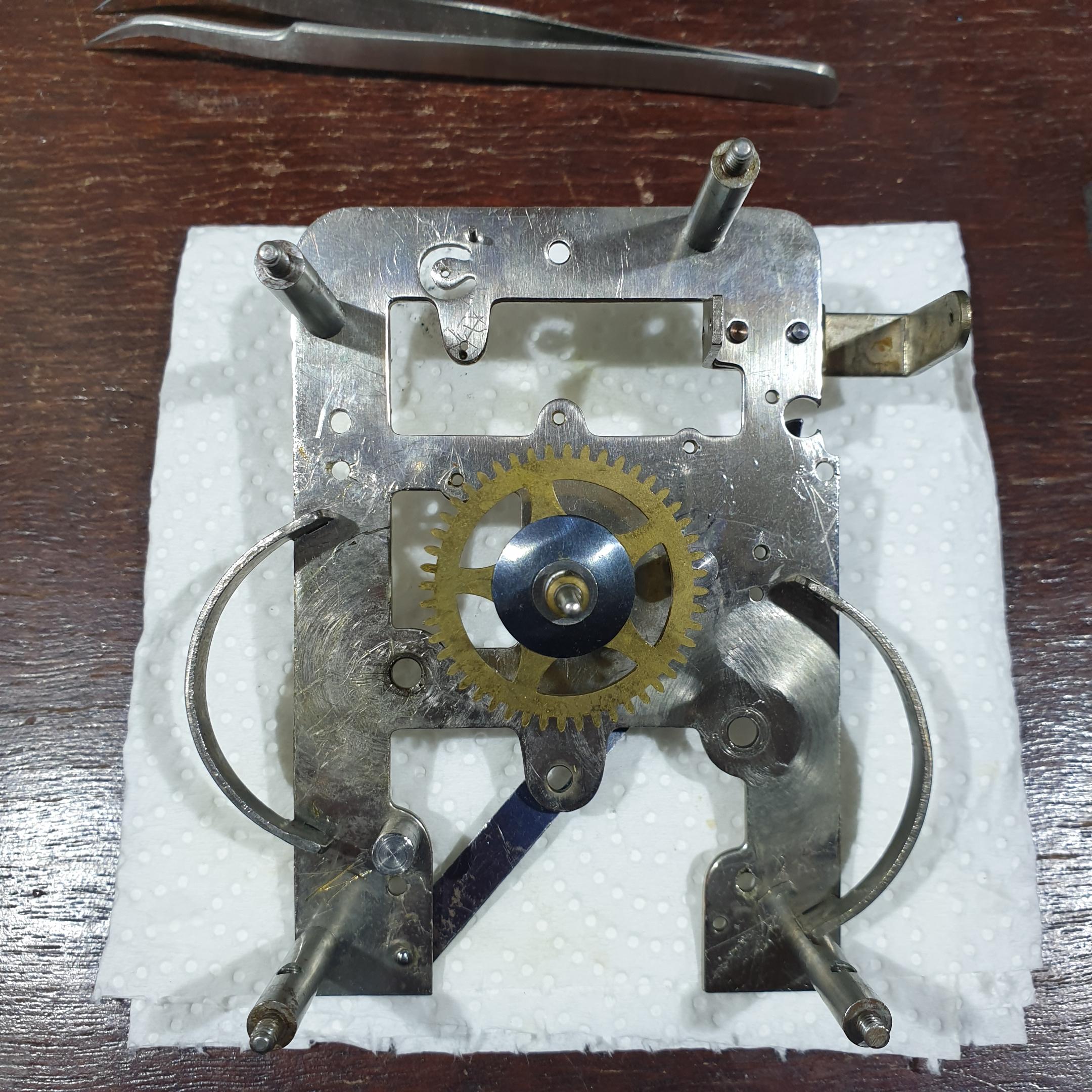

Anyway, I found that some clockmaker had gotten into this clock before me. The plates are very scratched up inside and two holes have punch marks around them.
I also took some photos of the escapement this morning.
Punch holes are very common in clocks considering this might be a replacement movement, at least it is showing some kind of wear and its all part of its history.

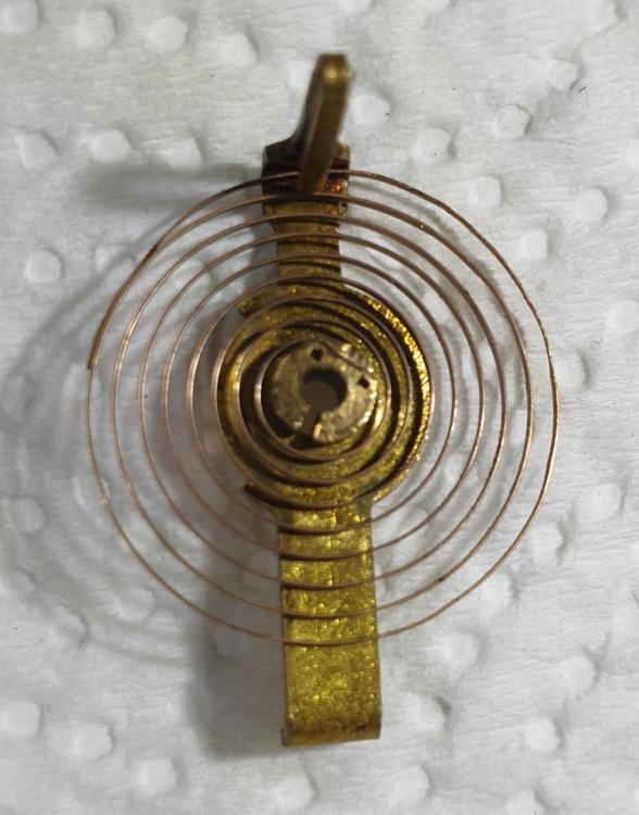

I spent last night trying to form the endcurve of the hairspring but found it impossible. I came to the conclusion that either the hairspring or the regulator is not original.
There is no evidence of any previous endcurve on this hairspring and when the hairspring is placed on top of the regulator, it looks too big for it. There is no room to open up the last loop for the hairspring to breath. The 2nd loop keeps banging into the regulator.
As this is not the original hairspring, I don't even know if the length and strength is correct. I think I'll fit the hairspring back on the balance without the regulator and let it run for 24 hours and see if it will even work for this clock.
I don't think the regulator is a problem and I'm sure it is original to that movement, the brass colour is the same as the wheels. Pin the H/S about half an inch in and test, when pinned you can see how close it is to rubbing the regulator and you should be able to bend it away. This is going to be one of those trial and error repairs, only then will you be able to tell if it is the correct H/S
